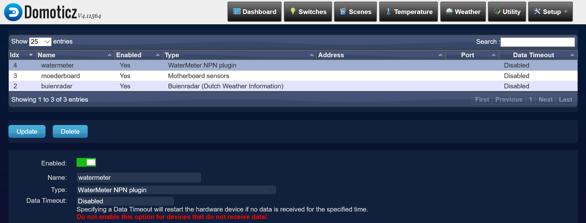

Ok, hardware can be found now in the list. But after the add and the message, device added, there is NO new device!
Any idea?
Any idea?

is "Accept New Hardware Devices" enabled in the settings of Domoticz?JeeGee wrote: Wednesday 18 December 2019 22:16 Ok, hardware can be found now in the list. But after the add and the message, device added, there is NO new device!
Any idea?

Yes. Earlier I added my smart meter, so that should work.
I see the hardware is added to the list, but no new device

Installed buienrader, works 100%.
2. Did you already try to make the plugin.py exeutable (chmod +x plugin.py)
Yes, did that the very first time.
3. Did you check if you have this issue? https://www.domoticz.com/wiki/Linux#Pro ... ing_Python
Well not page, but via wiki, I found the issue about installing the dev stuff.
4. Did you check the troubleshooting section in the domoticz wiki for plugins ? (https://www.domoticz.com/wiki/Using_Python_plugins)
Yes, that where the dev is mentioned.
Looking at the logs:
2019-12-19 19:58:48.456 Error: (WMPS) failed to load 'plugin.py', Python Path used was '/home/pi/domoticz/plugins/domoticz-watermeter/:/usr/lib/python35.zip:/usr/lib/python3.5:/usr/lib/python3.5/plat-arm-linux-gnueabihf:/usr/lib/python3.5/lib-dynload:/usr/local/lib/python3.5/dist-packages:/usr/lib/python3/dist-packages:/usr/lib/python3.5/dist-packages'.
2019-12-19 19:58:48.456 Error: (Watermeter) Module Import failed, exception: 'ImportError'
2019-12-19 19:58:48.456 Error: (Watermeter) Module Import failed: ' Name: RPi'
2019-12-19 19:58:48.457 Error: (Watermeter) Error Line details not available.
2019-12-19 19:59:54.925 Error: Watermeter hardware (5) thread seems to have ended unexpectedly
To me it looks like in import error with RPi, but why?

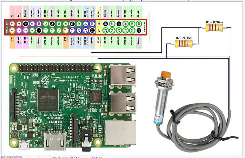

Hmmm I connected my NPN as the scheme above. Took 3 resistors (1k), as you need 2k, I soldered them after each other to make it 2k.
Connected it to my Pi 3 model b at the pins shown above. But it doesn't count. If I use metal in front of the NPN I see the led turing on.
I ordered one from Ali: LJ12A3-4-Z/BX
Could it be because og the way connected at the moment or do I need an other NPN?
Are there commandline options to see if there is data on GPIO21?
