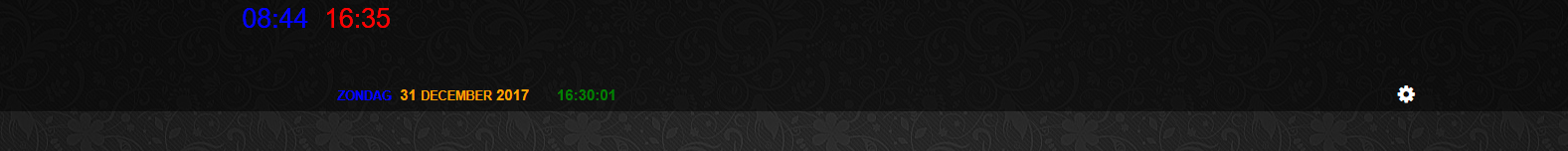

Dear All
Finally i do have my tablet working.. [ stable ]
13 inch portret :-)
Some hard to get settings problems for me...
I wil have the topbar customized.
Now i see smal icons and tekst..
I hope there is someone that can help me with th options.
I try the make the topbar in 1 line.:
logo, icon sunrise, time sunrise, icon sunset, time sunset, day, date, month,year [ i hope weak number ], time, settings. [ and all to resize ]
This is what i get grrr:
With this settings [ sorry i cannot better ]
.wi.wi-sunrise	 { font-size: 18pt !important; color: green; margin-left: 35px !important;}
.wi.wi-sunset	 { font-size: 18pt !important; color: blue; }
.sunrise	{ font-size: 20pt !important;  color: blue; margin-left: 35px; }
.sunset		{ font-size: 20pt !important; color: red; }
Edit [ this is also for the topbar i think? :
.weekday 	{  margin-centre: 0x; font-size: 100px; color: blue; font-weight: bold; font-variant: small-caps;}
.clock   	{  margin-left: 5px; font-size: 80px; color: green; font-weight: bold; font-variant: small-caps;}
.date	 	{  margin-left: 5px; font-size: 50px; color: orange; font-weight: bold; font-variant: small-caps;}
I now i make a piece of shit....
Only. perhaps there a masters to help me.
Thanks!!! [ Rob also for the great work !!]
