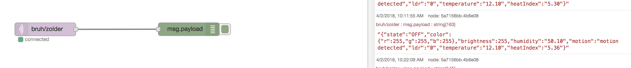

Hi everyone, semi-beginner here.
Is have a nodemcu sensor that sends Temp & Hum via MQTT. I can read the data in Node-red. Output example:
I used the example by Bruh Automation: https://github.com/bruhautomation/ESP-M ... ultisensor. He is using more sensors but I only need Temp & Humidity at the moment.
Everything is setup and running: Domoticz / MQTT / Node-red / nodemcu.
How do I get the sensor data into Domoticz? I want to be able to read the TEMP & HUM in Domoticz. When I simply add a output MQTT using domoticz/in the log in Domoticz says the MQTT data is invalid. I am guessing I need to do something with the msg.payload and maybe convert it via the function node? But this is where my skills end for now.
After it is sent to Domoticz I think I know how to create Dummy sensors etc.
Can you please help me out? Thanks a lot
{"state":"OFF","color":{"r":255,"g":255,"b":255},"brightness":255,"humidity":"49.70","motion":"motion detected","ldr":"0","temperature":"12.10","heatIndex":"5.35"}
- Screen Shot 2018-04-02 at 11.29.19.png (91 KiB) Viewed 4338 times
Re: [90] MQTT Support
@GCB2016
Maybe this little tutorial can help. It's probably not the best or most efficient solution, but it works for me.
First, your msg.payload needs to be converted into a json object. Put a json block between the mqtt node and the debug node like this:
Then look at the result in the debug window. I'll show the result of one of my temp sensors. It's looks like this:
You can then use the names to get a particular value. Make a change in the debug node by adding the name of the value you want. In my case I use svalue1 as it holds the temperature:
The next time the sensor sends its data, the debug window shows:
Create a dummy temp sensor in Domoticz and look for the idx. I created one and the devices tab shows:
Now I have to create a msg.payload that is understood by Domoticz. There are some examples in the wiki. I create a function node where I construct the message as follows:
You see that I can use the msg.payload.svalue1 from the input message and use it in a new to build msg.payload. And the idx of the dummy sensor is used. When you check the msg.payload with a debug node (remember to remove svalue1 if you use the original one) the new message looks like this:
Domoticz can't use this, it needs to be a json object, so we put another json block in between.
Now the output shows:
Domoticz can use this as an input message so feed this to the mqtt broker (to domoticz/in). After an update of the sensor you'll see this in Domoticz log:
And it gave my virtual sensor an update:
I hope this info is of any help.

Hi mrf68, super thanks for your reply. I'll try it out and let you know how it went. Thanks again!
EDIT: My response disappeared... But: IT WORKS
Super happy with it. Thanks a lot!
