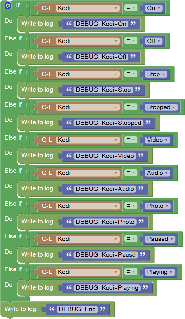

I have created a Blockly test event (Event Type = Device) for debugging purpose as follows: But the only log entries I get from it are:2017-11-19 01:44:07.301 Kodi: (mykodi) Event: 'Off'.
2017-11-19 01:44:07.819 Kodi: (mykodi) Disonnected.
For Kodi starting and video playback stops:
and Kodi shutdowns:EventSystem: Event triggered: KodiTest_1
DEBUG: Kodi=On
It seems Domoticz correctly receives Kodi changes of states but does not triggers Blockly events accordinglyEventSystem: Event triggered: KodiTest_2
DEBUG: Kodi=Off

I have the same issue since quite a while.CDuv wrote: ↑Sunday 19 November 2017 2:27 I confirm something is weird (at least to my understanding) about Kodi-triggered events support in Domoticz.
Here are the Kodi events as shown in the Domoticz Log page for various Kodi actions:
Kodi is starting:Starting video playback:2017-11-19 01:44:45.540 Kodi: (mykodi) Connected to 'kodi.example.lan:9090'.
2017-11-19 01:44:45.569 Kodi: (mykodi) Event: 'On'.Pausing video playback:2017-11-19 01:39:16.515 Kodi: (mykodi) Event: 'Video - Some TV Show [S4E2], Some title (1970)'.Resuming video playback:2017-11-19 01:39:36.051 Kodi: (mykodi) Event: 'Paused - Some TV Show [S4E2], Some title (1970)'.Video playback stops (manual stop or end of file):2017-11-19 01:39:49.961 Kodi: (mykodi) Event: 'Video - Some TV Show [S4E2], Some title (1970)'.Kodi shutdowns:2017-11-19 01:39:59.856 Kodi: (mykodi) Event: 'On'.I have created a Blockly test event (Event Type = Device) for debugging purpose as follows:2017-11-19 01:44:07.301 Kodi: (mykodi) Event: 'Off'.
For Kodi starting and video playback stops:and Kodi shutdowns:EventSystem: Event triggered: KodiTest_1
DEBUG: Kodi=OnIt seems Domoticz correctly receives Kodi changes of states but does not triggers Blockly events accordinglyEventSystem: Event triggered: KodiTest_2
DEBUG: Kodi=Off

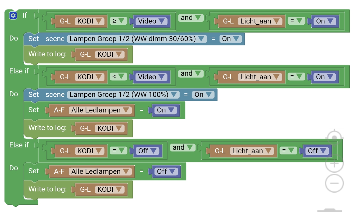

One way it is partially solved is by looking at the statusses in alphabetic order.
Meaning status Paused is smaller then Video (P comes before V) etc etc
When a video plays the status is not just Video. The status when playing a video is more like "Video - Armagedon"
So anything greater than "Video" means its playing something at least.
The following blocky works for me: In other words I can confirm having the same issue, which I actually believe is a bug. It should be fixed, but my workaround solves it partially.
