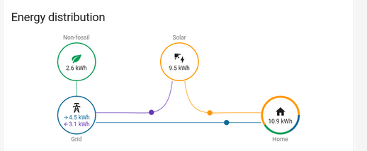

A lot of people prefer Home Assistant and the have an Energy dashboard, as well.
It looks like:
It looks like:

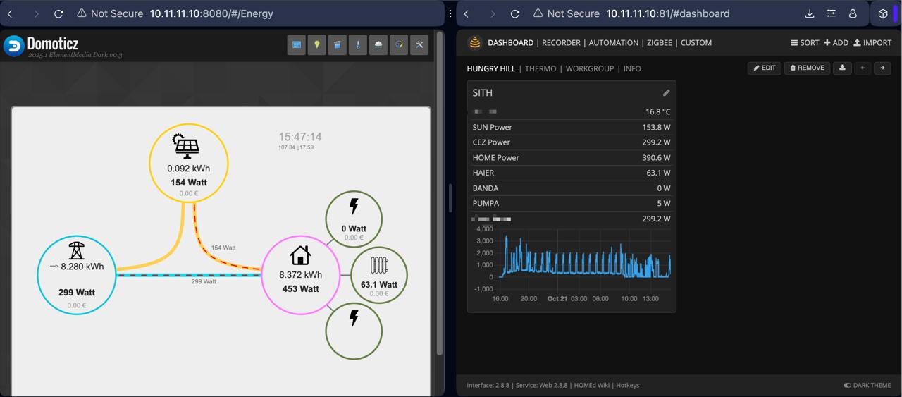

In general, it was a joke with a hint of criticism. I only use Domotics as a dashboard, and I like its graphics. My main smart home system is the free and highly professional HOMEd system from a programmer who is a C++ genius. Therefore, I have a choice among free programs.
I hope many people here understand humor and criticism.

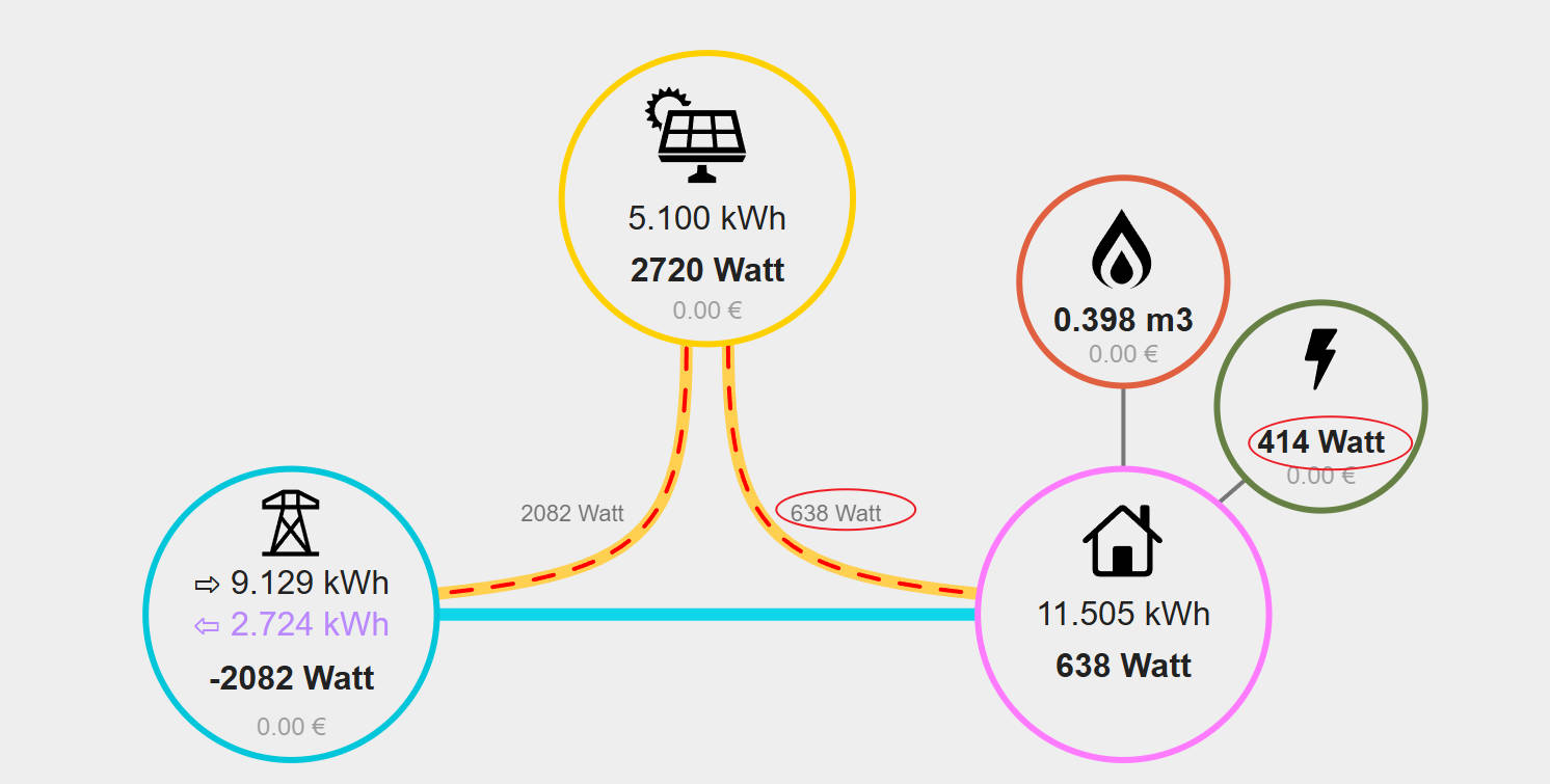

Morning all. Just getting started with the Engery Dashboard here.. See attached picture.
My "Usage L1+L2+L3" parameter shows a total usage of my devices of 414W, whilst the P1 meter shows a flow of 638W to my home.
Do I read things wrong? Who can enlighten me?
Thanks in advance!
BR,
Marc
Thanks in advance!
BR,
Marc

Indeed probably a timing issue. The P1 meter shows -2082 Watt, the sun generates 2720 Watt, so then the dashboard calculated there is a usage in the house of 638 Watt.
Is L1+2+3 also coming directly from the P1 meter or is it measuring something else? If coming directly from the P1 meter is is a little bit strange it is so different.

@waltervl Yes, L1+L2+L3 also comes from the P1 meter indeed. That's why it confused me. But like imautohuttraeger mentioned, it's probably a timing issue. Thanks for thinking with me.
