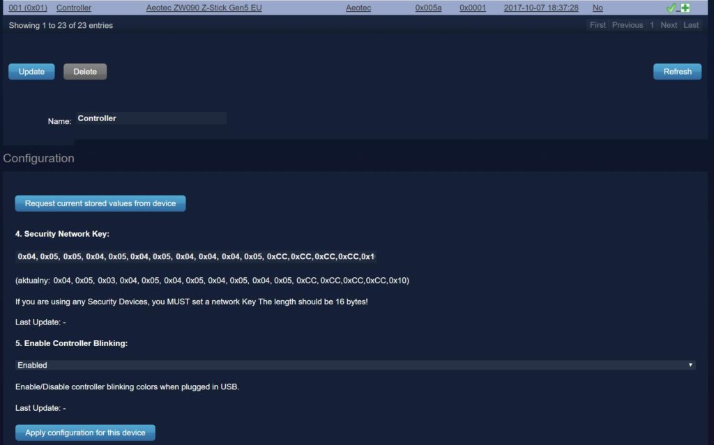

sincze
Posts: 1302
Domoticz version: 2024.4
Re: Easiest way to migrate Openzwave to ZWave-JS-UI
Post by sincze »
meal wrote: Friday 29 September 2023 11:06
1 - AEOTEC devices compatibility
- ZW090 Z-Stick Gen5 EU
Are they compatible with zwave JS UI ?

I am preparing the migration from OpenZwave to Z-Wave JS UI and am using the tutorial from 09 June 2023 as a basis.
@d3smo - many thanks for this. Is it still up to date or are there any updates?
I have an installation with about 50 nodes. But I will only start the adventure with a test environment.
Now I have to realise that I am already stuck with the first task: "Backup security Network Key" Where do I find the key, or are there several keys, one per node?
Used Z-Wave devices: EUR_SPIRITZ, FGBS001, FGR223, FGS223, FGBS222, ZMNHYD1 Smart Plug 16A, ZWA009 AërQ Sensor, NAS-WR01Z Power plug 12A, ZME_WALLC-S, FGD212, ST812 Flood Detector, PAN04-1 Double Relay Switch, ZMNHND1 Flush 1D relay, ZME_UZB1 USB Stick

Same question here. It is not clear or obvious to me what is meant by security key and where to find it.
Posts: 6677
Domoticz version: 2025.1
It is set in the Hardware click on the Setup on the ZWAVE Hardware item ... then you click on the ZWAVE Controller device and scroll down to the details where you will find "4. Security Network Key:" defined.
