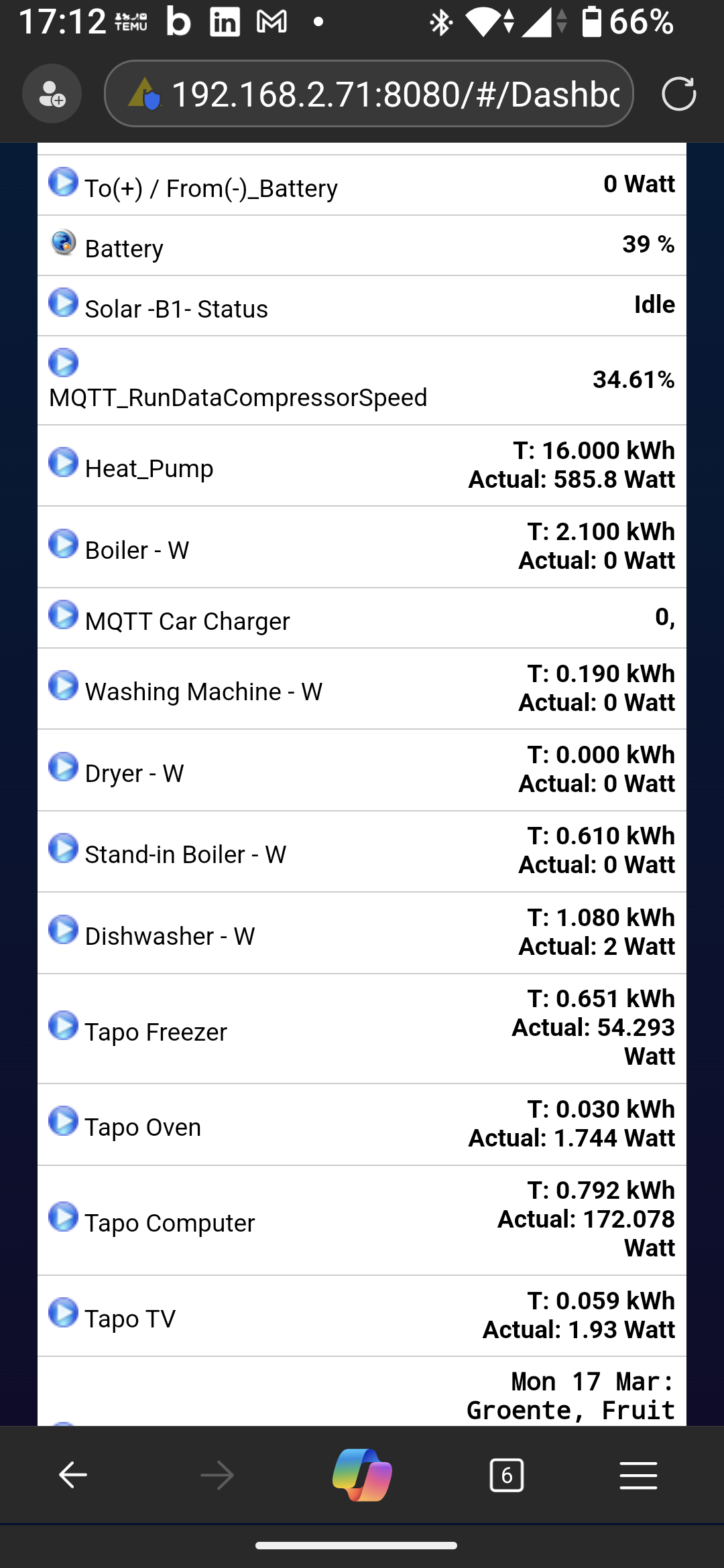

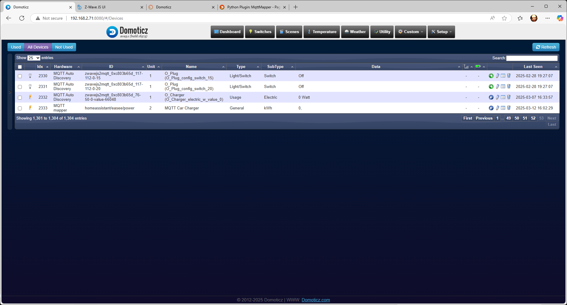

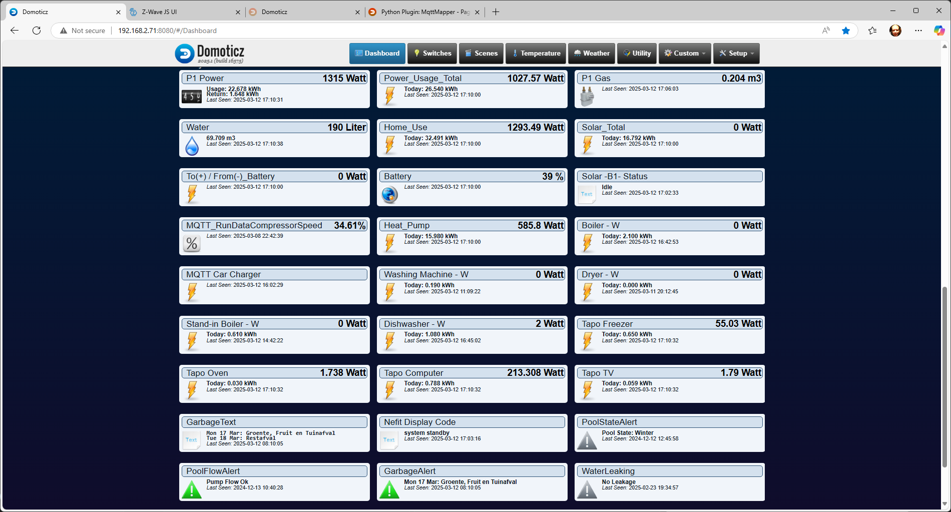

I checked on the phone and it displays the values! So my screen on the PC doesn't, i have no idea why not? An error is domoticz?
Screenshot 2025-03-12 171046.png (230.52 KiB) Viewed 5059 times
Screenshot 2025-03-12 171006.png (175.04 KiB) Viewed 5059 times

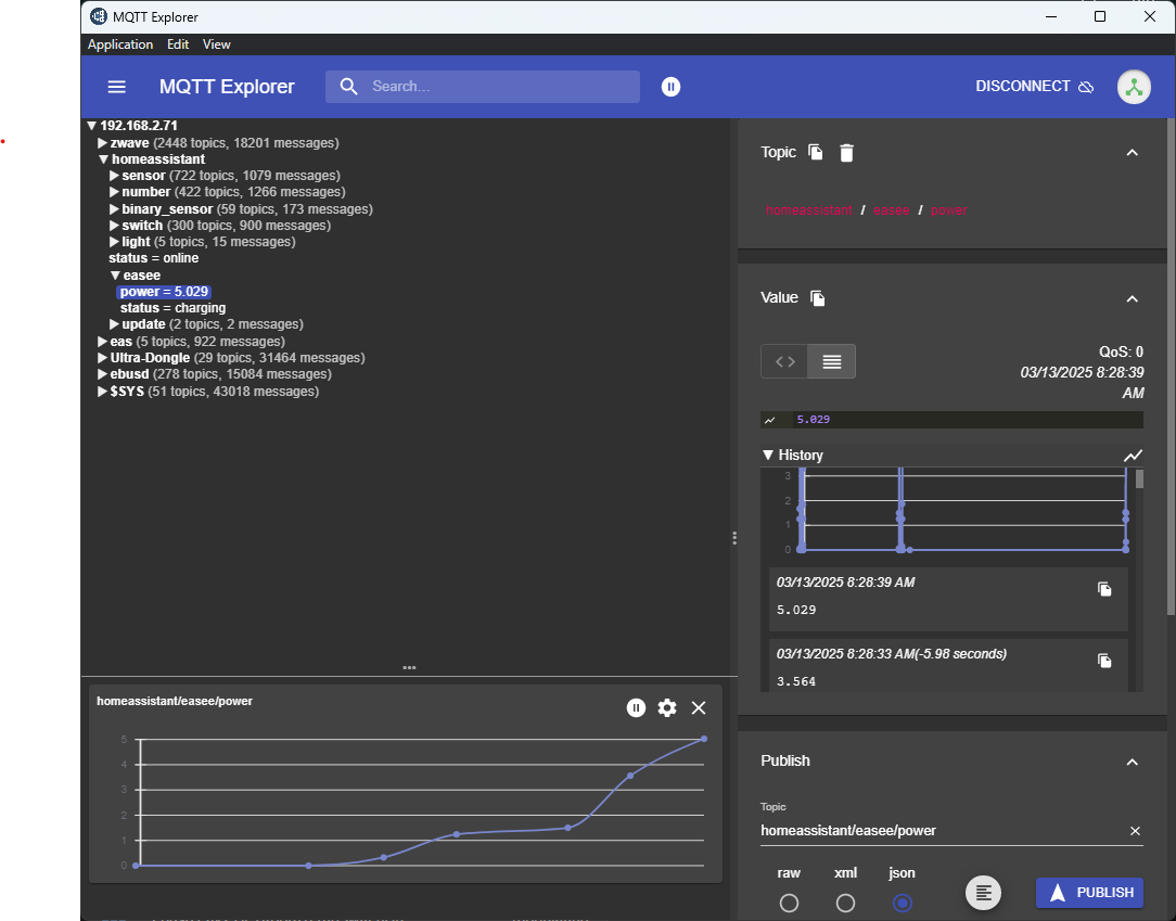

I really need to get the payload you inject into MqttMapper, as I more blond than less..
What I suspect is an illegal content (maybe a float with a "," instead of a ".").
hjzwiers
Posts: 309
Joined: Friday 12 January 2018 8:26
Re: Python Plugin: MqttMapper
Post by hjzwiers »
I added the automation code and a screenschot of MQTT Explorer, what else do you need?
By the way, the values are not read at the moment (with the same settings as yesterday)
"MQTTsignal": {
"topic": "homeassistant/easee/power",
"type": "243", "subtype": "29", "switchtype": "0",
"mapping": {"item": "~*;~0","multiplier": 1000}

- data:
topic: homeassistant/easee/power
payload: "{{ states('sensor.ehr28hyj_power') | float | round(3) }}"
action: mqtt.publish
- data:
topic: homeassistant/easee/status
payload: "{{ states('sensor.ehr28hyj_status') }}"
mode: single
Screenshot 2025-03-13 083014.png (100.32 KiB) Viewed 4896 times
FlyingDomotic
Posts: 475
Post by FlyingDomotic »
Thanks for that!
I'm still thinking that publishing this kind of data in homeassistant sub-topics will lead to problems at some time, but do as you wish. In all cases, this as no effects on MqttMapper...
Concerning payload, float value seems to be the right one, with a decimal point (and not a comma as suspected).
Now, as we seems to got the right value in the right topic, let's see what's in Domoticz log regarding MqttMapper messages.
First, would it be possible to :
  • Delete MQTTsignal in domoticz (using "Setup/devices", finding MQTTsignal n the list, and clicking on the trash at the end of the line, then validating deletion?
  • Modify MqttMapper.json to add "options": {"EnergyMeterMode": "1" } line just after the "type" line?
  • Either restart Domoticz or the MqttMapper plug-in ("Setup" > "Hardware",select "MqttMapper" line, and click on "Modify" button without changing anything
  • Extract part of Domoticz log related to MqttMapper and put it here
