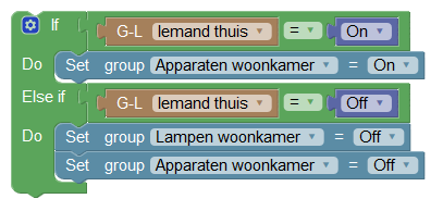

I'm trying to make a blocky, and it works but not the way i wanted.
I have made two, which should do the same;
The one that works:
Here are all switches seperate as you can see.
But what i want is working with groups:
This should do the same as the first picture, but when i set "Iemand thuis" to "off" then only the first group gets done, so in this case: "Lampen woonkamer" is set to off. But the second "Apparaten woonkamer" is not set to off.
Can someone tell me why this does not work and how i can fix it? Thanks!

Hallo RMU,
I also had the problem with switching off
Try it with a delay in the group
see the picture

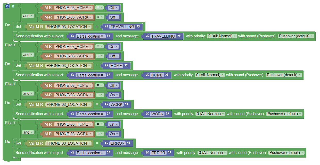

I've just installed my Domoticz server and was pretty impressed, so next step was to start implementing use cases.
I downloaded the Pilot app to enable geofencing on my phone which is linked to 2 dummy switches, one @Work and one for @Home.
For this I made some basic Blockly scipts where I experienced some strange behavior.
1. User variables do not seem to be updated inside the script itself
2. Nested if and else if statement do not deliver expected results
This script works:

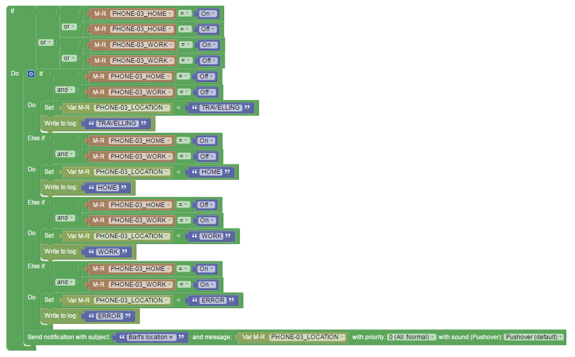

This one did not:
When updated this always returns ERROR, which is stange, looking at the log all nested if actions are executed.
Result in the log:
Does anyone have any tips/suggestions?
Should I switch to LUA scripting or does this have the same restrictions?
Many thanks for your input

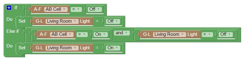

This is a simple script to turn off a light when my wife leaves and back on when she returns. This works fine except at the end of the day when we want to turn it off manually it comes right back on. I had thought that the script would only be triggered upon the cell phones' change of state but apparently not. Any advice would be appreciated.

by StanHD
If it helps, I would add a dummy Auto/Manual switch which is controlled with the built in timers. Then simply check the state of the switch in the blockly before carrying out the action.

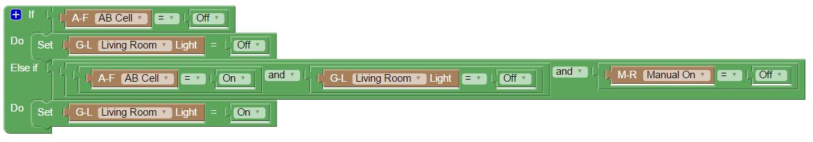

by rickybee
Thanks StanHD, as you suggested I created a 'Manual On' switch which is on between 9pm and 7am and added it to the script. Testing it now but I think it should work for what I need.

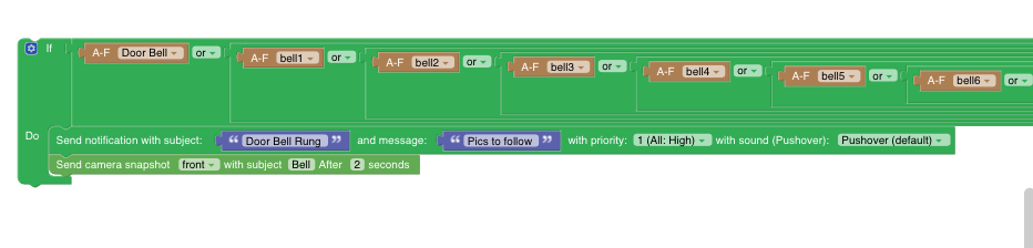

hello
i have an RFXCom doorbell that has multiple chimes, i captured each chime in domoticz nd created a bell for each and now i am trying to get a camera snapshot to send if any one of the bells is triggered (it seems to rotate each sound) so it could be one of the seven that chimes, this blockly does not seem to fire at all???
the end of the first line of the blockly is or bell7 = on
Re: Blockly examples
Posted: Wednesday 21 September 2016 9:26
by four2six
deejc wrote:this blockly does not seem to fire at all???
not sure i understood your 'capturing' correctly, but it lacks the 'logic'-part. It should be something like "if bell1='on' " or "if bell2='on' "... etc.

by deejc
Ok thanks I'll change it

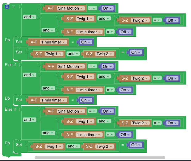

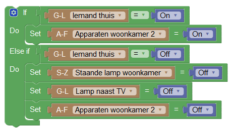

by deejc
another one i cant get to work, this one does nothing, nothing in the logs, the 1 minute timer doesn't fire.. i know the 3in1 motion is triggered…
twig 1 and twig 2 are leds on their own plugs, so just off and on, 3 in 1 motion is fibaro eye motion sensor which is working correctly, 1 min timer is taken from a previous post in this thread.
any ideas ?
Posted: Saturday 08 October 2016 0:45
by Domosapiens
AFAIK,
Set can not be combined with an AND statement.
Use 2x Set:
Set Twig1 =On
Set Twig2 =On

Posted: Saturday 08 October 2016 1:09
by deejc
Ah ha, thanks I'll try that
