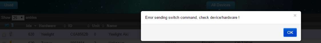

Facing an odd issue with the White Temp control slider
Yeelight works as expected but needed to add the ability to set the white temperature (default domoticz color picker chooses a very cool temperature)
I am using the following code
However, any attempt to use the slider yields the following error:
I am unfortunately not very familiar with Lua .. At no place in the code has DomValue been declared a string so what could be causing this?
Edit: The script is set as a Device Lua in event editor
