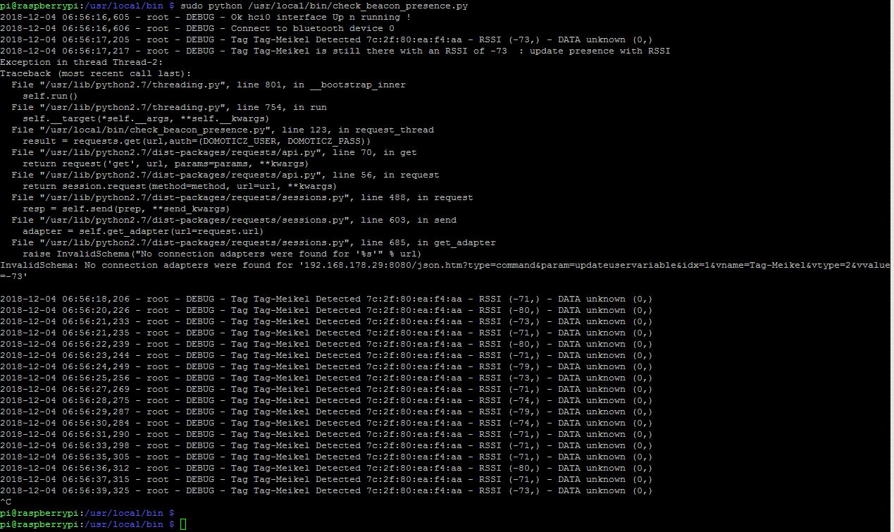

Hello, thanks for your answer. I have been on holidays since today.
I have been seeing that something in my Raspbian happens every hour, at hour:00 time. Then the script stops without exiting or anything:
2018-08-12 21:59:59,356 - root - DEBUG - Tag Tag_PasFco Detected c4:ab:d1:fd:87:55 - RSSI (-70,) - DATA unknown (85,)
2018-08-12 21:59:59,997 - root - DEBUG - Tag Tag_PasFco Detected c4:ab:d1:fd:87:55 - RSSI (-63,) - DATA unknown (85,)
2018-08-12 22:00:00,317 - root - DEBUG - Tag Tag_PasFco Detected c4:ab:d1:fd:87:55 - RSSI (-56,) - DATA unknown (85,)
2018-08-12 22:00:00,636 - root - DEBUG - Tag Tag_PasFco Detected c4:ab:d1:fd:87:55 - RSSI (-72,) - DATA unknown (85,)
2018-08-12 22:00:00,961 - root - DEBUG - Tag Tag_PasFco Detected c4:ab:d1:fd:87:55 - RSSI (-62,) - DATA unknown (85,)
2018-08-12 22:00:01,288 - root - DEBUG - Tag Tag_PasFco Detected c4:ab:d1:fd:87:55 - RSSI (-79,) - DATA unknown (85,)
2018-08-12 22:00:01,933 - root - DEBUG - Tag Tag_PasFco Detected c4:ab:d1:fd:87:55 - RSSI (-60,) - DATA unknown (85,)
2018-08-12 22:00:02,584 - root - DEBUG - Tag Tag_PasFco Detected c4:ab:d1:fd:87:55 - RSSI (-77,) - DATA unknown (85,)
2018-08-12 22:00:02,903 - root - DEBUG - Tag Tag_PasFco Detected c4:ab:d1:fd:87:55 - RSSI (-70,) - DATA unknown (85,)
2018-08-12 22:00:02,989 - root - DEBUG - Tag Tag_Mami Detected d6:19:04:59:11:d6 - RSSI (-81,) - DATA unknown (-42,)
2018-08-12 22:00:03,221 - root - DEBUG - Tag Tag_PasFco Detected c4:ab:d1:fd:87:55 - RSSI (-60,) - DATA unknown (85,)
2018-08-12 22:00:29,258 - root - WARNING - Tag Tag_Papi not seen since 34 sec => update absence
2018-08-12 22:00:29,273 - requests.packages.urllib3.connectionpool - DEBUG - Starting new HTTP connection (1): 192.168.1.125
2018-08-12 22:00:29,282 - requests.packages.urllib3.connectionpool - DEBUG - http://192.168.1.125:8090 "GET /json.htm?type=command&dparam=updateuservariable&idx=4&vname=Tag_Papi&vtype=2&vvalue=AWAY HTTP/1.1" 200 58
2018-08-12 22:00:29,289 - root - DEBUG - <Thread(Thread-13, started daemon 1969222768)> -> <Response [200]>
2018-08-12 22:00:34,263 - root - WARNING - Tag Tag_Mami not seen since 31 sec => update absence
2018-08-12 22:00:34,270 - requests.packages.urllib3.connectionpool - DEBUG - Starting new HTTP connection (1): 192.168.1.125
2018-08-12 22:00:34,270 - root - WARNING - Tag Tag_PasFco not seen since 31 sec => update absence
2018-08-12 22:00:34,281 - requests.packages.urllib3.connectionpool - DEBUG - Starting new HTTP connection (1): 192.168.1.125
2018-08-12 22:00:34,284 - requests.packages.urllib3.connectionpool - DEBUG - http://192.168.1.125:8090 "GET /json.htm?type=command&dparam=updateuservariable&idx=3&vname=Tag_Mami&vtype=2&vvalue=AWAY HTTP/1.1" 200 58
2018-08-12 22:00:34,289 - requests.packages.urllib3.connectionpool - DEBUG - http://192.168.1.125:8090 "GET /json.htm?type=command&dparam=updateuservariable&idx=7&vname=Tag_PasFco&vtype=2&vvalue=AWAY HTTP/1.1" 200 58
2018-08-12 22:00:34,290 - root - DEBUG - <Thread(Thread-14, started daemon 1969222768)> -> <Response [200]>
2018-08-12 22:00:34,294 - root - DEBUG - <Thread(Thread-15, started daemon 1958737008)> -> <Response [200]>
I can paste full log from the last start of the service, but I think that there is anything special, all normal. The last lines are the above, and since this Response 200, no more...

Post by Busmeikel »
Hi folks,
got the bluetooth beacon presence detection running with no success. System is a Pi3b with debian stretch and Domoticz 4.9700, beacon is a G-Tag which I can see with the lescan tool. Uservariable is set but no change from "away" to "home".
Errormeldung Neu bluez 5.9.JPG (231.8 KiB) Viewed 3802 times
Can somebody translate for me the output when I ran the script manually?
Thanks in advance.
Greetz
Meikel
Busmeikel

Script is working now, but...
Post by Busmeikel »
...its writing the RSSI into the user variable and not HOME or AWAY. Why?
