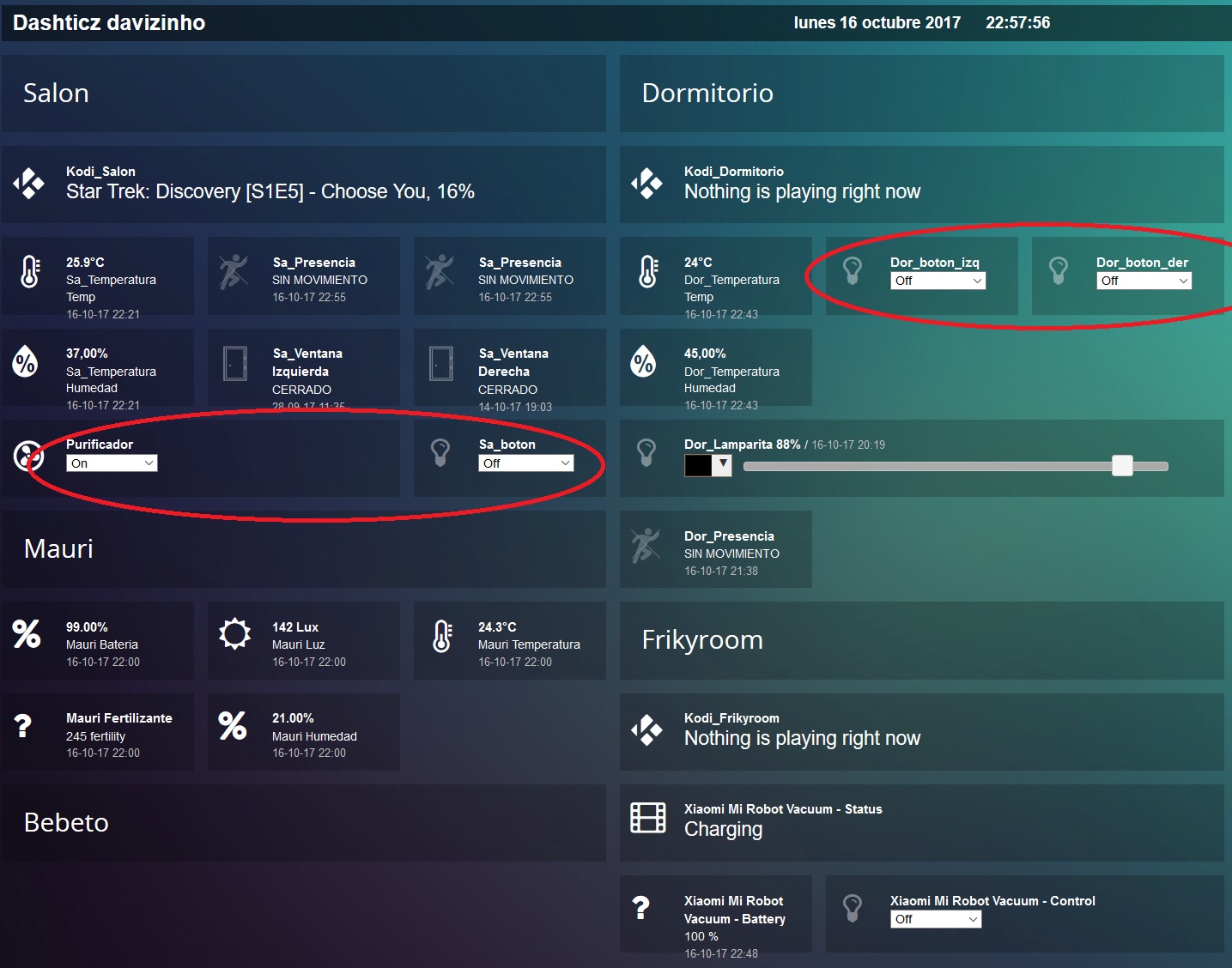

I think something like:
blocks[142]['title'] = 'Your Name';
blocks[142]['width'] = 6;
will do the job.
Where 142 should be replaced with your selector ID.

What I see in columns[8] that the device is the one with IDX 14
columns[8] = {} //DORMITORIO y FRIKYROOM
columns[8]['blocks'] = ['dormitorio',96,14,31,40,'15_2',38,6,'frikyroom',97,48,51,49]
columns[8]['width'] = 4;
But I can't see the block[14] defined in the blocks part....
I think you have to check the Wiki, because I see several 'strange' things.
The columns width added together can maximal be 12 and should always be 12!
The blocks width added together in a column can maximal be 12
Example:
- 3 columns on a screen -> width 4, 4, 4 or 2,6,4 or .... etc.
- 4 blocks in a column -> width 3, 3, 3, 3 or .... etc
So what I miss in your configuration is the block definition for block[14], for example:
blocks[4] = {}
blocks[4] ['width'] = 4;
blocks[4] ['title'] = 'Dor_Boton_Izq' --> can be anything you like, to overrule the Domoticz Title
See the other posibilties:
blocks[1] = {}
blocks[1]['width'] = 4; 			// 1 to 12, remove this line if you want to use the default (4)
blocks[1]['title'] = 'Living room' 		// if you want change the name of switch different then domoticz
blocks[1]['icon'] = 'fa-eye'; 			// if you want an other icon instead of the default, see: http://fontawesome.io/cheatsheet/
blocks[1]['image'] = 'bulb_off.png'; 		// if you want to show an image instead if icon, place image in img/ folder
blocks[1]['switch'] = true;			// if you want to switch title and data
blocks[1]['hide_data'] = true; 			// if you want to hide the data of this block
blocks[1]['show_lastupdate'] = true;		// show lastupdate time from device (per device)
blocks[1]['protected'] = true;			// make switch protected (no actions on push)
blocks[1]['playsound'] = 'sounds/sonar.mp3';	// play sound
Succes!

Great great! the problem in my case is that i not use the "blocks" part of the code, I put the idx of domotics in "force brute".
And you are right, im going to fast!, jajaja.
My english is so poor and i dont understand the use of "blocks". Wy i use the blocks if i put it directly?. now with your explications and the example of @CaesarPl i can see the results of apply the "blocks" config and i solve the problem
This is great!!!!
Now im very exciting with the posibilites, and i must check again my code.
Thanks a lot!!!!!
