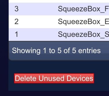

Re: Logitech Media Server
New in ihe latest bèta (9014):
Option to delete unused device from the nodelist in the hardware-setup of LMS.
