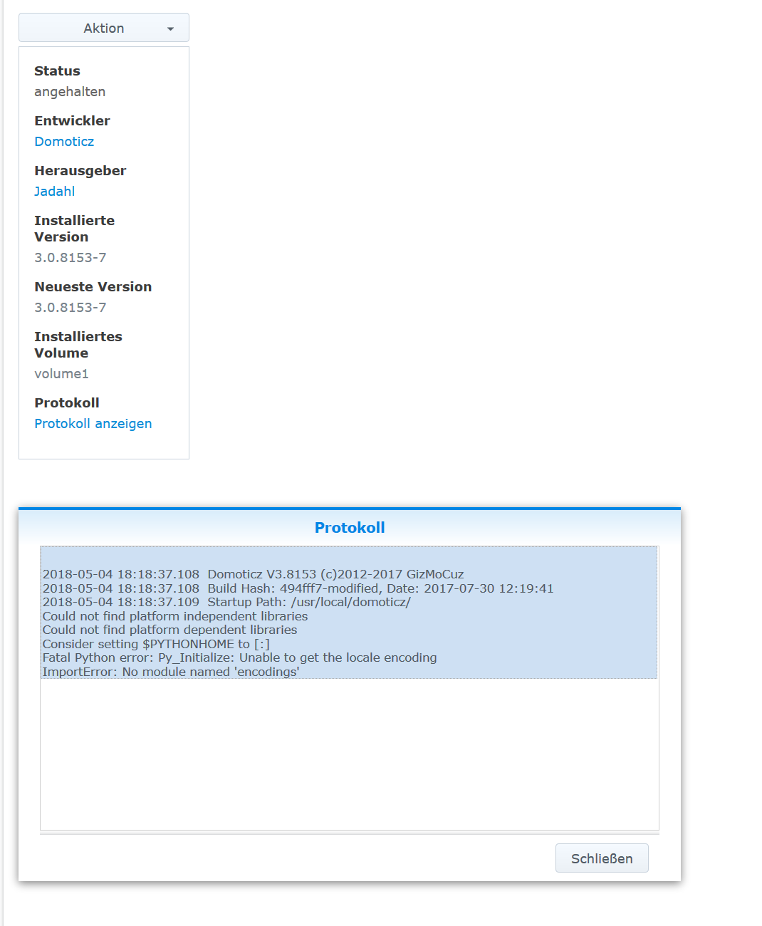

tried to install current Domoticz with Python on DS218+, but it does not start see error message below, can you please help? What does the proposal mean?
If I install it without Python it starts and I can see it running via Firefox.
I also can include remotes via usb z-stick gen5, however I cannot learn a new switch/scene, any ideas? Is this because theres no Python?
thanks a lot for your help,

You have to install Python 3 package before you install domoticz with python plugin.
You can download python 3 for DS218+ here: http://archive.synology.com/download/Pa ... 1-0108.spk
Also read this post: http://www.domoticz.com/forum/viewtopic ... 47#p117747

ok, thanks a lot, working now

Do you think you release your package for the DSM 6.2 for braswell ?
Thank you
Fabien
Braswell DSM 6.1 and DSM 6.2 use same toolchain and kernel, so domoticz for DSM 6.1 should work...
Take backup of domoticz.db and reinstall domoticz package and see if that helps.
So I tried to uninstall and reinstall but still not working.
I see in Hardware that the port is no longer recognized, I tried to installed the drivers for DSM 6.1 but nothing change.
If I connect on my NAS there is no port available on Domoticz, but on my computer my RFLink works great.
If you have any idea, I appreciate.
Thank you
