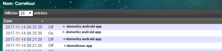

Same for me, can be good if we can have some app log to check what happen
There is my virtual switch log :
probleme is the same for domoticz android app and domofence, using api can be good when user is walking or riding a bike, but when driving a car or a mortorcycle, it doesn't look to be quicker as it have to
