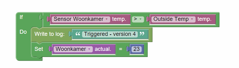

I am reposting this here, since in the original post, no comments were made after a few days, perhaps that was in the wrong spot;
My Smartwares radiator valves that I am using, don't show up in blocky. I mean, they are listed, but only as switches or utility, and in an event they do not update. So, I have this very simple event;
But although it triggers, it never changes the value of the smartware valve. If I set it manually via the utility tab in the web interface, it works just fine. Is this something I am doing wrong? Should the valve be available as radiator?

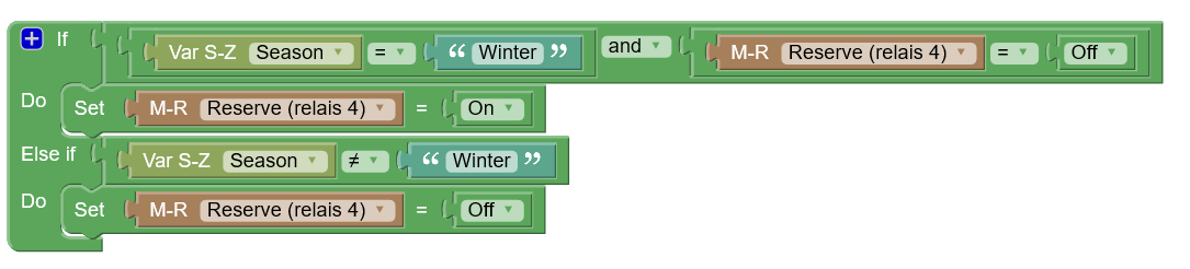

For the first time I faced a limitation of blockly.
Using the wiki and an article in Computer Totaal I managed to create the following user variables:
Knipsel 1.PNG (73.06 KiB) Viewed 12459 times
I want to use user variable "Season" , no success! The following event will not work.
Knipsel 3.PNG (30.34 KiB) Viewed 12459 times
1. What am I doing wrong?

It would be nice if there is a similar block for season.
Thanks in advance!
PS: Yesterday I posted a similar post in viewtopic.php?f=23&t=7518&p=75842&hilit=winter#p75008
This place seems better.

Jan Jansen wrote:Hi all,
2. I saw the next block: Knipsel 4.PNG
Thanks in advance!
