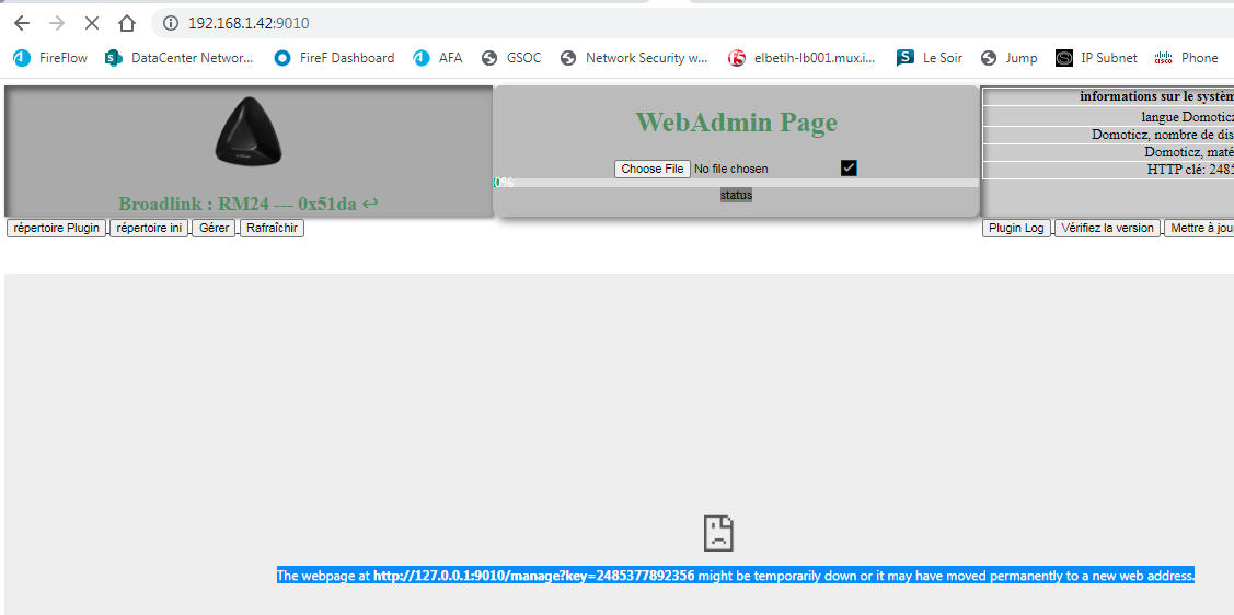

Hi Guys
I am able to work with plugin but the web admin is not ok
I am on synology with Docker .
I follow your guideline zak45 using 127.0.0.1 port 9010 because 9000 is used
I am able to go to the page but i have temporary down
do you have any idea ?
I just used python setup.py
Can you please help

Re: Python Plugin : Broadlink
provide your settings, but I think that you can not use 127.0.0.1 as address.nono212 wrote: Friday 19 February 2021 10:52 Hi Guys

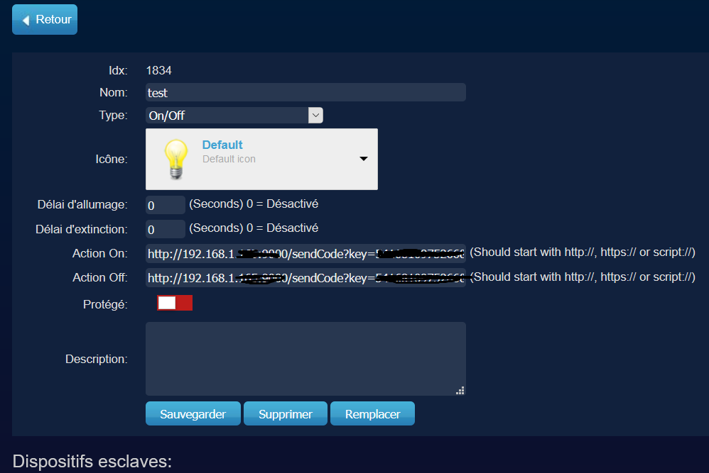

For a simple On/off switch in Domoticz, better create a dummy device and copy paste corresponding http command:albebert wrote: Wednesday 24 February 2021 23:49
need to understand how it works now(tried a single IR remote : ok) need to find how create a on/off command with different IR/RF command now
