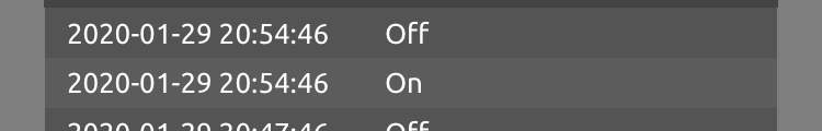

JonyBCN
Posts: 39
Joined: Tuesday 24 May 2016 22:39
Re: Python Plugin: Smart Virtual Thermostat
Post by JonyBCN »
Great idea. For work reasons I use PIDs and apply it to software heating I thought it was great.
I have been testing the plugin and for some reason I have an unexpected problem.
My installation for this case consists of a temperature sensor in the room to be heated, another outside and to heat the room an electric radiator controlled by a Fibaro plug.
Mole seems to be fine, but there are problems with the plug control. The first night he stayed on (Domoticz "saw it" off) constantly raising the temperature.
The reverse also happened during the day, Domoticz believed that the plug was on when it was actually turned off.
Checking the plug logs I see what the problem may be: the plugin sends the orders too fast: at the same exact time it sends the On and Off signal, and I think the plug is not able to respond properly. Can be? If so, it shouldn't be complicated to fix it.

After few seconds the normal behavior is restored but the rele goes out of sync and I have to fix it manually
This is is the configuration:
Apply minimum heating per cycle: only when heating is required
Calculation cycle...: 15,5,2,1,60
Variables: 'LastOutT': 12.0, 'ConstC': 362.5, 'LastInT': 20.7, 'LastPwr': 100, 'LastSetPoint': 23.5, 'nbCT': 50, 'ALStatus': 1, 'nbCC': 50, 'ConstT': -9.6}
Any idea on what's going on? or troubleshoot the issue?
Stefano
16/03/2020 08:53:20	On
16/03/2020 06:31:33	Off
16/03/2020 06:31:32	On
16/03/2020 06:31:31	Off
16/03/2020 06:31:30	On
16/03/2020 06:31:28	Off
16/03/2020 06:31:27	On
16/03/2020 06:31:26	Off
16/03/2020 06:31:25	On
16/03/2020 06:31:24	Off
16/03/2020 06:31:23	On
16/03/2020 06:31:22	Off
16/03/2020 06:31:21	On
16/03/2020 06:31:20	Off
16/03/2020 06:31:19	On
16/03/2020 06:31:17	Off
16/03/2020 06:31:16	On
16/03/2020 06:31:15	Off
16/03/2020 06:31:14	On
16/03/2020 06:31:13	Off
16/03/2020 06:31:12	On
16/03/2020 06:31:11	Off
16/03/2020 06:31:10	On
16/03/2020 06:31:09	Off
16/03/2020 06:31:08	On
16/03/2020 06:31:06	Off
16/03/2020 06:31:05	On
16/03/2020 06:31:04	Off
16/03/2020 06:31:03	On
16/03/2020 06:31:02	Off
16/03/2020 06:31:01	On
16/03/2020 06:31:00	On
16/03/2020 06:17:10	Off
16/03/2020 06:17:09	Off
16/03/2020 06:16:00	On
16/03/2020 06:15:59	On
16/03/2020 06:02:09	Off
16/03/2020 06:02:08	Off
16/03/2020 06:00:59	On
16/03/2020 06:00:58	On
16/03/2020 05:47:08	Off
16/03/2020 05:47:07	Off
16/03/2020 05:45:58	On
16/03/2020 05:45:57	On
