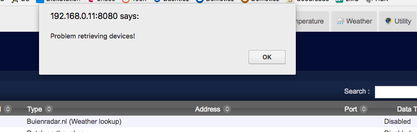

EdwinK
Posts: 1820
Location: Rhoon
Re: Buienradar Weather Lookup Plugin
Post by EdwinK »
It's only with this plugin and the Life360 plugin. So far all others are working. Might as well keep Darksky for now (with history)
Tried again, but still the same...
Screen Shot 2018-01-27 at 20.24.29.png (41.84 KiB) Viewed 4921 times
