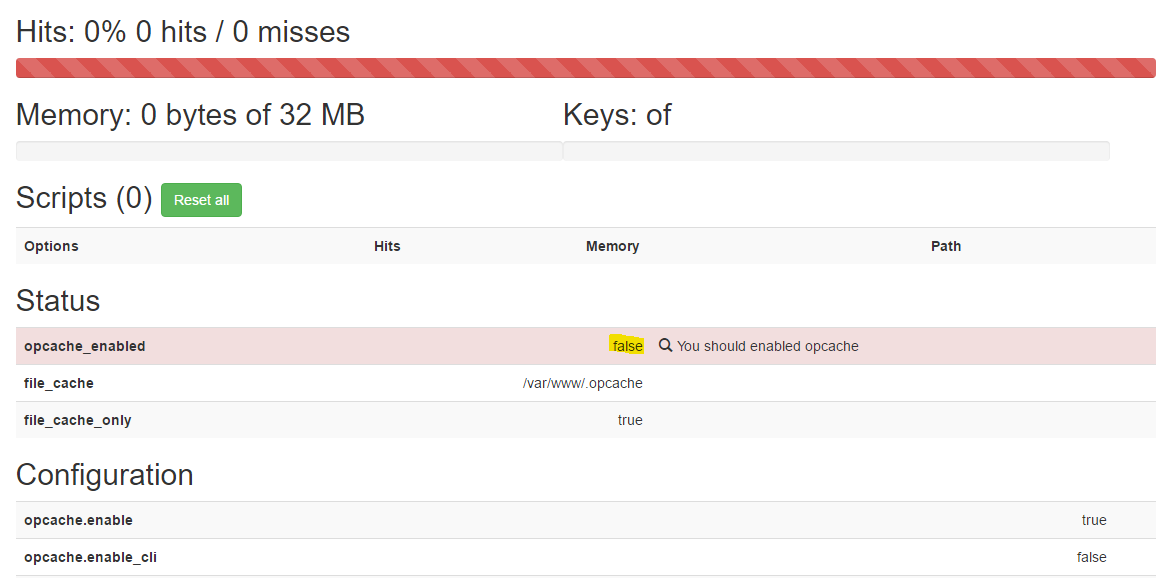

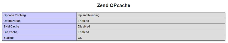

You would guess it is configured okay ? Right.? my .opcache directory is populated. :D
2. Opcache.JPG (28.12 KiB) Viewed 2731 times
Strange strange strange. If we could just get the first 30ms off ;-) from switching the switch to calling the php.
That would be amazing. However don't have a clue on how to achieve this.

If "LUA: 1. Encoding started" is the first line of your lua script you wont get that time off, that's in Domoticz.
If that's after the loading of the cb-json thing you could benefit from my concatenate stuff as that doesn't need to load anything external.
If you then have the system so that you only require the devicechanged table the encoding should be finished in less than 1 msec after the script is triggered.
I do see a difference in your opcode settings:
Seems that your's is set to use file cache instead of memory.
These are my settings:
3. opcache.JPG (59.04 KiB) Viewed 2719 times
Damn.... missed that one..
; Enables or disables opcode caching in shared memory.
opcache.file_cache_only=0
Re: LUA Pass2php
Posted: Tuesday 10 January 2017 15:23
by Egregius
And still there's something wrong I think. You're at 0 misses and memory is at 0 bytes.
Should be like this:
On my system it was an improvement of approx 40 msec.
Or do you already see a speed improvement now?
