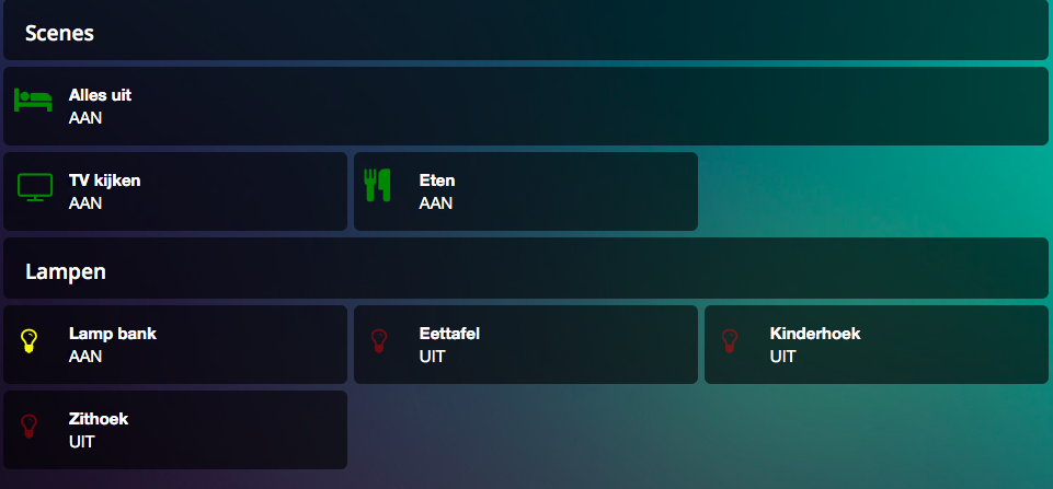

Dimmer as a simple switch
So, I have 3 dimmers setup in dashticz that I would like to operate as a normal switch.
I can easily remove the slider in custom/custom.css:
The problem is, however, if I change the width to the default 4 for simple switches, the icon-data ratio is still set to the standard 2-10 that is used for dimmers. The width of 2 for the icon is too small for a decent icon size, resulting in the text being wrapped underneath the icon.
For now, I circumvented this by creating a group with just one lamp set to a specific brightness. This works, but obviously doesn't show the brightness setting, which I do like (so I can see if it has been tempered with using the physical switch
Any suggestions?
.slider16 {display: none;}Any suggestions?
Recent beta (git) on Arch Linux | Dashticz v2 (git) | RFLink 46.0 | Ikea Trådfri | P1 Smart Meter
