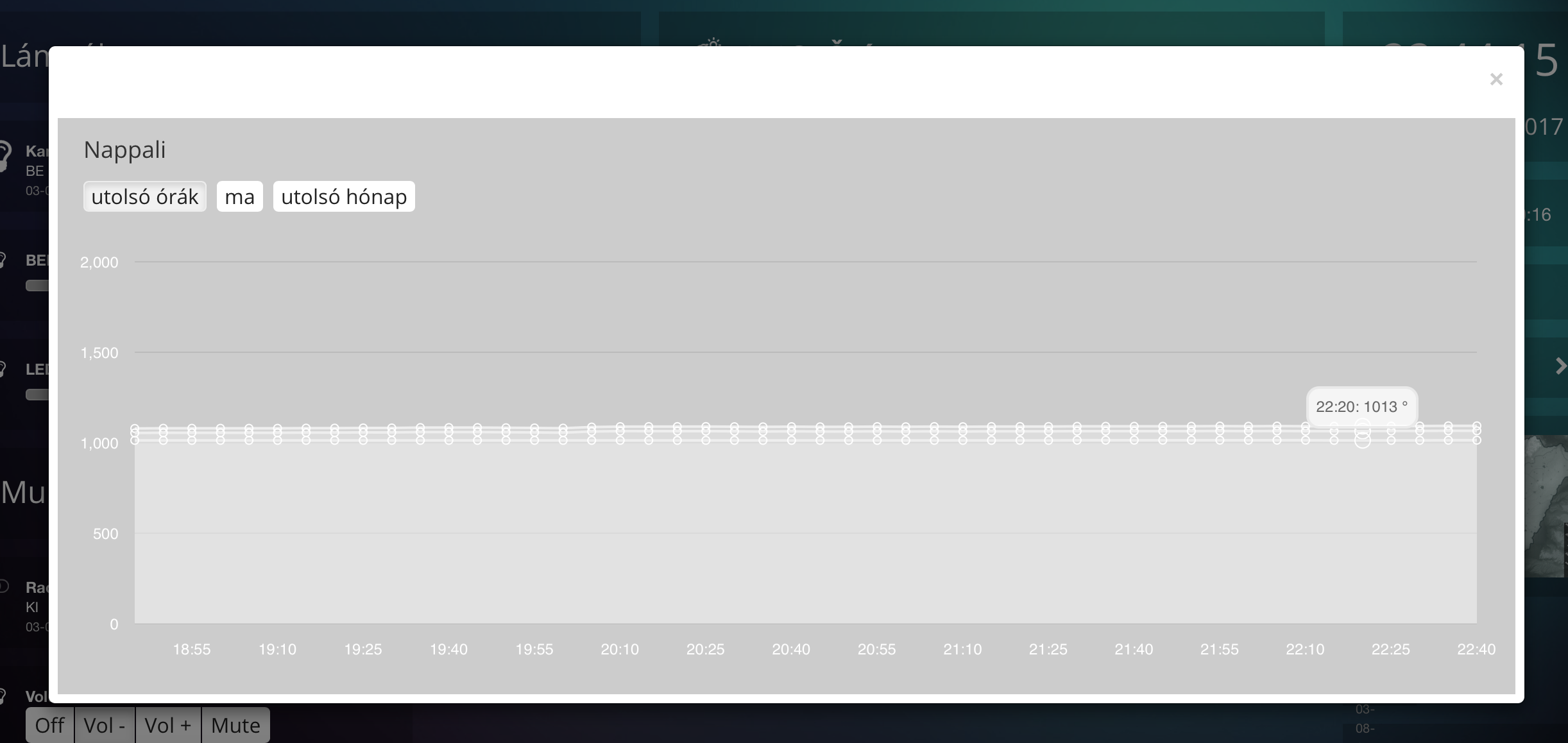

Bug in graph:
+one more question: how do I change time format in miniclock? I tried change config['timeformat'], but it doesn't seem to be working.
Screen Shot 2017-08-03 at 22.44.12.png (350.26 KiB) Viewed 3144 times
Screen Shot 2017-08-03 at 22.44.04.png (57.71 KiB) Viewed 3144 times
