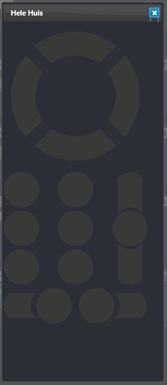

I just started using LMS.
I added it to Domoticz succesfully and am able to power player (chromecast) on/off and pause playing via blockly.
The remote in the Domoticz GUI however does not work and looks like this:
I tried updating my domoticz but that does not help. I'm on version 3.8434 right now.
Does anyone know how to solve this?

freakshock wrote: Thursday 27 July 2017 18:24 I just started using LMS.
I have the same issue.

Me too...

Me 3
Any solution for an empty remote??

gijsje wrote: Saturday 21 October 2017 12:37 Me 3
Same here, Win10 Firefox, but I noticed the buttons appear correctly when you hover over them (then disappear again).
