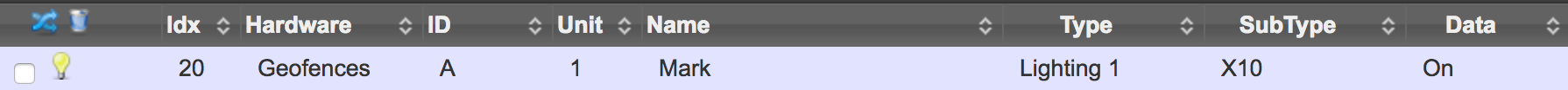

leon33 wrote: Thursday 31 August 2017 14:06 I tested with a lower idx number, but still the same error
Hmm, is the type of the switch correct? Is it a on/off switch?
Screen Shot 2017-08-31 at 14.42.37.png (36.29 KiB) Viewed 5398 times
leon33
Posts: 6
Joined: Thursday 31 August 2017 13:24
Domoticz version: V3.8153
Re: Geofence for Domoticz
Post by leon33 »
Yes it's a light on/off switch, the only differnce i see is the hardware, Geofences instead of dummy.
