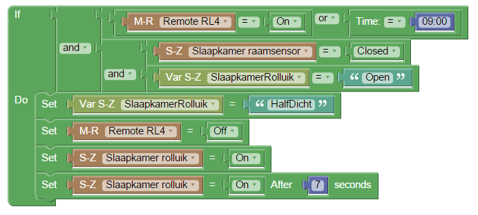

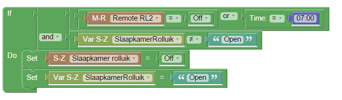

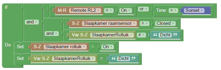

I started using Domoticz recently and as I was used to Nodo Domotica I started using the Event system in Domoticz right away.
My goal is to keep things simple and to only use Blocky (so preferably no LUA scripting).
I have 3 events to get my blinds in a particular situation: open, half-closed and closed.
Open should be at a certain time (at 07:00) or when the Off button of a remote switch RL2 is pressed Closed should be at a certain time (at sunset) or when the On button of a remote switch RL2 is pressed (in both cases only when the window sensor is Closed) Half Closed should be at a certain time (at 09:00) or when the On button of a remote switch RL4 is pressed (in both cases only when the window sensor is Closed and the blinds are Open) To check the actual state of the blinds I maintain a uservariable (Open / Dicht (Closed) / HalfDicht (HalfClosed) )
When I manually open the blinds by pressing Off on the RL2 remote switch, that works and the uservariable is set to "Open".
Now, when I manually want to set the blinds to HalfClosed by pressing On on the RL4 remote switch, this seems to work as well.
BUT: Although no events happen in between (otherwise I would have understood the behaviour), after one minute the blinds go Open again. Apparently because the state of RL2 is still "Off" and Domoticz checks event entry states every minute or so.
I cant imagine I am the first one encountering this issue. More likely my blocky events are not OK.
Any help is greatly appreciated.
BTW: I am using the "External" AND construct, AFAIK no difference with using the "Inlinde" variant, but this one makes the event better readable in my opinion.
UPDATE: Apparently I have overlooked an important remark in the Event wiki pages:
So: To avoid this checking I should clearly separate the time-based evens from time-independent events.
Which will make that I will end up with 6 events instead of 3.
Will try and report back!
Now probably this rule makes that my event decisions are checked every minute.....every minute, the system checks all blockly rules that mention a time condition and evaluates them.

Apparently describing my issue here made me help solve it myself.
What I thought yesterday indeed was the cause.
Every event that has a "time" condition in its logic, is evaluated every minute. This means that every minute ALL other conditions in the event are evaluated.
Which might lead to the triggering of the event every minute...
Solution: make sure an event only consists of "time" OR "non-time" conditions (and do not mix them together).
That is: If your events suffer from this behaviour

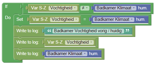

Blockly - Cannot save multisensor value in user variable
I'm using a blockly to save temperature and humidity values from an Aeotec Multisensor6 so that I can determine if humidity and temperature values have increased or decreased. Values are stored in User Variables of type float.
This goes well for the temperature, but fails for the humidity value. Domoticz version is 2.3852.
The log shows:
2015-12-18 13:30:42.294 (RaZberry) Temp + Humidity (Badkamer Klimaat)
2015-12-18 13:30:43.047 Error: EventSystem: Error updating variable Vochtigheid: Not a valid float
2015-12-18 13:30:43.048 Badkamer Vochtigheid vorig / huidig:
2015-12-18 13:30:43.048 0
2015-12-18 13:30:43.049 20.0;73;3
It seems that the blockly scipt assigns the value "20.0;73;3" to the user variable instead of the expected value of "73". As "20.0;73;3" is a string value and the user variable has type float this would result in a type mismatch.
Is this "by design" and should I write a LUA script (which I would like to prevent) or is this a bug with the blockly interpreter?
Any advice is appreciated.
The log shows:
- gizmocuz
- Posts: 3026
- Location: Top of the world
Re: Events system thread (questions and feedback)
humidity is an integer
could you try with this type of user variable ?
- Leeuwerik
- Posts: 3
- Joined: Friday 05 June 2015 14:02
I did, the same issue exists when the user variable is an integer. When I change the type to string, the assignment completes successfully.
- jvdz
- Posts: 2482
- Domoticz version: 4.107
In LUA it will pass a string as described in the Event Wiki:
Jos
Guess that is the same for Blockly.- v1.867: Temp, hum and baro values are passed to Lua as proper numbers instead of strings. otherdevices_svalues[] is
still passed as a string to access other measurement devices for the time being.
Jos
