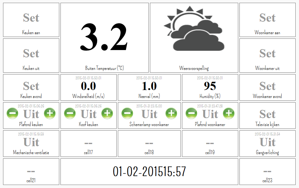

jan_nl wrote:I only change the word for off to set. I did not check uf a scene can be switched off. Obviously this is possible in domoticz. I will see if I can disable this in frontpage.
For the layout. Since it is not really scalable, it depends on the number of pixels whether it fits ir not.
Ah thanks. It looks like it works like switching a group, but a scene is more like a 'snapshot'. When you activate it, all devices go to that preconfigured state.
What do i need to edit to make it fit? I already looked at the CSS and so, but i am not really a webdesign hero :P

I found out why my scene status wasn't displaying. I was missing this chunk of code:
/* Change the text for on/off switches*/
var txt_on = 'Aan';
var txt_off = 'Uit';
/*Change thetText displayed in PopUps*/
var txt_switch_protected = '\'Schakelaar is beveiligd\'';
var txt_switch_on = '\'Inschakelen\'';
var txt_switch_off = '\'Uitschakelen\'';
/*Change the timeout of the PopUp*/
var switch_protected_timeout = '1000';
var switch_on_timeout = '1000';
var switch_off_timeout = '1000';
Now when I turn on one scene, all scenes turn on. Have to look into this later. Maybe the latest scene changes in the posts above will fix this. :)

I just checked, when I click Set, the Scene is set on, when I click Set again, the Scene is switched on again, I can not switch off a scene.
Remeber the difference between Groups and Scene's.

It works, i had the IDX of a group in the settings, not the IDX of the scene i meant.
Sorry for the confusion :(
*ThinkPad is going to shame itself :P
Now only fixing the layout so it fits on my screen.... How?

Look in the frontpage.css, escpeccially the cellxx blocks, there you can changed the width and height,

Thanks to 'pjeterinfo' i managed to get the interface fit on my tablet.
I changed the 'initialscale' to 0.95 instead of 1:
<meta name="viewport" content="width=device-width, initial-scale=0.95,maximum-scale=1,user-scalable=no" />
(One of the first lines in frontpage.html).

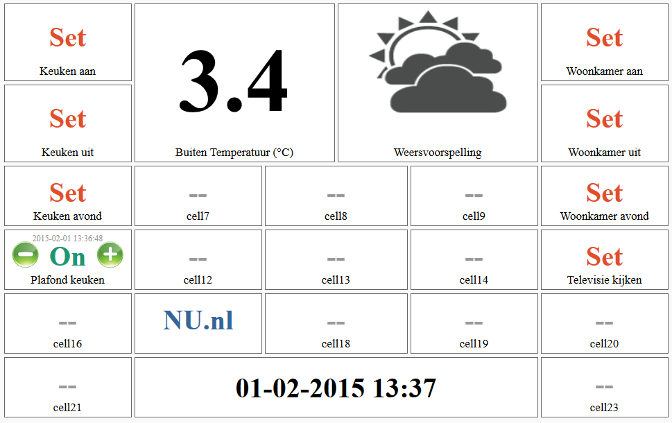

I'm no html coder whatsoever, just try and error!
This is my work so far: (using Darkoticz colors for the dark version)
And on my phone:
