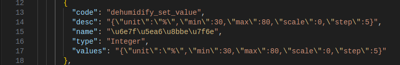

Set dehumify value; Does not work.
It refreshes after a while to the current value so that is correct. In domoticz it shows as a selector switch. On selection nothing happens.
Could it be that its mapped to the wrong type of switch? I see a color option which doesnt seem logical.
Is there some debug manual option available so I can test the command myself? Or do checks...

84dasilva wrote: Thursday 11 September 2025 17:21 Set dehumify value; Does not work.
I see something, code of device is in steps of five the selector switch is steps of one, can you test 50,55,60 see if that works. I check the code why it skip the step size.
Schermafdruk van 2025-09-11 21-03-02.png (28.08 KiB) Viewed 61 times
Edit: The plugin is updated! remove the selection device, restart the plugin the new device will created.
