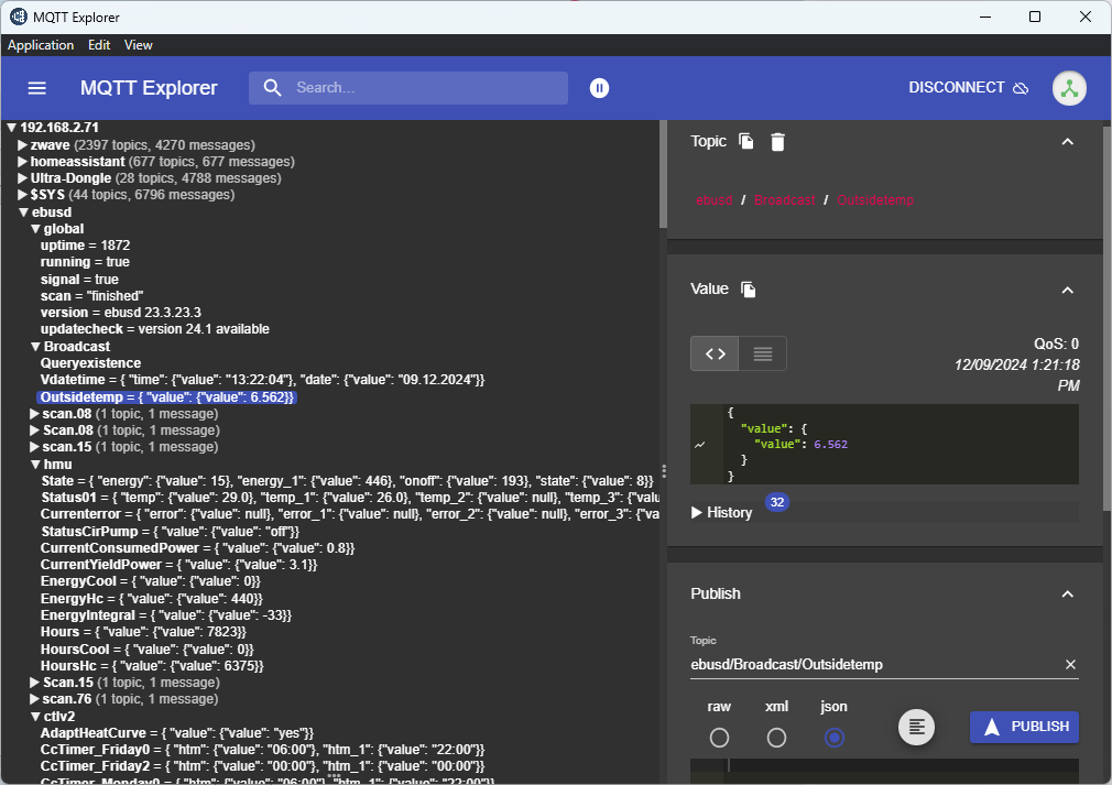

I can't seem to get this right ..........
I changed my MQTT file:
My own rework of the outside temperature:
"T_Outside": {
"topic": "ebusd/Broadcast/Outsidetemp",
"type": "80", "subtype": "5", "switchtype": "0",
"mapping": {"iten":{"item": ""}, "multiplier": 1}
"T_Living": {
"topic": "ebusd/ctlv2/Z1RoomTemp",
"mapping": {"item": "", "multiplier": 1}
"MQTTrunning": {
"topic": "ebusd/global/running",
"type": "244", "subtype": "73", "switchtype": "0",
"mapping": {"item": "", "default": "0"}
"MQTTsignal": {
"topic": "ebusd/global/signal",
"T_Outside": {
"T_Living": {
"MQTTrunning": {
"MQTTsignal": {
- Screenshot 2024-12-09 132226.png (122.8 KiB) Viewed 5328 times
- Posts: 7002
- Domoticz version: 2026.3
Re: Python Plugin: MqttMapper
topic "ebusd/Broadcast/Outsidetemp" has message
{"value":{"value": 6.562"}}
then the mapping should be
"mapping": {"item": "value/value"}
hjzwiers
- Posts: 303
- Joined: Friday 12 January 2018 8:26
Thanks that was it!!
I was a bit confused as MQTT made two new files, but I deleted the old ones.

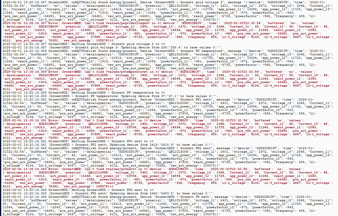

Hello, sometimes I take a dive and try to accomplish getting growatt inverter data into Domoticz.
I have partially succes. With MQTTmapper I get values with a json file I found in this thread. They appear just for a second and then reset to '0'
I used this code from viewtopic.php?p=314130&hilit=growatt#p314130 by pwhooftman. Thanks for this example.
I attach a piece of the log file as an image because it shows more clearly. Just for a second!
If anyone knows what's happening I would be very grateful.
FlyingDomotic
- Posts: 474
- Joined: Saturday 27 February 2016 0:30
- Domoticz version: 2020.2
It seems that data returned by your device is slightly (very?) different of those given in other topic you mentioned.
To get precise idea of topic content, cut received message from log (from line onMqttPublish foud xxx, Device 'yyy', message 'zzz', extract zzz part, without surrounding quotes), and paste it in any json formatter (for example https://jsonformatter.curiousconcept.com, or even better NotePad++ with json plugin).
You'll clearly find full path to use, in your case, probably something like "value/voltage_l3" (instead of "value/pvgridvoltage3") or "value/act_power_l2" (instead of "value/pv2watt"). Obviously, it seems that temperature is not returned by your device.
Note that it could be easier to debug if you cut and past text (including log) in your message instead of an image.
Note also that you have negative values in power, meaning either that you produce energy and re-inject it into grid, or you mounted tore up side down.
- winner61
- Posts: 20
- Joined: Friday 02 August 2024 12:13
- Domoticz version: 2026.2
- Location: Friesland / NL
Thank you FlyingDomotic. I'm not really into programming so this is not really transparent for me. I hope to get some good advice here, like from you. The reason that I used an image is because of the instant colors distinguishing between the error- and normal log. Tried to do what you said and removed the quotes bur notepadd++ won't json format it. Also not transparent what to leave out or keep in. Mayby a little pointer
. Thank you again.
2025-02-02 12:15:31.099 GrowattMOD: onMQTTPublish found energy/growatt, Device 'GrowattMOD - Growatt PV2 voltage', message '{'device': 'QBL1CL305R', 'time': '2025-02-02T12:14:35', 'buffered': 'no', 'values': {'datalogserial': 'XGD6CCN0JV', 'pvserial': 'QBL1CL305R', 'pvstatus': 1, 'pvpowerin': 48842, 'pv1voltage': 3604, 'pv1current': 67, 'pv1watt': 24146, 'pv2voltage': 3528, 'pv2current': 70, 'pv2watt': 24696, 'pv3voltage': 0, 'pv3current': 0, 'pv3watt': 0, 'pv4voltage': 0, 'pv4current': 0, 'pv4watt': 0, 'pvpowerout': 24982, 'qac': 337, 'pac': 24011, 'pvfrequency': 4998, 'pvgridvoltage': 2393, 'pvgridcurrent': 34, 'pvgridpower': 8136, 'pvgridvoltage2': 2375, 'pvgridcurrent2': 34, 'pvgridpower2': 8075, 'pvgridvoltage3': 2325, 'pvgridcurrent3': 34, 'pvgridpower3': 7905, 'vacrs': 4125, 'vacst': 4084, 'vactr': 4075, 'ptousertotal': 0, 'ptogridtotal': 0, 'ptoloadtotal': 24982, 'totworktime': 61038737, 'eactoday': 66, 'pvenergytoday': 66, 'eactotal': 97914, 'pvenergytotal': 97914, 'epvtotal': 83108, 'epv1today': 29, 'epv1total': 40919, 'epv2today': 37, 'epv2total': 42189, 'epv3today': 0, 'epv3total': 0, 'etousertoday': 113, 'etousertotal': 37264, 'etogridtoday': 0, 'etogridtotal': 37664, 'eloadtoday': 184, 'eloadtotal': 82629, 'epv4today': 0, 'epv4total': 0, 'epvtoday': 66, 'deratingmode': 0, 'iso': -6, 'dcir': 53, 'dcis': 4, 'dcit': 132, 'gfci': 1, 'busvoltage': 6493, 'pvtemperature': 291, 'pvimptemperature': 428, 'boosttemperature': 283, 'temp4': 0, 'comboardtemperature': 303, 'pbusvoltage': 3272, 'nbusvoltage': 3219, 'ipf': 20000, 'realoppercent': 29, 'opfullwatt': 80000, 'standbyflag': 0, 'faultmaincode': 0, 'warnmaincode': 0, 'faultsubcode': 0, 'warnsubcode': 0, 'uwpresentfftvaxxxlue[channela]': 0, 'bafcistatus': 0, 'uwstrength[channela]': 0, 'uwselfcheckvalue[channela]': 0, 'invstartdelaytime': 60, 'bdconoffstate': 1, 'drycontactstate': 0, 'pself': 24982, 'esystoday': 70, 'edischrtoday': 12, 'edischrtotal': 39391, 'echrtoday': 7, 'echrtotal': 39470, 'eacchrtoday': 0, 'eacchrtotal': 18615, 'esystotal': 101274, 'eselftoday': 71, 'eselftotal': 63607, 'reserved3143': 0, 'priority': 0, 'epsfac': 0, 'epsvac1': 0, 'epsiac1': 0, 'epspac1': 0, 'epsvac2': 0, 'epsiac2': 0, 'epspac2': 0, 'epsvac3': 0, 'epsiac3': 0, 'epspac3': 0, 'epspac': 0, 'loadpercent': 0, 'pf': 10000, 'dcv': 0, 'newbdcflag': 0, 'bdcderatingmode': 0, 'sysstatemode': 257, 'faultcode': 0, 'warncode': 0, 'vbat': -28619, 'ibat': 63, 'soc': 13, 'vbus1': 6481, 'vbus2': 3189, 'ibb': 31, 'illc': 31, 'tempa': 233, 'tempb': 0, 'pdischr': 0, 'pchr': 23580, 'pchrxxxl': 23580, 'edischrtotalstor': 39391, 'echrtotalstor': 39470, 'bdc1flag': 3, 'vbus2low': 3292, 'bmsmaxvoltcellno': 108, 'bmsminvoltcellno': 38, 'bmsbatteryavgtemp': 0, 'bmsmaxcelltemp': 144, 'bmsbatteryavgtemp2': 122, 'bmsmaxcelltemp2': 1, 'bmsbatteryavgtemp3': 26, 'bmsmaxsoc': 0, 'bmsminsoc': 0, 'parallelbatterynum': 1, 'bmsderatereason': 0, 'bmsgaugefcc(ah)': 48, 'bmsgaugerm(ah)': 48, 'bmserror': 0, 'bmswarn': 0, 'bmsfault': 0, 'bmsfault2': 0, 'batisostatus': 0, 'battneedchargerequestflag': 0, 'bmsstatus': 1, 'bmserror2': 0, 'bmswarn2': 0, 'bmssoc': 13, 'bmsbatteryvolt': -28666, 'bmsbatterycurr': 610, 'bmsbatterytemp': 310, 'bmsmaxcurr': 2500, 'bmsmaxdischrcurr': 2500, 'bmscyclecnt': 0, 'bmssoh': 98, 'bmschargevoltlimit': -25776, 'bmsdischargevoltlimit': -32496, 'bmswarn3': 0, 'bmserror3': 0, 'bmssinglevoltmax': 3303, 'bmssinglevoltmin': 3276, 'batloadvolt': -28666}}'
FlyingDomotic
- Posts: 474
You have to select everything starting after "message='" and last quote ', giving:winner61 wrote: Sunday 02 February 2025 13:36 Thank you FlyingDomotic. I'm not really into programming so this is not really transparent for me. I hope to get some good advice here, like from you. The reason that I used an image is because of the instant colors distinguishing between the error- and normal log. Tried to do what you said and removed the quotes bur notepadd++ won't json format it. Also not transparent what to leave out or keep in. Mayby a little pointer. Thank you again.
Après ça, Notepad++ va fonctionner ...
Par contre, on est assez loin du format du post précédent ...
- winner61
- Posts: 20
Hello FlyingDomotic. It worked
I have a list now, but the names are like in the original json from pchooftman. I attach both.
So, I get values each minute but they don't stick and after a second all is empty again.
The temperature is there but on the temperature tab.
Greetings, Winfryd.
Greetings, Winfryd.
- winner61
- Posts: 20
The first is a longer peace of the logfile.
FlyingDomotic
- Posts: 474
I got it!
It seems you have 2 devices speaking on the same topic. First is QBL1CL305R:
As of now, MqttMapper was designed to have dedicated topics, so has difficulties to with variable content.
I'll made a change in order to be able to select message only if it contains a field with specific value (here, selection could by done on "device" = "QBL1CL305R".
Stay tuned!
... while second is XGD6CCN0JV:{'device': 'QBL1CL305R', 'time': '2025-02-02T07:11:14', 'buffered': 'no', 'values': {'datalogserial': 'XGD6CCN0JV', 'pvserial': 'QBL1CL305R', 'pvstatus': 1, 'pvpowerin': 31263, 'pv1voltage': 3544, 'pv1current': 43, 'pv1watt': 15239, 'pv2voltage': 3561, 'pv2current': 45, 'pv2watt': 16024, 'pv3voltage': 0, 'pv3current': 0, 'pv3watt': 0, 'pv4voltage': 0, 'pv4current': 0, 'pv4watt': 0, 'pvpowerout': 13423, 'qac': 127, 'pac': 12186, 'pvfrequency': 5000, 'pvgridvoltage': 2366, 'pvgridcurrent': 18, 'pvgridpower': 4258, 'pvgridvoltage2': 2352, 'pvgridcurrent2': 18, 'pvgridpower2': 4233, 'pvgridvoltage3': 2354, 'pvgridcurrent3': 18, 'pvgridpower3': 4237, 'vacrs': 4093, 'vacst': 4074, 'vactr': 4082, 'ptousertotal': 0, 'ptogridtotal': 0, 'ptoloadtotal': 13423, 'totworktime': 61054268, 'eactoday': 96, 'pvenergytoday': 96, 'eactotal': 97944, 'pvenergytotal': 97944, 'epvtotal': 83207, 'epv1today': 78, 'epv1total': 40968, 'epv2today': 87, 'epv2total': 42239, 'epv3today': 0, 'epv3total': 0, 'etousertoday': 113, 'etousertotal': 37264, 'etogridtoday': 0, 'etogridtotal': 37664, 'eloadtoday': 216, 'eloadtotal': 82661, 'epv4today': 0, 'epv4total': 0, 'epvtoday': 165, 'deratingmode': 0, 'iso': -6, 'dcir': 29, 'dcis': 11, 'dcit': 240, 'gfci': 0, 'busvoltage': 6446, 'pvtemperature': 293, 'pvimptemperature': 441, 'boosttemperature': 283, 'temp4': 0, 'comboardtemperature': 319, 'pbusvoltage': 3245, 'nbusvoltage': 3201, 'ipf': 20000, 'realoppercent': 15, 'opfullwatt': 80000, 'standbyflag': 0, 'faultmaincode': 0, 'warnmaincode': 0, 'faultsubcode': 0, 'warnsubcode': 0, 'uwpresentfftvaxxxlue[channela]': 0, 'bafcistatus': 0, 'uwstrength[channela]': 0, 'uwselfcheckvalue[channela]': 0, 'invstartdelaytime': 60, 'bdconoffstate': 1, 'drycontactstate': 0, 'pself': 13423, 'esystoday': 102, 'edischrtoday': 12, 'edischrtotal': 39391, 'echrtoday': 74, 'echrtotal': 39537, 'eacchrtoday': 0, 'eacchrtotal': 18615, 'esystotal': 101306, 'eselftoday': 103, 'eselftotal': 63639, 'reserved3143': 0, 'priority': 0, 'epsfac': 0, 'epsvac1': 0, 'epsiac1': 0, 'epspac1': 0, 'epsvac2': 0, 'epsiac2': 0, 'epspac2': 0, 'epsvac3': 0, 'epsiac3': 0, 'epspac3': 0, 'epspac': 0, 'loadpercent': 0, 'pf': 10000, 'dcv': 0, 'newbdcflag': 0, 'bdcderatingmode': 0, 'sysstatemode': 257, 'faultcode': 0, 'warncode': 0, 'vbat': -28082, 'ibat': 47, 'soc': 52, 'vbus1': 6437, 'vbus2': 3168, 'ibb': 23, 'illc': 23, 'tempa': 270, 'tempb': 0, 'pdischr': 0, 'pchr': 17980, 'pchrxxxl': 17980, 'edischrtotalstor': 39391, 'echrtotalstor': 39537, 'bdc1flag': 3, 'vbus2low': 3269, 'bmsmaxvoltcellno': 108, 'bmsminvoltcellno': 16, 'bmsbatteryavgtemp': 0, 'bmsmaxcelltemp': 171, 'bmsbatteryavgtemp2': 148, 'bmsmaxcelltemp2': 2, 'bmsbatteryavgtemp3': 28, 'bmsmaxsoc': 0, 'bmsminsoc': 0, 'parallelbatterynum': 1, 'bmsderatereason': 0, 'bmsgaugefcc(ah)': 48, 'bmsgaugerm(ah)': 48, 'bmserror': 0, 'bmswarn': 0, 'bmsfault': 0, 'bmsfault2': 0, 'batisostatus': 0, 'battneedchargerequestflag': 0, 'bmsstatus': 1, 'bmserror2': 0, 'bmswarn2': 0, 'bmssoc': 52, 'bmsbatteryvolt': -28116, 'bmsbatterycurr': 470, 'bmsbatterytemp': 334, 'bmsmaxcurr': 2500, 'bmsmaxdischrcurr': 2500, 'bmscyclecnt': 0, 'bmssoh': 98, 'bmschargevoltlimit': -25776, 'bmsdischargevoltlimit': -32496, 'bmswarn3': 0, 'bmserror3': 0, 'bmssinglevoltmax': 3344, 'bmssinglevoltmin': 3336, 'batloadvolt': -28136}}
When receiving the first one, data is properly loaded as items are found, but when second is received, they're set to zero as not found.{'device': 'XGD6CCN0JV', 'time': '2025-02-02T07:11:16', 'buffered': 'no', 'values': {'datalogserial': 'XGD6CCN0JV', 'pvserial': 'QBL1CL305R', 'voltage_l1': 2355, 'voltage_l2': 2347, 'voltage_l3': 2353, 'Current_l1': 15, 'Current_l2': 12, 'Current_l3': 26, 'act_power_l1': -2849, 'act_power_l2': -1472, 'act_power_l3': 4068, 'app_power_l1': 3599, 'app_power_l2': 3029, 'app_power_l3': 6254, 'react_power_l1': -2010, 'react_power_l2': -2148, 'react_power_l3': 427, 'powerfactor_l1': -792, 'powerfactor_l2': -527, 'powerfactor_l3': 649, 'pos_rev_act_power': -253, 'pos_act_power': -253, 'rev_act_power': -253, 'app_power': 12787, 'react_power': -3678, 'powerfactor': -14, 'frequency': 499, 'L1-2_voltage': 4072, 'L2-3_voltage': 4070, 'L3-1_voltage': 4078, 'pos_act_energy': 78553, 'rev_act_energy': 105727}}

Hello FlyingDomotic, that sounds very good and did a git pull.
Yes there are 2 devices, the inverter and the datalogger. The QB.. is the inverter and there is the data to be found.
I tried several things with {"select": {"item": "device", "value": "QBL1CL305R"}} but can't find the proper place for it.
I presume I have to place it in the json file in each device I want to see. Could you guide me where to out it, for example in:
"PV2 watt": {
"topic": "energy/growatt",
"key": "energy/growatt/pv2watt",
"type": "248", "subtype": "1",
"mapping": {"item": "values/pv2watt", "multiplier": 0.1}
Thank you so much.
