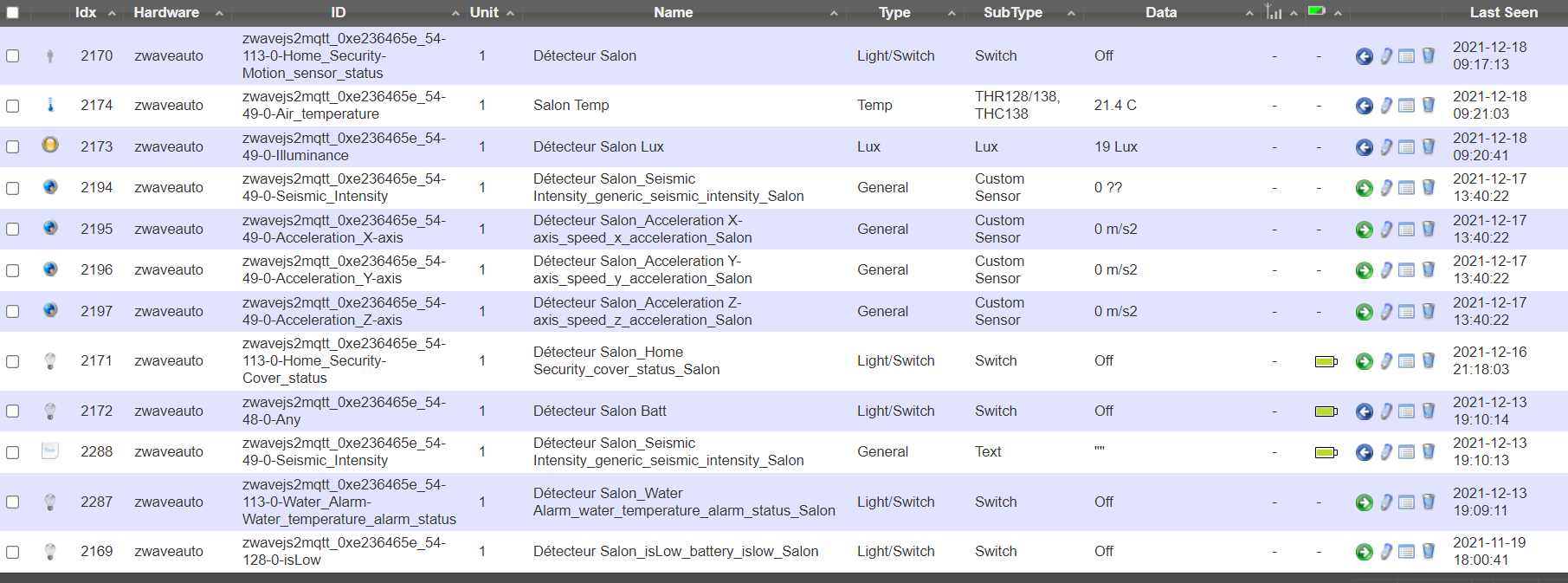

I've got one, it's like this
Screenshot 2021-12-18 092234.png (195.69 KiB) Viewed 2820 times

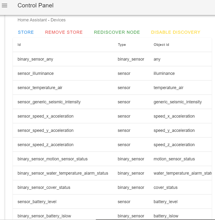

What you could do
1/ look in zwavejs2mqtt if the device seems ok
Screenshot 2021-12-18 092412.png (79.92 KiB) Viewed 2820 times
If not re-interview the node
2/ remove all devices in dz and rediscover the node to re-create the devices
And "use" the device to make it send data
