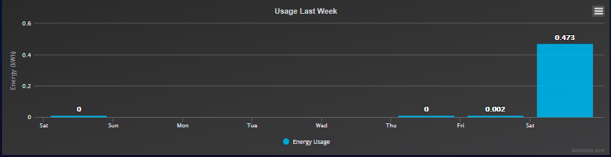

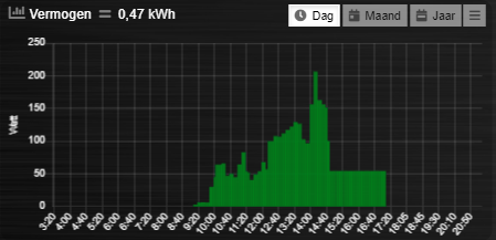

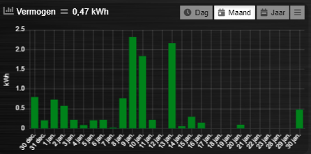

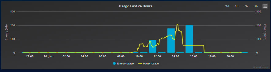

JanvdW
Posts: 118
Joined: Saturday 21 December 2019 8:36
Re: Multiple sources in one graph
Post by JanvdW »
In first instance I reacted by mail, but it appeared that this doesn't show up on the forum. I am struggling to upload the images, so hereby at least the description of the problem (images are in the mail).
The week/ month graphs are not the best example, because of some rainy days, but the Domoticz week graph clearly corresponds with the Dashticz month graph. The value for 'Energy Usage' in Domoticz (0.473) matches with Dashticz (0.47).
In the day graphs it's evident that the Domoticz yellow line corresponds with the Dashticz graph. The yellow Dashticz line is 'Power Usage', not 'Energy Usage' as in the month graph.
My block definition in Dashticz:
blocks['graph_23'] = { range: 'Maand', devices: [23], title: 'Vermogen', graph: 'bar', datasetColors: ['green'], legend: false, width: 12, beginAtZero: true, custom: {
        "Dag": { range: 'day', filter: '18 hours', data: { Vermogen: 'd.v_23' } },
		"Maand": { range: 'month', data: { Vermogen: 'd.v_23' } },
		"Jaar": { range: 'year', groupBy: 'month', aggregate: 'sum', data: { Vermogen: 'd.v_23' } } } }
Lokonli
Posts: 2292
Post by Lokonli »
If you reply via the 'Full Editor & Preview' button you can drag/drop the images, and then place them inline.
The pictures probably will help me to understand the issue.
JanvdW
Posts: 118
Post by JanvdW »
Week/month graphs:
Domoticz week graph.PNG (44.68 KiB) Viewed 1072 times
Dashticz month graph.PNG (43.29 KiB) Viewed 1072 times
JanvdW
Posts: 118
Post by JanvdW »
Day graphs:
Domoticz day graph.PNG (51.08 KiB) Viewed 1072 times

Dashticz shows different data sets in the two graphs:
  • the month/ week graph shows the 'Energy Usage' (blue bar)
  • the day graph shows the 'Power Usage' (yellow line)
I would expect that the day graphs show the 'blue bar values' as well
Lokonli
Posts: 2292
Post by Lokonli »
JanvdW wrote: Saturday 30 January 2021 23:40 Dashticz shows different data sets in the two graphs:
ok, I understand now.
I did some tests, but it's not so easy to add.
Probably it needs quite some restructuring/redesign of the graph code.
I'll add it to the list.
