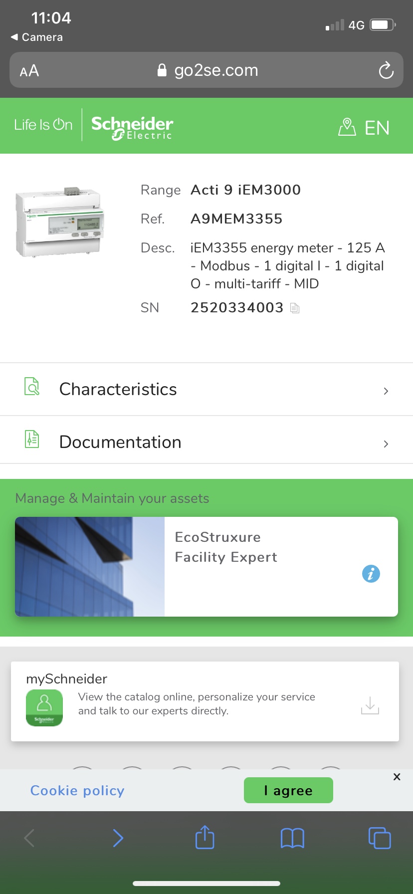

Is it possible to add the attached energy meter to Domoticz system ?
If so is they any links as a guide
Thanks in advance
John

Hi,jono wrote: Thursday 04 February 2021 22:48 Good evening
Thanks in advance
John
Modbus RTU protocol is available on iEM3555.
So if you have a USB / Modbus interface, you should be able to connect this energy meter to Domoticz.
All registers are defined in the User manual:
https://download.schneider-electric.com ... A0005EN-06

Is it a possible bug ?
- how do you round off the values
I.e 240v on energy meter no values after the decimal point
Thank you in advance
John
