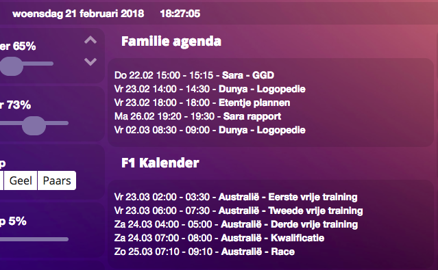

Strange. I'm using the latest beta and for me everything is working.
var calendars = {}
calendars.f1 = {maxitems: 5, title:'', image:'', icalurl:'webcal://p28-calendars.icloud.com/published/2/xxxxxxxx'}
calendars.prive = {maxitems: 5, title: '', image: '', icalurl:'webcal://p04-calendarws.icloud.com/ca/subscribe/1/xxxxxxx'}
Schermafbeelding 2018-02-21 om 18.27.00.png (222.21 KiB) Viewed 3682 times

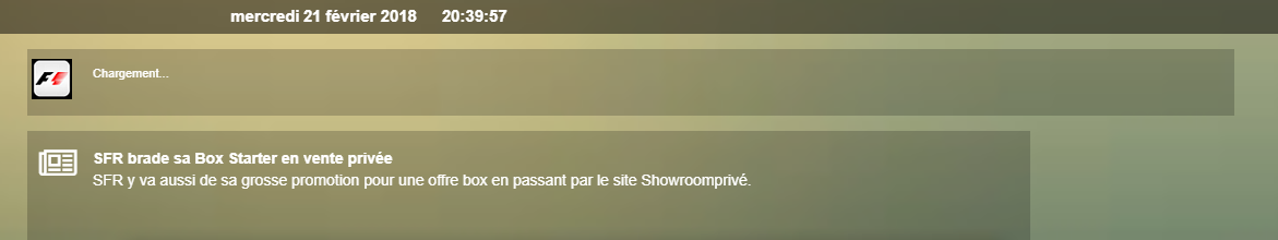

it doesn't work with chrome firefox edge or Internet Explorer on my Win 10 computer. I try beta or stable version but nothing for the calendar
calendars.F1 = { maxitems: 5, image: 'calendar.png', url: 'webcal://xxxx2018-formula-1-calendar/calendar.ics', icalurl: 'webcal://xxxx2018-formula-1-calendar/calendar.ics'};
The attachment stable.PNG is no longer available
but if i try it on my smartphone with the browser "Samsung internet", chrome on external lan (4G), it works.
to resume no calendar in internal network but well in external network (i use a no-ip adress for the external)
no https
