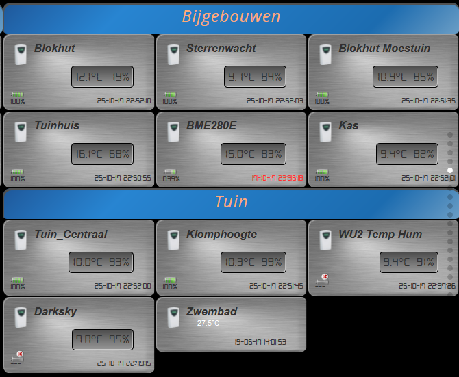

Still having issues with the lastest Beta Latest commit f4d1f5a 4 days ago (21/10/2017) regarding Temp & Humidiy sensors.
see http://www.domoticz.com/forum/viewtopic ... 00#p154374 (bug report) and
http://www.domoticz.com/forum/viewtopic ... 00#p154381 (bug report)
is this just me or ?
One issue solved
blocks[xxx]['show_lastupdate'] = false; //if you want to show the last update specific for this block
if you use:
blocks[xxx]['hide_lastupdate'] = false/true; this works..
I studied the latest Master version and I can't debug where the image I want it to display is being processed, In my opinion it isn't.
So I cut and pasted and coded some in the main,js with following results:
"Zwembad" is a Temp sensor only and processed accordingly, the other sensors are Temp/Hygro sensors with:
My own image.
Temp & Humidy in one (1) block.
Status of battery in text in % and icon. (icon will flash if < 20%)
and last seen will turn red if (in my case) there is no value received within 15 minutes.
Unfortunately The impact on main.js is to extensive to share, but maybe an inspiration for team Rob.
I thought a LCD theme was nice..;-)
Screenshot-2017-10-25 Dashticz.png (157.71 KiB) Viewed 7255 times

Really nice @yfands, more than nice.
This is what's missing for temp/hum sensors and you added also the battery status. Really fantastic!
If I can help anyone in testing or (small) coding, let me know.
EdwinK
Posts: 1820
Location: Rhoon
Post by EdwinK »
Again, really nice @yfands. Hope this too will one day be in Dashticz.

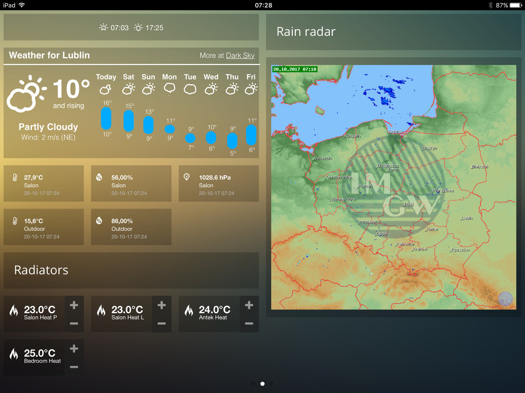

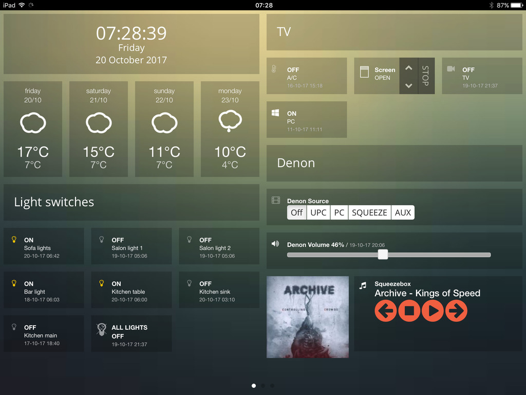

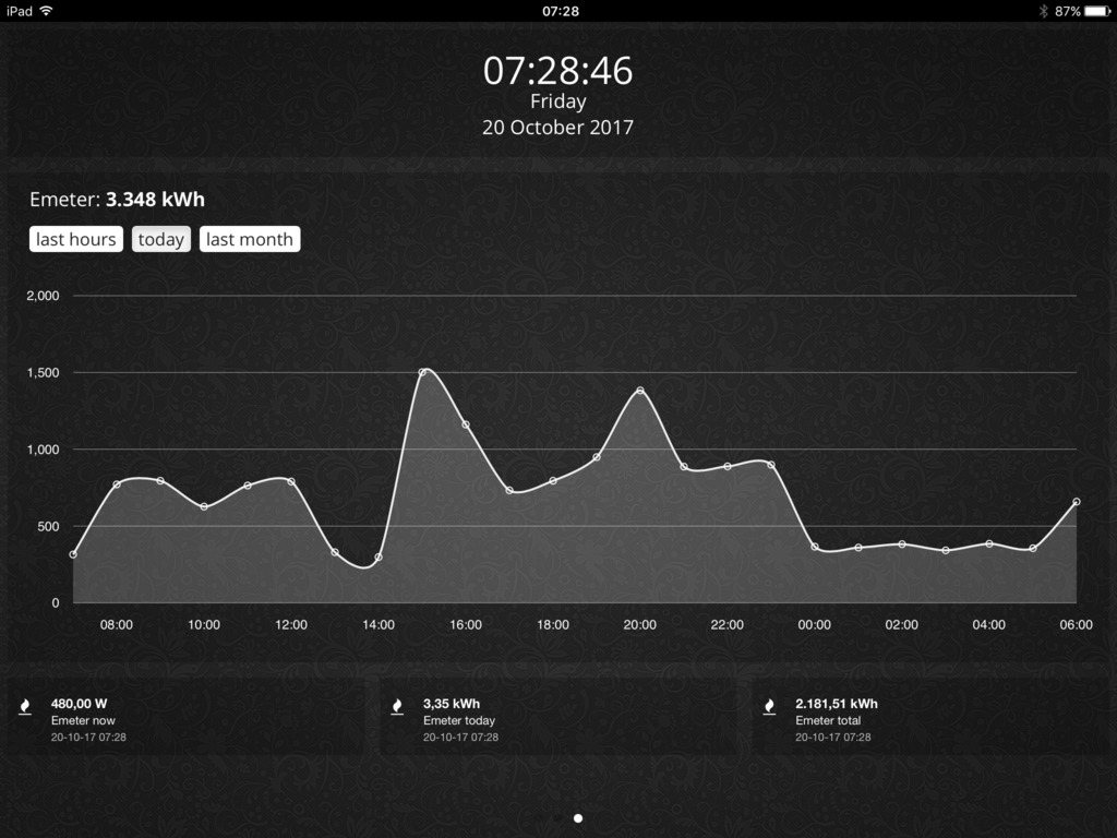

Post by landi »
My Dashticz panel on old iPad:
Actual HW setup:
- Logitech squeezebox
- Netatmo weather station
- Denon AVR
- Broadlink RM2 Pro (for sending RF and IR codes)
- LightwaveRF switches
- RFXCOM 433 (controlling RF and lightwave)
- USB Zwave controller
- Danfoss radiator valves (Z-wave)
- INODE (inode.pl) electricity meter + inode LAN
custom.css:
CUSTOM CSS FILE
.transbg.col-xs-8 {
padding-top: 15px;
padding-bottom: 15px;
border: 7px solid rgba(255,255,255,0);
background: rgba(0,0,0,0.2);
height: 160px; !important;
background-clip: padding-box;
.fa.fa-arrow-circle-left.fa-small {
font-size: 50px !important;
.fa.fa-stop-circle.fa-small {
.fa.fa-play-circle.fa-small {
.fa.fa-arrow-circle-right.fa-small {

CONFIG.js:
var config = {}
config['domoticz_ip'] = 'http://xx.xx.xx.xx:8080';
config['default_news_url'] = 'http://www.nu.nl/rss/algemeen';
config['news_scroll_after'] = '7';
config['standby_after'] = 0;
config['auto_swipe_back_to'] = 1;
config['auto_swipe_back_after'] = '15';
config['auto_slide_pages'] = 0;
config['slide_effect'] = 'slide';
config['standard_graph'] = 'day';
config['language'] = 'en_US';
config['timeformat'] = 'DD-MM-YY HH:mm';
config['calendarlanguage'] = 'en_US';
config['calendarurl'] = 0;
config['boss_stationclock'] = 'RedBoss';
config['gm_api'] = 'REMOVED';
config['gm_zoomlevel'] = 3;
config['gm_latitude'] = '51.2xx';
config['gm_longitude'] = '22.5xx';
config['wu_api'] = 'REMOVED';
config['wu_city'] = 'Lublin';
config['wu_name'] = 0;
config['wu_country'] = 'PL';
config['idx_moonpicture'] = 0;
config['switch_horizon'] = 0;
config['host_nzbget'] = 0;
config['spot_clientid'] = 0;
config['sonarr_url'] = 0;
config['sonarr_apikey'] = 0;
config['sonarr_maxitems'] = 0;
config['garbage_company'] = 0;
config['garbage_icalurl'] = 0;
config['garbage_zipcode'] = 0;
config['garbage_street'] = 0;
config['garbage_housenumber'] = 0;
config['garbage_maxitems'] = 0;
config['garbage_width'] = 0;
config['selector_instead_of_buttons'] = 0;
config['auto_positioning'] = 0;
config['use_favorites'] = 1;
config['last_update'] = 1;
config['hide_off_button'] = 0;
config['hide_topbar'] = 1;
config['edit_mode'] = 0;
config['hide_seconds'] = 0;
config['hide_seconds_stationclock'] = 0;
config['use_fahrenheit'] = 0;
config['use_beaufort'] = 0;
config['translate_windspeed'] = 1;
config['static_weathericons'] = 0;
config['hide_mediaplayer'] = 0;
var blocks = {}
// Light switches
blocks[10] = {}
blocks[10]['width'] = 4; //1 to 12, remove this line if you want to use the default (4)
blocks[10]['title'] = 'Kitchen sink' //if you want change the name of switch different then domoticz
blocks[10]['icon'] = 'fa-lightbulb-o'; //if you want an other icon instead of the default, choose from: http://fontawesome.io/cheatsheet/
// blocks[10]['image'] = 'bulb_on.png'; //if you want to show an image instead if icon, place image in img/ folder
blocks[10]['switch'] = true; //if you want to switch the title and data
blocks[10]['hide_data'] = false; //if you want to hide the data of this block
blocks[10]['show_lastupdate'] = false; //if you want to show the last update specific for this block
blocks[10]['protected'] = false; //protect switching manually in Dashticz
blocks[11] = {}
blocks[11]['width'] = 4; //1 to 12, remove this line if you want to use the default (4)
blocks[11]['title'] = 'Kitchen table' //if you want change the name of switch different then domoticz
blocks[11]['icon'] = 'fa-lightbulb-o'; //if you want an other icon instead of the default, choose from: http://fontawesome.io/cheatsheet/
// blocks[11]['image'] = 'bulb_on.png'; //if you want to show an image instead if icon, place image in img/ folder
blocks[11]['switch'] = true; //if you want to switch the title and data
blocks[11]['hide_data'] = false; //if you want to hide the data of this block
blocks[11]['show_lastupdate'] = false; //if you want to show the last update specific for this block
blocks[11]['protected'] = false; //protect switching manually in Dashticz
blocks[12] = {}
blocks[12]['width'] = 4; //1 to 12, remove this line if you want to use the default (4)
blocks[12]['title'] = 'Salon light 2' //if you want change the name of switch different then domoticz
blocks[12]['icon'] = 'fa-lightbulb-o'; //if you want an other icon instead of the default, choose from: http://fontawesome.io/cheatsheet/
// blocks[12]['image'] = 'bulb_on.png'; //if you want to show an image instead if icon, place image in img/ folder
blocks[12]['switch'] = true; //if you want to switch the title and data
blocks[12]['hide_data'] = false; //if you want to hide the data of this block
blocks[12]['show_lastupdate'] = false; //if you want to show the last update specific for this block
blocks[12]['protected'] = false; //protect switching manually in Dashticz
blocks[13] = {}
blocks[13]['width'] = 4; //1 to 12, remove this line if you want to use the default (4)
blocks[13]['title'] = 'Salon light 1' //if you want change the name of switch different then domoticz
blocks[13]['icon'] = 'fa-lightbulb-o'; //if you want an other icon instead of the default, choose from: http://fontawesome.io/cheatsheet/
// blocks[13]['image'] = 'bulb_on.png'; //if you want to show an image instead if icon, place image in img/ folder
blocks[13]['switch'] = true; //if you want to switch the title and data
blocks[13]['hide_data'] = false; //if you want to hide the data of this block
blocks[13]['show_lastupdate'] = false; //if you want to show the last update specific for this block
blocks[13]['protected'] = false; //protect switching manually in Dashticz
blocks[14] = {}
blocks[14]['width'] = 4; //1 to 12, remove this line if you want to use the default (4)
blocks[14]['title'] = 'Sofa lights' //if you want change the name of switch different then domoticz
blocks[14]['icon'] = 'fa-lightbulb-o'; //if you want an other icon instead of the default, choose from: http://fontawesome.io/cheatsheet/
// blocks[14]['image'] = 'bulb_on.png'; //if you want to show an image instead if icon, place image in img/ folder
blocks[14]['switch'] = true; //if you want to switch the title and data
blocks[14]['hide_data'] = false; //if you want to hide the data of this block
blocks[14]['show_lastupdate'] = false; //if you want to show the last update specific for this block
blocks[14]['protected'] = false; //protect switching manually in Dashticz
blocks[16] = {}
blocks[16]['width'] = 4; //1 to 12, remove this line if you want to use the default (4)
blocks[16]['title'] = 'Bar light' //if you want change the name of switch different then domoticz
blocks[16]['icon'] = 'fa-lightbulb-o'; //if you want an other icon instead of the default, choose from: http://fontawesome.io/cheatsheet/
// blocks[16]['image'] = 'bulb_on.png'; //if you want to show an image instead if icon, place image in img/ folder
blocks[16]['switch'] = true; //if you want to switch the title and data
blocks[16]['hide_data'] = false; //if you want to hide the data of this block
blocks[16]['show_lastupdate'] = false; //if you want to show the last update specific for this block
blocks[16]['protected'] = false; //protect switching manually in Dashticz
blocks[17] = {}
blocks[17]['width'] = 4; //1 to 12, remove this line if you want to use the default (4)
blocks[17]['title'] = 'Kitchen main' //if you want change the name of switch different then domoticz
blocks[17]['icon'] = 'fa-lightbulb-o'; //if you want an other icon instead of the default, choose from: http://fontawesome.io/cheatsheet/
// blocks[17]['image'] = 'bulb_on.png'; //if you want to show an image instead if icon, place image in img/ folder
blocks[17]['switch'] = true; //if you want to switch the title and data
blocks[17]['hide_data'] = false; //if you want to hide the data of this block
blocks[17]['show_lastupdate'] = false; //if you want to show the last update specific for this block
blocks[17]['protected'] = false; //protect switching manually in Dashticz
blocks[85] = {}
blocks[85]['width'] = 4; //1 to 12, remove this line if you want to use the default (4)
blocks[85]['title'] = 'ALL LIGHTS OFF' //if you want change the name of switch different then domoticz
// blocks[85]['icon'] = 'fa-lightbulb-o'; //if you want an other icon instead of the default, choose from: http://fontawesome.io/cheatsheet/
blocks[85]['image'] = 'bulb_off.png'; //if you want to show an image instead if icon, place image in img/ folder
blocks[85]['switch'] = true; //if you want to switch the title and data
blocks[85]['hide_data'] = true; //if you want to hide the data of this block
blocks[85]['show_lastupdate'] = false; //if you want to show the last update specific for this block
blocks[85]['protected'] = false; //protect switching manually in Dashticz
// Denon
blocks[20] = {}
blocks[20]['width'] = 12; //1 to 12, remove this line if you want to use the default (4)
blocks[20]['title'] = 'Denon Source' //if you want change the name of switch different then domoticz
blocks[20]['icon'] = 'fa-film'; //if you want an other icon instead of the default, choose from: http://fontawesome.io/cheatsheet/
blocks[20]['switch'] = true; //if you want to switch the title and data
blocks[20]['hide_data'] = false; //if you want to hide the data of this block
blocks[20]['show_lastupdate'] = false; //if you want to show the last update specific for this block
blocks[20]['protected'] = false; //protect switching manually in Dashticz
blocks[21] = {}
blocks[21]['width'] = 12; //1 to 12, remove this line if you want to use the default (4)
blocks[21]['title'] = 'Denon Volume' //if you want change the name of switch different then domoticz
blocks[21]['icon'] = 'fa-volume-up'; //if you want an other icon instead of the default, choose from: http://fontawesome.io/cheatsheet/
blocks[21]['switch'] = true; //if you want to switch the title and data
blocks[21]['hide_data'] = false; //if you want to hide the data of this block
blocks[21]['show_lastupdate'] = false; //if you want to show the last update specific for this block
blocks[21]['protected'] = false; //protect switching manually in Dashticz
// RM2 switches
blocks[39] = {}
blocks[39]['width'] = 4; //1 to 12, remove this line if you want to use the default (4)
blocks[39]['title'] = 'A/C' //if you want change the name of switch different then domoticz
blocks[39]['icon'] = 'fa-thermometer-3'; //if you want an other icon instead of the default, choose from: http://fontawesome.io/cheatsheet/
// blocks[39]['image'] = 'fan_on.png'; //if you want to show an image instead if icon, place image in img/ folder
blocks[39]['switch'] = true; //if you want to switch the title and data
blocks[39]['hide_data'] = false; //if you want to hide the data of this block
blocks[39]['show_lastupdate'] = false; //if you want to show the last update specific for this block
blocks[39]['protected'] = false; //protect switching manually in Dashticz
blocks[40] = {}
blocks[40]['width'] = 4; //1 to 12, remove this line if you want to use the default (4)
blocks[40]['title'] = 'Screen' //if you want change the name of switch different then domoticz
blocks[40]['icon'] = 'fa-television'; //if you want an other icon instead of the default, choose from: http://fontawesome.io/cheatsheet/
// blocks[40]['image'] = 'fa-eye.png'; //if you want to show an image instead if icon, place image in img/ folder
blocks[40]['switch'] = true; //if you want to switch the title and data
blocks[40]['hide_data'] = false; //if you want to hide the data of this block
blocks[40]['show_lastupdate'] = false; //if you want to show the last update specific for this block
blocks[40]['protected'] = false; //protect switching manually in Dashticz
blocks[41] = {}
blocks[41]['width'] = 4; //1 to 12, remove this line if you want to use the default (4)
blocks[41]['title'] = 'TV' //if you want change the name of switch different then domoticz
blocks[41]['icon'] = 'fa-video-camera'; //if you want an other icon instead of the default, choose from: http://fontawesome.io/cheatsheet/
// blocks[41]['image'] = 'tv.png'; //if you want to show an image instead if icon, place image in img/ folder
blocks[41]['switch'] = true; //if you want to switch the title and data
blocks[41]['hide_data'] = false; //if you want to hide the data of this block
blocks[41]['show_lastupdate'] = false; //if you want to show the last update specific for this block
blocks[41]['protected'] = false; //protect switching manually in Dashticz
blocks[19] = {}
blocks[19]['width'] = 4; //1 to 12, remove this line if you want to use the default (4)
blocks[19]['title'] = 'PC' //if you want change the name of switch different then domoticz
blocks[19]['icon'] = 'fa-windows'; //if you want an other icon instead of the default, choose from: http://fontawesome.io/cheatsheet/
// blocks[19]['image'] = 'tv.png'; //if you want to show an image instead if icon, place image in img/ folder
blocks[19]['switch'] = true; //if you want to switch the title and data
blocks[19]['hide_data'] = false; //if you want to hide the data of this block
blocks[19]['show_lastupdate'] = false; //if you want to show the last update specific for this block
blocks[19]['protected'] = false; //protect switching manually in Dashticz
// Squeezebox
blocks[44] = {}
blocks[44]['width'] = 8; //1 to 12, remove this line if you want to use the default (4)
blocks[44]['title'] = 'Squeezebox' //if you want change the name of switch different then domoticz
blocks[44]['icon'] = 'fa-music'; //if you want an other icon instead of the default, choose from: http://fontawesome.io/cheatsheet/
// blocks[44]['image'] = 'tv.png'; //if you want to show an image instead if icon, place image in img/ folder
blocks[44]['switch'] = true; //if you want to switch the title and data
blocks[44]['hide_data'] = false; //if you want to hide the data of this block
blocks[44]['show_lastupdate'] = false; //if you want to show the last update specific for this block
blocks[44]['protected'] = false; //protect switching manually in Dashticz
// NetAtmo
blocks[49] = {}
blocks[49]['width'] = 4; //1 to 12, remove this line if you want to use the default (4)
blocks[49]['title'] = 'Outdoor' //if you want change the name of switch different then domoticz
blocks[49]['icon'] = 'fa-thermometer-3'; //if you want an other icon instead of the default, choose from: http://fontawesome.io/cheatsheet/
// blocks[49]['image'] = 'tv.png'; //if you want to show an image instead if icon, place image in img/ folder
blocks[49]['switch'] = true; //if you want to switch the title and data
blocks[49]['hide_data'] = false; //if you want to hide the data of this block
blocks[49]['show_lastupdate'] = false; //if you want to show the last update specific for this block
blocks[49]['protected'] = false; //protect switching manually in Dashticz
blocks[50] = {}
blocks[50]['width'] = 4; //1 to 12, remove this line if you want to use the default (4)
blocks[50]['title'] = 'Salon' //if you want change the name of switch different then domoticz
blocks[50]['icon'] = 'fa-thermometer-3'; //if you want an other icon instead of the default, choose from: http://fontawesome.io/cheatsheet/
// blocks[50]['image'] = 'tv.png'; //if you want to show an image instead if icon, place image in img/ folder
blocks[50]['switch'] = false; //if you want to switch the title and data
blocks[50]['hide_data'] = false; //if you want to hide the data of this block
blocks[50]['show_lastupdate'] = false; //if you want to show the last update specific for this block
blocks[50]['protected'] = false; //protect switching manually in Dashticz
// Danfoss Radiators
blocks[55] = {}
blocks[55]['width'] = 4; //1 to 12, remove this line if you want to use the default (4)
blocks[55]['title'] = 'Salon Heat P' //if you want change the name of switch different then domoticz
blocks[55]['switch'] = true; //if you want to switch the title and data
blocks[55]['hide_data'] = false; //if you want to hide the data of this block
blocks[55]['show_lastupdate'] = false; //if you want to show the last update specific for this block
blocks[55]['protected'] = false; //protect switching manually in Dashticz
blocks[57] = {}
blocks[57]['width'] = 4; //1 to 12, remove this line if you want to use the default (4)
blocks[57]['title'] = 'Salon Heat L' //if you want change the name of switch different then domoticz
blocks[57]['switch'] = true; //if you want to switch the title and data
blocks[57]['hide_data'] = false; //if you want to hide the data of this block
blocks[57]['show_lastupdate'] = false; //if you want to show the last update specific for this block
blocks[57]['protected'] = false; //protect switching manually in Dashticz
blocks[64] = {}
blocks[64]['width'] = 4; //1 to 12, remove this line if you want to use the default (4)
blocks[64]['title'] = 'Antek Heat' //if you want change the name of switch different then domoticz
blocks[64]['switch'] = true; //if you want to switch the title and data
blocks[64]['hide_data'] = false; //if you want to hide the data of this block
blocks[64]['show_lastupdate'] = false; //if you want to show the last update specific for this block
blocks[64]['protected'] = false; //protect switching manually in Dashticz
blocks[66] = {}
blocks[66]['width'] = 4; //1 to 12, remove this line if you want to use the default (4)
blocks[66]['title'] = 'Bedroom Heat' //if you want change the name of switch different then domoticz
blocks[66]['switch'] = true; //if you want to switch the title and data
blocks[66]['hide_data'] = false; //if you want to hide the data of this block
blocks[66]['show_lastupdate'] = false; //if you want to show the last update specific for this block
blocks[66]['protected'] = false; //protect switching manually in Dashticz
// Blocktitles
blocks['blocktitle_1'] = {}
blocks['blocktitle_1']['title'] = 'Light switches';
blocks['blocktitle_2'] = {}
blocks['blocktitle_2']['title'] = 'Denon';
blocks['blocktitle_3'] = {}
blocks['blocktitle_3']['type'] = 'blocktitle';
blocks['blocktitle_3']['title'] = 'TV';
blocks['blocktitle_4'] = {}
blocks['blocktitle_4']['title'] = 'Rain radar';
blocks['blocktitle_6'] = {}
blocks['blocktitle_6']['type'] = 'blocktitle';
blocks['blocktitle_6']['title'] = 'Radiators';
// Buttons
var buttons = {}
buttons.buienradar = {width:12, isimage:true, refreshimage:60000, image: 'http://strony.toya.net.pl/~rybar/met/img/radar-map.png', url: 'http://strony.toya.net.pl/~rybar/met/img/radar-map.png'}
// Frames
var frames = {}
frames.squeeze = {height:160,frameurl:"http://xxx.xxx.xxx.xxx:8080/dashticz_v2 ... g",width:4}
frames.weather = {refreshiframe:10000,height:230,frameurl:"//forecast.io/embed/#lat=51.2516&lon=22.5619&name=Lublin&color=#00aaff&font=Helvetica&fontcolor=#ffffff&units=si&text-color=#fff",width:12}
// Columns
var columns = {}
columns[1] = {}
columns[1]['blocks'] = ['clock','weather','blocktitle_1',14,13,12,16,11,10,17,85];
// columns[1]['blocks'] = ['clock',frames.weather,'blocktitle_1',14,13,12,16,11,10,17];
columns[1]['width'] = 6;
columns[2] = {}
columns[2]['blocks'] = ['blocktitle_3',39,40,41,19,'blocktitle_2',20,21,frames.squeeze,44]
columns[2]['width'] = 6;
columns[3] = {}
//columns[3]['blocks'] = ['clock','sunrise','currentweather_big',50,49]
columns[3]['blocks'] = ['sunrise',frames.weather,50,49,'blocktitle_6',55,57,64,66] /
columns[3]['width'] = 6;
columns[4] = {}
columns[4]['blocks'] = ['blocktitle_4',buttons.buienradar]
columns[4]['width'] = 6;
columns[5] = {}
columns[5]['blocks'] = ['clock','graph_9',9] // show clock and e-meter graph for electricity usage
columns[5]['width'] = 12;
// Screens
var screens = {}
screens[1] = {}
screens[1]['background'] = 'bg2.jpg';
screens[1]['columns'] = [1,2]
screens[2] = {}
screens[2]['background'] = 'bg3.jpg';
screens[2]['columns'] = [3,4]
screens[3] = {}
screens[3]['background'] = 'bg4.jpg';
screens[3]['columns'] = [5]
crontab:
# m h dom mon dow command
* * * * * /opt/domoticz/scripts/denon.sh 2>&1
* * * * * wget -q -O /tmp/cover.jpg "http://xx.xx.xx.xx:9000/music/current/c ... 0:xx:xx:xx" && convert -resize 160X160 /tmp/cover.jpg /opt/domoticz/www/dashticz_v2/img/cover.jpg
@reboot python /opt/domoticz/INODE/inode.py &

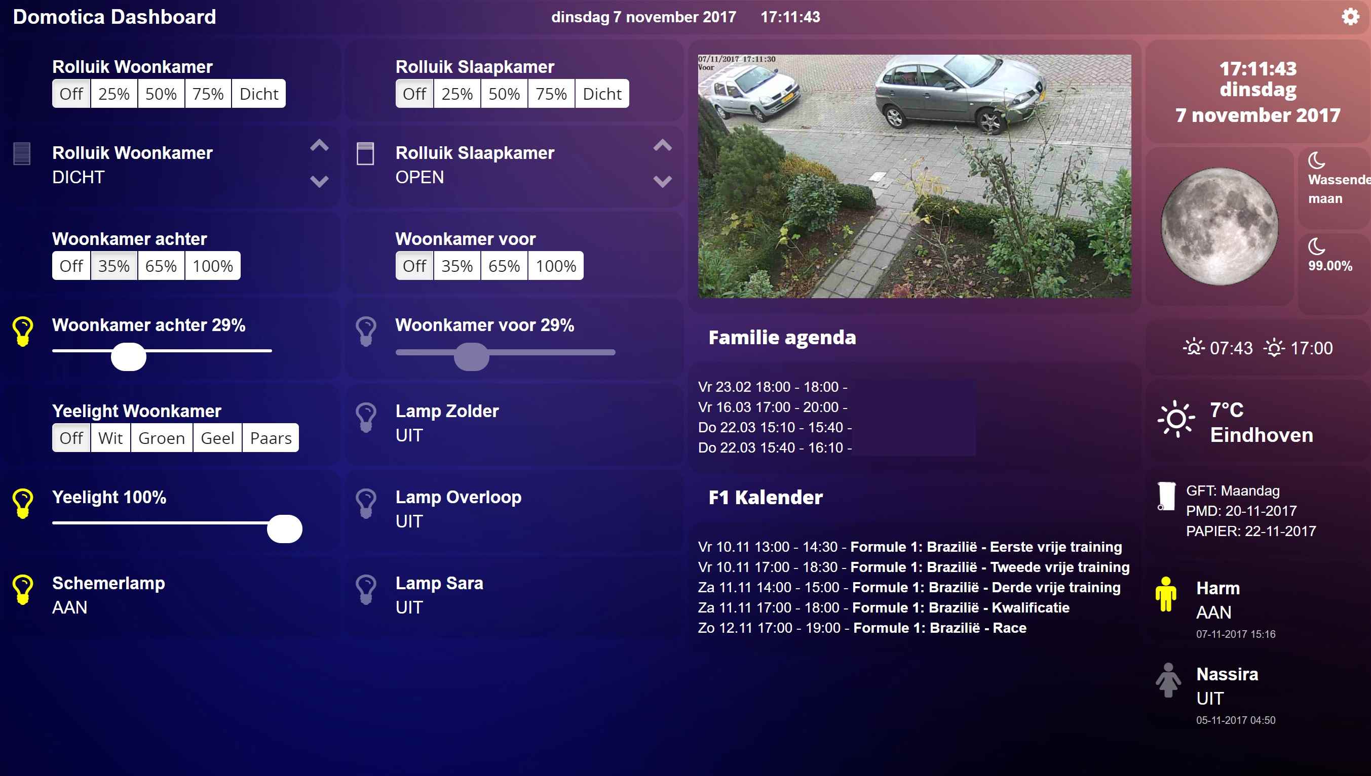

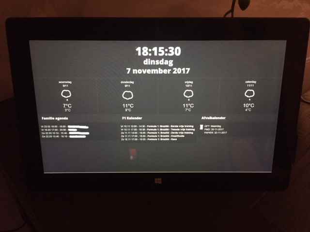

I like a as simple as possible dashboard. I have tried several setups, but wasn't sattisfied.
After I choose for a Microsoft Surface RT tablet to use as the dashboard, I've started all over to fit the important buttons on the screen.
I came to the conclusion that buttons have to be simple and kids (wife) proof. This is my new simplified dashboard.
config.JS
var config = {}
config['domoticz_ip'] = 'http://192.168.0.100:8088';
config['app_title'] = 'Domotica Dashboard';
config['default_news_url'] = 'https://cors-anywhere.herokuapp.com/http://www.nu.nl/rss';
config['standby_after'] = 15;
config['auto_swipe_back_after'] = 0;
config['auto_slide_pages'] = 0;			//set _AUTO_SWIPEBACK_TIME = 0
config['standard_graph'] = 'hours';
config['language'] = 'nl_NL';
config['timeformat'] = 'DD-MM-YYYY HH:mm';
config['gm_api'] = 0;
config['gm_zoomlevel'] = 0;
config['gm_latitude'] = 0;
config['gm_longitude'] = 0;
config['wu_api'] = '--APIKEY--;
config['wu_city'] = 'Eindhoven';
config['wu_country'] = 'NL';
config['idx_moonpicture'] = '7';
config['garbage_company'] = 'cure';
config['garbage_zipcode'] = '--POSTCODE--';
config['garbage_street'] = '--ADRES--';
config['garbage_housenumber'] = '--HUISNUMMER--';
config['garbage_maxitems'] = '6';
config['selector_instead_of_buttons'] = 1;
config['use_favorites'] = 0;
config['last_update'] = 0;
config['hide_topbar'] = 0;
config['selector_instead_of_buttons'] = 0;	//use for selectors
config['hide_off_button'] = 0; //use for selectors
// Garbage - Advanced Settings
var _DO_NOT_USE_COLORED_TRASHCAN 	= true;
var trashcan = {}
var trashnames = {}
trashnames['Pmd bennekel blaarthem'] = 'PMD';
trashnames['Papier en karton'] = 'PAPIER';
trashnames['Gft'] = 'GFT'
//var trashcolors = {}
//trashcolors['Pmd bennekel blaarthem'] = 'Yellow';
//trashcolors['Papier en karton'] = 'Blue'
//trashcolors['Gft'] = 'Green';
// iCalendar Plugin, supports all .ics calendar types like Google Calendar, Apple Calendar
var _ICALENDAR_URL			= 'https://testurl.com/ical.ics'; //supports .ics type calendars (Google Calendar, Apple Calendar etc.)
var _ICALENDAR_DATEFORMAT	= 'DD-MM-YYYY | HH:mm'; //'friendly', 'MM.DD.YYYY HH:mm', 'DD.MM.YYYY HH:mm', 'YYYY.MM.DD HH:mm'
var _ICALENDAR_LOCALE		= 'nl'; //en,hu, etc.
// Calendar
var calendars = {}
calendars.f1 = {maxitems: 5, title:'', image:'', icalurl:'--F1 CALENDAR URL--'}
calendars.prive = {maxitems: 5, title: '', image: '', --PRIVATE CALENDAR URL--'}
// Online Radio Stream Plugin, Note: you must enable plugin in column section 'streamplayer'
var _STREAMPLAYER_TRACKS     = [
   {"track":1,"name":"100%NL","file":"http://stream.100p.nl/100pctnl.mp3"},
   {"track":2,"name":"Radio 538","file":"http://vip-icecast.538.lw.triple-it.nl/RADIO538_MP3"},
   {"track":3,"name":"Arrow Classic Rock","file":"http://www.garnierstreamingmedia.com/asx/streamerswitch.asp?stream=205"},
   {"track":4,"name":"Radio Veronica","file":"http://live.icecast.kpnstreaming.nl/skyradiolive-SRGSTR09.mp3"},
   {"track":5,"name":"Q-music","file":"http://live.icecast.kpnstreaming.nl/omroepbrabantlive-OmroepBrabantHq.m3u"},
var buttons = {}
buttons.moon = {width:8, isimage:true, refreshimage:60000, image: 'moon'}
buttons.cam_voor = { width:12, isimage:true, refresh:2000, image: '--CAMERA URL--', url: '--CAMERA URL--' }
//CUSTOM POSITIONING:
//defining wich blocks to show, de numbers represents the IDX of the device in Domoticz
//only define if you want to use a custom width instead of the default
var blocks = {}
//Schakelaars
blocks[226] = {} //Rolluik woonkamer - Selector
blocks[226]['title'] = 'Rolluik Woonkamer';
blocks[226]['width'] = 12;
blocks[226]['icon'] = ''
blocks[225] = {} //Rolluik slaapkamer - Selector
blocks[225]['title'] = 'Rolluik Slaapkamer';
blocks[225]['width'] = 12;
blocks[225]['icon'] = ''
blocks[6] = {} //Rolluik woonkamer
blocks[6]['width'] = 12;
blocks[6]['hide_stop'] = true;
blocks[6]['hide_data'] = false;
blocks[6]['icon'] = 'fa-align-justify';
blocks[217] = {} //Rolluik slaapkamer
blocks[217]['width'] = 12;
blocks[217]['hide_stop'] = true;
blocks[217]['hide_data'] = false;
blocks[217]['icon'] = 'fa-align-justify';
blocks[461] = {} //Woonkamer achter - Selector
blocks[461]['title'] = 'Woonkamer achter';
blocks[461]['icon'] = ''
blocks[461]['width'] = 12;
blocks[179] = {} //Woonkamer achter
blocks[179]['title'] = 'Woonkamer achter';
blocks[179]['width'] = 12;
blocks[193] = {} //Woonkamer voor
blocks[193]['title'] = 'Woonkamer voor';
blocks[193]['width'] = 12;
blocks[462] = {} //Woonkamer voor - Selector
blocks[462]['title'] = 'Woonkamer voor';
blocks[462]['icon'] = ''
blocks[462]['width'] = 12;
blocks[443] = {} //Schemerlamp woonkamer
blocks[443]['title'] = 'Schemerlamp';
blocks[443]['width'] = 12;
blocks[463] = {} //Overloop
blocks[463]['title'] = 'Lamp Overloop';
blocks[463]['width'] = 12;
blocks[464] = {} //Zolder
blocks[464]['title'] = 'Lamp Zolder';
blocks[464]['width'] = 12;
blocks[213] = {} //Yeelight Huiskamer
blocks[213]['title'] = 'Yeelight';
blocks[213]['width'] = 12;
blocks[214] = {} //Yeelight RGBW
blocks[214]['title'] = 'Yeelight Woonkamer';
blocks[214]['icon'] = ''
blocks[214]['width'] = 12;
blocks[452] = {} //Schemerlamp - Sara
blocks[452]['title'] = 'Lamp Sara';
blocks[452]['width'] = 12;
//Overige
blocks[150] = {} //iPhone Harm
blocks[150]['width'] = 12;
blocks[150]['icon'] = 'fa-male'
blocks[150]['show_lastupdate'] = true;
blocks[150]['protected'] = true;
blocks[150]['playsound'] = 'sounds/sonar.mp3';
blocks[150]['title'] = 'Harm'
blocks[153] = {} //iPhone Nassira
blocks[153]['width'] = 12;
blocks[153]['icon'] = 'fa-female'
blocks[153]['show_lastupdate'] = true;
blocks[153]['protected'] = true;
blocks[153]['playsound'] = 'sounds/sonar.mp3';
blocks[153]['title'] = 'Nassira'
blocks[211] = {} //Maanphase
blocks[211]['width'] = 4;
blocks[211]['title'] = ''
blocks[211]['icon'] = 'fa-moon-o'
blocks[208] = {} //Maanpercentage
blocks[208]['width'] = 4;
blocks[208]['title'] = ''
blocks[208]['icon'] = 'fa-moon-o'
//Block Titles
blocks['blocktitle_1']['title'] = 'Familie agenda';
blocks['blocktitle_2']['title'] = 'F1 Kalender';
blocks['blocktitle_3']['title'] = 'Afvalkalender';
//Empty Block
blocks['blocktitle_4']['title'] = '';
//blocks[1] = {}
//blocks[1]['width'] = 4; 						// 1 to 12, remove this line if you want to use the default (4)
//blocks[1]['title'] = 'Living room' 				// if you want change the name of switch different then domoticz
//blocks[1]['icon'] = 'fa-eye'; 					// if you want an other icon instead of the default, choose from: http://fontawesome.io/cheatsheet/
//blocks[1]['image'] = 'bulb_off.png'; 				// if you want to show an image instead if icon, place image in img/ folder
//blocks[1]['switch'] = true;						// if you want to switch title and data
//blocks[1]['hide_data'] = true; 					// if you want to hide the data of this block
//blocks[1]['show_lastupdate'] = true;				// show lastupdate time from device (per device)
//blocks[1]['protected'] = true;					// make switch protected (no actions on push)
//blocks[1]['playsound'] = 'sounds/sonar.mp3';		// play sound
var columns = {}
columns[1] = {}
columns[1]['blocks'] = [226,6,461,179,214,213,443]
columns[1]['width'] = 3;
columns[2] = {}
columns[2]['blocks'] = [225,217,462,193,464,463,452]
columns[2]['width'] = 3;
columns[3] = {}
columns[3]['blocks'] = [buttons.cam_voor, 'blocktitle_1',calendars.prive,'blocktitle_2',calendars.f1]
columns[3]['width'] = 4;
columns[4] = {}
columns[4]['blocks'] = ['clock', buttons.moon, 211, 208, 'sunrise','currentweather_big','garbage',150,153]
columns[4]['width'] = 2;
//TOP Bar
//columns['bar'] = {}
//columns['bar']['blocks'] = ['logo','miniclock','settings']
//Standby Screen
var columns_standby = {}
columns_standby[1] = {}
columns_standby[1]['blocks'] = ['clock','weather']
columns_standby[1]['width'] = 12
columns_standby[2] = {}
columns_standby[2]['blocks'] = ['blocktitle_1',calendars.prive]
columns_standby[2]['width'] = 4
columns_standby[3] = {}
columns_standby[3]['blocks'] = ['blocktitle_2',calendars.f1]
columns_standby[3]['width'] = 4
columns_standby[4] = {}
columns_standby[4]['blocks'] = ['blocktitle_3','blocktitle_4','garbage']
columns_standby[4]['width'] = 4
//Screens & Background
var screens = {}
screens[1] = {}
screens[1]['background'] = 'dv2-bg10.jpg';
screens[1]['columns'] = [1,2,3,4]
custom.css
CUSTOM CSS FILE
/* Modifications Top Bar */
.transbg.dark.col-xs-1,
.transbg.dark.col-xs-2,
.transbg.dark.col-xs-3,
.transbg.dark.col-xs-4,
.transbg.dark.col-xs-5,
.transbg.dark.col-xs-6,
.transbg.dark.col-xs-7,
.transbg.dark.col-xs-8,
.transbg.dark.col-xs-9,
.transbg.dark.col-xs-10,
.transbg.dark.col-xs-11,
.transbg.dark.col-xs-12 {
    border: 3px solid rgba(255,255,255,0);		/* 7px solid rgba(255,255,255,0); */
    background: rgba(0,0,0,0.1);				/* rgba(0,0,0,0.5); */
/* Modifications for the currentweather_big block */
.big .weatherdegrees, .big .weatherloc {
    display: inline-block;
    margin-top: -4px;		/* default -2px */
	margin-left: 24px;		/* move text to the right */
    font-size: 20px;
    font-weight: bold;
.skyconsmall {
    display: block;
	width: 75px;			/* default 100% - make icon smaller */
    max-width: 125px;
    font-size: 15px;
	margin-left: -30px;		/* move icon to the right */
/* Modification for Moonphase and Moon %*/
.block_208,					/* Moonphase */
.block_211 {  				/* Moon % */
	font-size: 13px !important;
/* Modifications to the fa en wi font family*/
.fa.fa-lightbulb-o.on {
	color: rgba(255,255,0,1.0);
	font-size: 35px !important;
	margin-top: 1px;
	margin-left: 1px;
.fa.fa-lightbulb-o.off {
    color:#fff;
	margin-top: 1px;
	margin-left: 1px;
.fa.fa-male.on.icon,
.fa.fa-female.on.icon {
.fa.fa-male.off.icon,
.fa.fa-female.off.icon {
.fa.fa-moon-o {
    margin-top: -12px !important;		/* Move icon to the top */
    font-size: 20px !important;
    display: block;						/* Needed to get margin-top to work */
/* Fontsize buttons Blinds */
.fa,.wi {
/* Sunrise & Sunset icon */
.wi.wi-sunrise,
.wi.wi-sunset {
/* Fontsize Sunrise & Sunset */
.sunriseholder,
.sunriseholder .wi {
    font-size: 17px !important;
/* Background blocks */
.transbg.col-xs-1,
.transbg.col-xs-2,
.transbg.col-xs-3,
.transbg.col-xs-4,
.transbg.col-xs-5,
.transbg.col-xs-6,
.transbg.col-xs-7,
.transbg.col-xs-8,
.transbg.col-xs-9,
.transbg.col-xs-10,
.transbg.col-xs-11,
.transbg.col-xs-12 {
	padding-top:15px;
	padding-bottom:15px;
	border: 2px solid rgba(255,255,255,0);		/* border: 7px -> 3px - Smaller space between blocks */
	background: rgba(0,0,0,0.1);				/* rgba(0,0,0,0.1); -> 0,0,0,0 makes transparent */
	border-radius: 15px;						/* Round corners */
.transbg.col-xs-1.hover:hover,
.transbg.col-xs-2.hover:hover,
.transbg.col-xs-3.hover:hover,
.transbg.col-xs-4.hover:hover,
.transbg.col-xs-5.hover:hover,
.transbg.col-xs-6.hover:hover,
.transbg.col-xs-7.hover:hover,
.transbg.col-xs-8.hover:hover,
.transbg.col-xs-9.hover:hover,
.transbg.col-xs-10.hover:hover,
.transbg.col-xs-11.hover:hover,
.transbg.col-xs-12.hover:hover {
	padding-top:15px;
	background: rgba(255,255,255,0.1);
	cursor:pointer;
/* Height of the blocktitles and center text in new height */
div.mh.titlegroups {
    height: 20px !important;
    padding-top: 3px !important;
	background: rgba(0,0,0,0);
.col-xs-12.mh.titlegroups.transbg {
	height: 0px;
/* Text size in blocks */
div.screen {
    -webkit-background-size: cover;
    -moz-background-size: cover;
    -o-background-size: cover;
    background-position: center;
    color: white;
    font-size: 12.5px !important;				/* default 10px - 12.5px */
/* Text behind icon in blocks */
.col-xs-10 {
  width: 73%;		/* overrule bootstrap.css - width: 83,33333% */
/* Block Title */
h1, h2, h3, h4, h5, h6 {
    font-family: 'Open Sans', 'Helvetica Neue', Arial, sans-serif;
    margin: 0px;
    margin-left: 15px;
    font-weight: 900;
    font-size: 150%;
/* Standby screen */
.standby .clock{
   font-size:60px !important;
.standby .weekday,.standby .date{
   font-size:40px !important;
/* Transparent Background for arrow Blinds - Big Screen */
.input-groupBtn.input-chevron .btn-number {
    padding: 5px 10px 5px 10px;
    background-color: transparent;
/* Transparent Background for arrow Blinds - Small Screen */
@media only screen and (max-width: 1400px) {
		padding: 7px 10px 7px 10px;
/* Trashcan text modification */
.trash .state div.trashrow {
    font-size: 14px;
.trash .state div.trashtoday {
    font-size: 18px;
.trash .state div.trashtomorrow {
    font-size: 14px;
.trashcan {
    height: 30px;
    width: 30px;
/* Modified sliders for the dimmers */
.block_179 .ui-slider-handle,
.block_193 .ui-slider-handle,
.block_213 .ui-slider-handle {
    border-radius: 25px;
    height: 28px;
    width: 35px;
	padding: 6px 10px 6px 10px;
	background-color: rgb(126,119,166);
	border-color: rgb(126,119,166);
.block_179 .ui-slider-horizontal,
.block_193 .ui-slider-horizontal,
.block_213 .ui-slider-horizontal {
    border-color: transparent;
    height: 6px;
	bottom: -5px;
	margin-left: 10px;
.slider-on .ui-slider-handle {
    background-color: #fff;
    border-color:  #fff;
.slider-on .ui-slider-horizontal{
	border-color:transparent;
	height: 3px;
/* Scrollbar - Anywhere on the dashboard */
::-webkit-scrollbar {
    width: 1px;									/* Small vertical scrollbar */
    background-color: transparent !important;	/* Scrollbar transparent */
/* Location Buttons in Blocks */
.block_213 .btn-group, .block_214 .btn-group-vertical,
.block_214 .btn-group, .block_214 .btn-group-vertical,
.block_225 .btn-group, .block_225 .btn-group-vertical,
.block_226 .btn-group, .block_226 .btn-group-vertical,
.block_443 .btn-group, .block_443 .btn-group-vertical,
.block_461 .btn-group, .block_461 .btn-group-vertical,
.block_462 .btn-group, .block_462 .btn-group-vertical {
    position: fixed;
    vertical-align: middle;
	margin-left: 10px !important;
/* Large Font for Block Titles */
.block_6 .title,
.block_150 .title,
.block_153 .title,
.block_179 .title,
.block_193 .title,
.block_213 .title,
.block_214 .title,
.block_217 .title,
.block_225 .title,
.block_226 .title,
.block_443 .title,
.block_452 .title,
.block_461 .title,
.block_462 .title,
.block_463 .title,
.block_464 .title {
/* Large Font for Block Status */
.block_6 .state,
.block_150 .state,
.block_153 .state,
.block_179 .state,
.block_193 .state,
.block_213 .state,
.block_217 .state,
.block_443 .state,
.block_452 .state,
.block_463 .state,
.block_464 .state {
/* Position Last Update Text */
.block_150 .lastupdate,
.block_153 .lastupdate {
/* Font Size Calendar Items */
.col-xs-12.transbg.containsicalendar {
	font-size: 14px !important;
/* END CUSTOM MODIFICATIONS */
