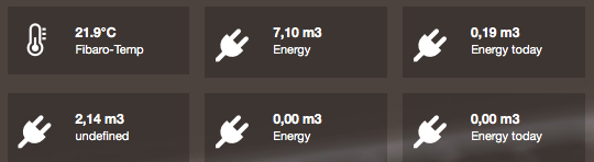

3. Is it possible to list power usage against plugs (appearing as switches currently) - that have a power consumption feature
   "AddjMulti" : 1.0,
         "AddjMulti2" : 1.0,
         "AddjValue" : 0.0,
         "AddjValue2" : 0.0,
         "BatteryLevel" : 255,
         "CustomImage" : 0,
         "Data" : "7.0 Watt",
         "Description" : "",
         "Favorite" : 1,
         "HardwareID" : 2,
         "HardwareName" : "AeonZW",
         "HardwareTypeVal" : 21,
         "HaveTimeout" : false,
         "ID" : "0000601",
         "LastUpdate" : "2017-04-04 13:16:37",
         "Name" : "Pumps-Watts",
         "Notifications" : "false",
         "PlanID" : "0",
         "PlanIDs" : [ 0 ],
         "Protected" : false,
         "ShowNotifications" : true,
         "SignalLevel" : "-",
         "SubType" : "Electric",
         "Timers" : "false",
         "Type" : "Usage",
         "TypeImg" : "current",
         "Unit" : 2,
         "Used" : 1,
         "XOffset" : "0",
         "YOffset" : "0",
         "idx" : "12"

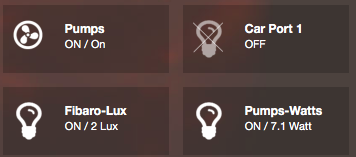

4. Would be great to have a language / location section which brings different options for Wunderground settings, radio, traffic (www.trafficengland.com) etc.
Thanks again!
Ian
Domoticz on Ubuntu 16.04 LTS VM
RFXCom USB transceiver
Aeon Labs V2 USB (Zwave)
Various HomeEasy, Oregon devices and sensors. Now using Z-Wave Fibaro FGMS-001, TKB TZ88Es
TP-Link IP310 Cameras
robgeerts
Posts: 1273
Domoticz version: 3.7067
Re: New Dashboard Design
Post by robgeerts »
whiteduck wrote: Great work - really nice - shame this isn't built in to Domoticz - perhaps this could happen?
If the developer of Domoticz wants to do this, he can contact me ;)
whiteduck wrote: Did this supersede your Dashticz project?
That was not my idea at first but it's beginning to look like it :)
whiteduck wrote: 1. Any chance of an FAQ/Readme/in-line comments that shows us how/where to modify the main.js and CONFIG.js in such a way as it is re-usable by others
Will try to do this
whiteduck wrote:
         "Data" : "13.9 C, 58 %",
         "HardwareType" : "RFXCOM - RFXtrx433 USB 433.92MHz Transceiver",
         "idx" : "189"
Works in latest version, but still in 2 separate blocks.

A few observations
The lamp socket which has power usage appears as two blocks but they are out of step (one is ON the other OFF) and you cannot switch the lamp on/off with the energy one because of course the name doesn't match the device - it matches the device-watts.
The Energy needs to be watts but is m3 like Gas.
My proposed code fix snippet is here
else if(data.result[r]['Type']=='General' && data.result[r]['SubType']=='kWh'){
                                                        var html = getStateBlock(data.result[r]['idx']+'a','fa fa-plug',lang.energy_usage,number_format(data.result[r]['Usage'],2,',','.')+' watts');
                                                        $('.states').append(html);
                                                        var html = getStateBlock(data.result[r]['idx']+'b','fa fa-plug',lang.energy_usagetoday,number_format(data.result[r]['CounterToday'],2,',','.')+' kWh');
                                                        var html = getStateBlock(data.result[r]['idx']+'c','fa fa-plug',lang.energy_totals,number_format(data.result[r]['Data'],2,',','.')+' kWh');
In this one the pump appears as a light in the energy block
Thanks - right off to Paypal I go...
