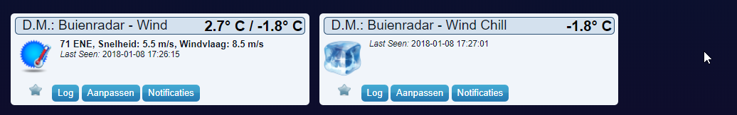

Posted: Monday 08 January 2018 17:30
by Derik
@ Edy THANKS!!!
this did the tric :-)
Got him:
And the thing i mis i think:
Thanks for the support!!
Re: Buienradar Weather Lookup Plugin
Posted: Monday 08 January 2018 20:31
by EddyG
Not completely the same:
In the Temperature tab 2 Temperature device like below.

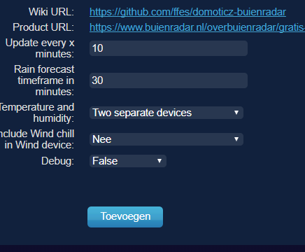

Posted: Saturday 20 January 2018 17:31
by Derik
mmm
I did a new install because there was something wrong...
Only now i get an error in the wget step:
root@odroidxu4:/home/root/domoticz/plugins# git clone https://github.com/ffes/domoticz-buienradar.git
Cloning into 'domoticz-buienradar'...
fatal: unable to access 'https://github.com/ffes/domoticz-buienradar.git/': Could not resolve host: github.com
Perhaps something changed???
