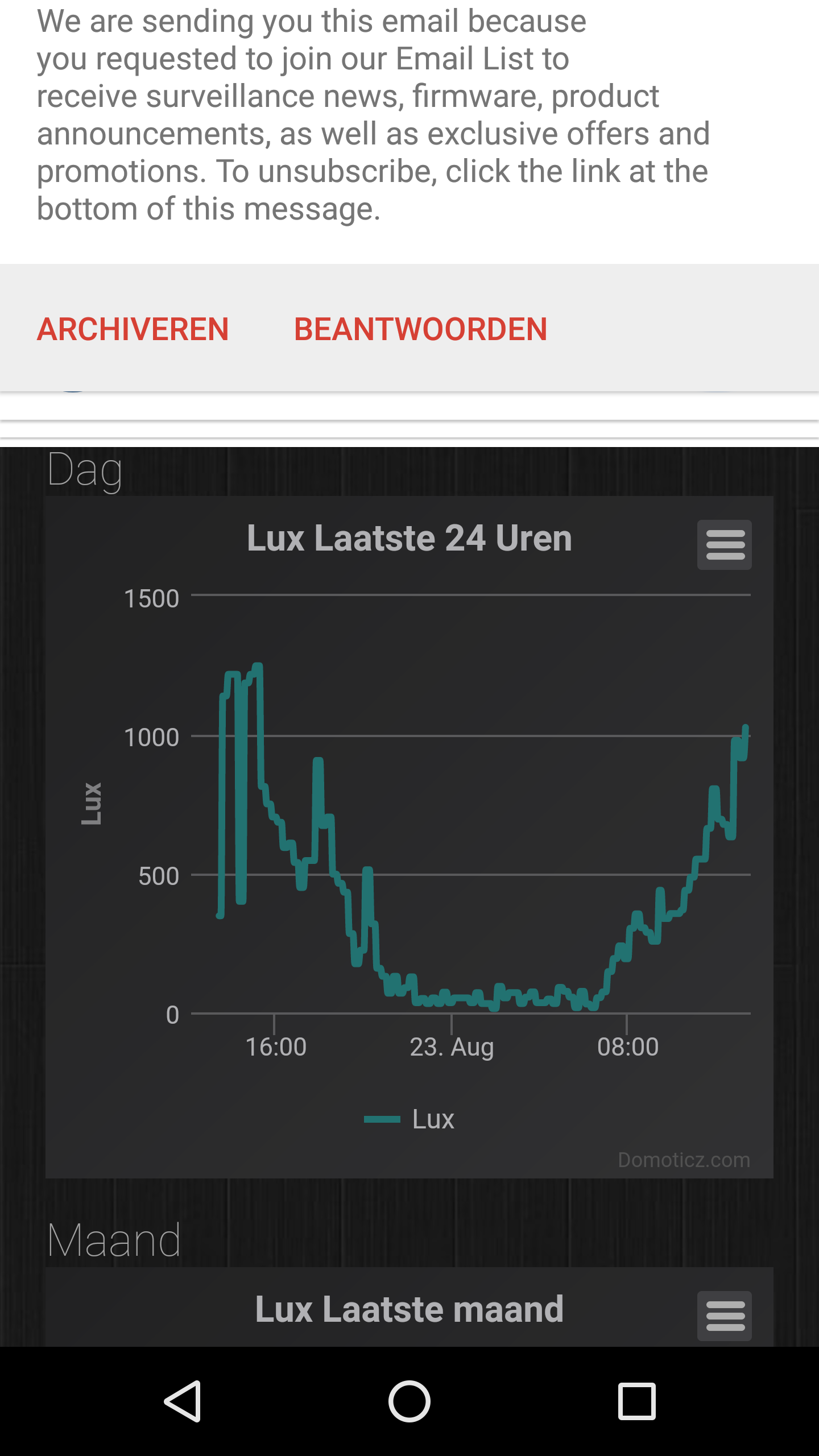

Image Image Image
tonbor wrote:two free VPN hongkong tested... Android to English, fake gps to China, time toChina VPn to hongkong still Mainland Error
LouiS22 wrote:Hi, just tested with PureVPN (yes, it's a paid one) and they still have China based server.
Verstuurd vanaf mijn SM-T813 met Tapatalk
Image Image Image Image

At last I found a free VPN mainland China...... and I manged to get the Chinese version connected. Thank for the support Image
