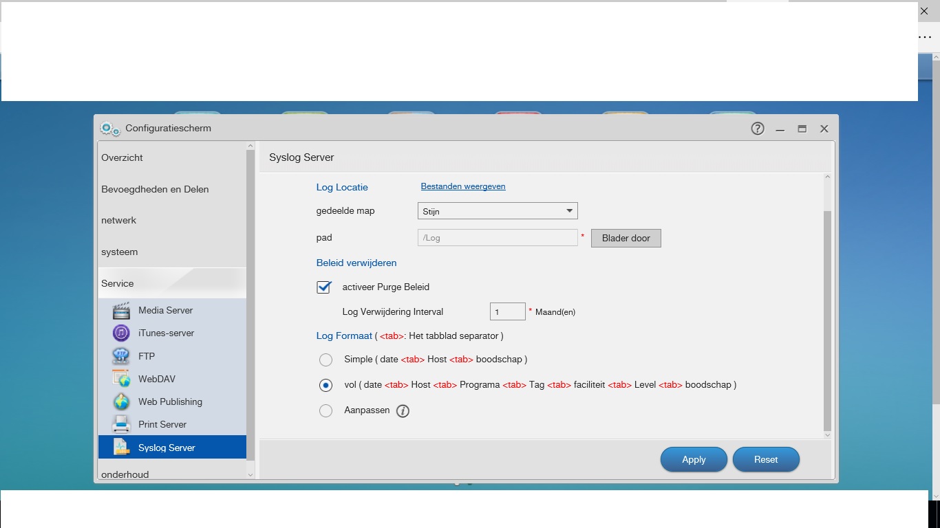

i activated syslog server of my nas but nothing is shown in here:
webserver log will be something dirrefent?
- Naamloos.jpg (120.12 KiB) Viewed 1891 times
- Egregius
- Posts: 2592
- Domoticz version: v2024.7
- Location: Beitem, BE
Re: LUA Pass2php
You'll need ssh and Google for that.
