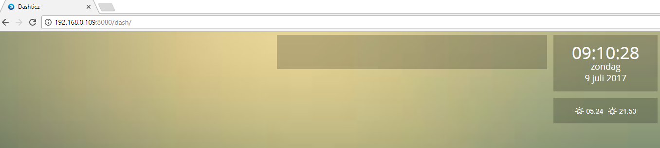

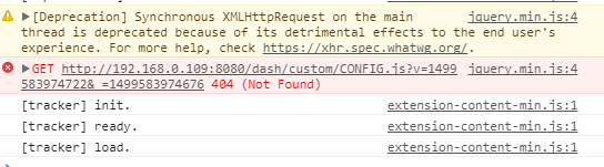

@htilburgs
I'm going crazy. Have been busy for a couple of weeks .. Dashticz stays in this way. Console reports an error.
Help me! :( :(

@mAiden88 looks like a syntax error somewhere in your CONFIG.js. Unfortunately they are difficult to uncover, IMHO and your post doesn't show the line endings.
Looks like there's no ';' after _THEME = 'default'
EDIT - replied to wrong person. Apologies. Should have been @corderoma82.

What did happen? How to fix this?
robgeerts
Posts: 1273
Domoticz version: 3.7067
Re: Dashticz doesn't work anymore
Post by robgeerts »
Beta or Master-version?
Did you enter the port? (:8080 or someting)
Could you post a screenshot of the window (including console) ?
