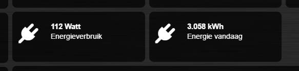

I wanna change the titles of my P1 elektra blocks blocks[274] = {} //Elektra (P1 USB) //2 blocks: '274_1' and '274_2'
Does someone know if this is possible?
Naamloos 1.jpg (7.91 KiB) Viewed 1994 times

Post by robgeerts »
Should work since beta last night....
blocks ['274_1']['title'] = 'mijntitel';

robgeerts wrote:Should work since beta last night....
Didn't work in first place but forget to split the block.
I had to add the blocks blocks ['274_1'] = {} and blocks ['274_2'] = {} first :)

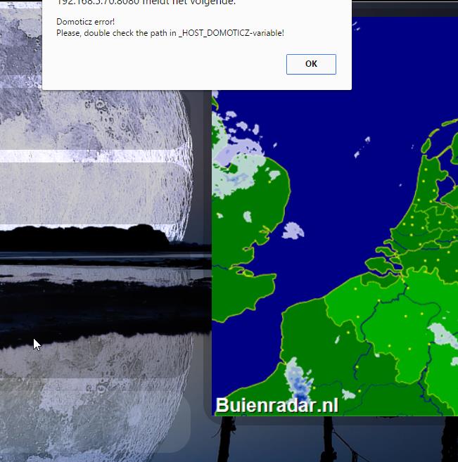

mmm
Domdbo here....
I try and try....
Looks everytime very ok
Did search wit komodo edit for errors [ founds some typo's]
Started again and again..
Only ones in a X time. some times after a hour, sometimes after ten minutes...
I get THE error:

Did have a setup with 5 screens, for my 13 inch tablet...
Started again with 2 :(
New setup all blocks and buttons..
Please some one...
Or what is the most of the time the greatest problem with this error?

Post by htilburgs »
Most of the time is that Domoticz or your RPI is too busy. I had the same problem. In my case it was python that was running from a previous Domoboard installation. It took 98% of my CPU. After killing Domoboard (I totaly forgot it was running) and removing it, my RPI came to a rest.
CPU became normal (3%), temperature went down from 50+ to 39 degree and Domoticz wasn't sluggy anymore.
Somethimes my Yeelight LUA script is running more than 10 seconds, what causes this error too.
There is a workaround on the forum (sorry, can find it right now), to handle this error (adding something to the custom.js).
Hardware:
HansieNL
Posts: 969
Post by HansieNL »
htilburgs wrote:There is a workaround on the forum (sorry, can find it right now), to handle this error (adding something to the custom.js).
You mean this one...? window.alert = function ( text ) { console.error( text ); return true; };
Blah blah blah
htilburgs
Posts: 464
Post by htilburgs »
Yop, that's the one....

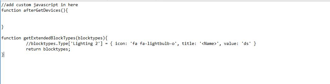

Only this in my css???
Or.. :roll: :arrow: :oops: :lol: :?
Pppffcff ....one hole. Day fior this peace of art...
Thanks guys...
htilburgs
Posts: 464
Post by htilburgs »
Not in css, in your custom.js.....;-)
Hardware:
Derik
Posts: 1605
Post by Derik »
Mmm
Thats the first time i open that part....
No virus :roll: :roll:
That do the tric??
No other settings needed??
Xxx
htilburgs
Posts: 464
Post by htilburgs »
Yip
Hardware:
Derik
Posts: 1605
Post by Derik »
mmm did place it to several places.
only did not the trick..
Where do place this script ..
Can i remove the other code here?
I did'n place this.
I will try to keep it clean
Or do i need to restart the board?
htilburgs
Posts: 464
Post by htilburgs »
I've put it here:
//add custom javascript in here
function afterGetDevices(){
function getExtendedBlockTypes(blocktypes){
	//blocktypes.Type['Lighting 2'] = { icon: 'fa fa-lightbulb-o', title: '<Name>', value: 'ds' }
	return blocktypes;
Hardware:
Derik
Posts: 1605
Post by Derik »
mmm still got the error..
