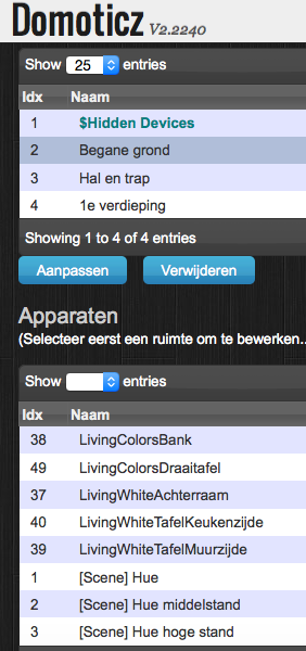

Skorpion
- Posts: 27
- Joined: Thursday 15 January 2015 9:51
I checked the IDX with JSON (DomoticzURL/json.htm?type=scenes) so they must be correct.
The only JS error I get is this one:
ReferenceError: switch_off_timeout is not defined javascript.js:220
I think my roomplan must also be ok. I added a screenshot.
- Roomplan Domoticz
- Schermafbeelding 2015-01-30 om 19.26.12.png (89.16 KiB) Viewed 3709 times
Slayer007
- Posts: 29
- Joined: Wednesday 18 June 2014 23:57
It's not only the roomplan. It also has to do with the devices you added to your roomplan. If you want all devices to work, simply add a"0" in the script. If that doesn't work you have an other problem so solve.
Skorpion
- Posts: 27
I have been using floorplan = 0 from the start, so I'm afraid it is something else.Slayer007 wrote:It's not only the roomplan. It also has to do with the devices you added to your roomplan. If you want all devices to work, simply add a"0" in the script. If that doesn't work you have an other problem so solve.

Slayer007
- Posts: 29
Now, I'm thinking I had the same problem. I had one scene and one test scene. When I call a json command both the status from the scenes appear, even if I selected one idd, they both show up. So my status wasn't correct at that time. I removed the test scene, so I had one scene over and that worked for me. I don't know what the problem there is.
