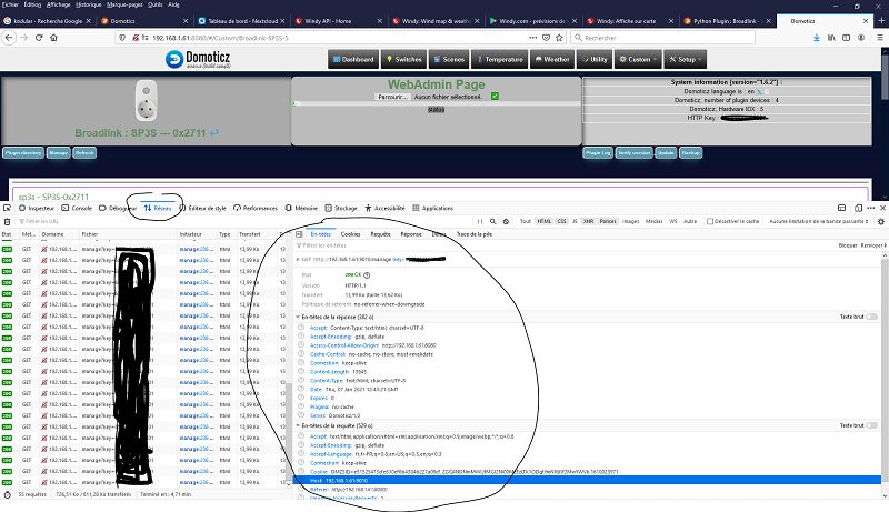

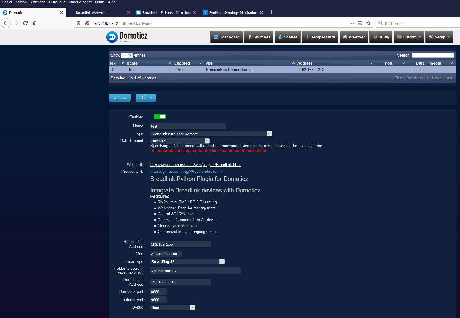

another problem with current version and installation of domoticz into docker container.
I have the following setup of network:
NAS (Synology) with main address 192.168.1.216
container with bridge network, address of inside-container interface is 172.17.0.2
I have mapping of the following TCP ports from container to NAS local ports: 6144, 1443, 8080 and 9000.
my first attempt to configure of plugin was to setup its address and web admin (in web interface of dotomicz device) as 192.168.1.216:9000, and during start of Domoticz it fail check that port is in use (250 line in python.py). It always return for this (only this) port that it is in use in function is_open(192.168.1.216,9000)?
I try to make address and web admin as 192.168.1.216:9001 and map internal port 9000 to local 9001 in container setup. it fail in check around 939 line saying that 192.168.1.216:9000 != 192.168.1.216:9001
ok, next attempt- in plugin config I setup address of Domoticz as 172.17.0.2 and port as 9000
now it pass checks, but always say in the same line 939 that 172.17.0.2:9000 != 192.168.1.216:9000
and throw error "Not implemented"...
I am stuck...
I restore config (192.168.1.216:9000), container port mapping 9000/tcp -> 0.0.0.0:9000 and disable correctness check in plugin (call of is_open() in the place above). does not work, no admin web interface on 9000 port (no response, seems that no-one listen for 9000 port )
output of log (add translation for simplicity)

torM6 wrote: Thursday 07 January 2021 12:53 another problem with current version and installation of domoticz into docker container.
I am stuck...
You fall in security check....
Do not use docker but could try to see possible workaround.
Put your browser in devloper mode and provide a screen shot with network details when error occurs
e.g.:

zak45 wrote: Thursday 07 January 2021 13:56 You fall in security check....
e.g.:
with what address in config of plugin? 192.168.1.216 (NAS external address) or internal address of container 172.17.0.2?

@torM6
tested in docker env and have it working.
made few modifications to avoid errors.
My test env:
docker in synology 6.2
docker image used : linuxserver-domoticz
domoticz plugin settings:
you need the new plugin.py and Dombroadlink.py
torM6
