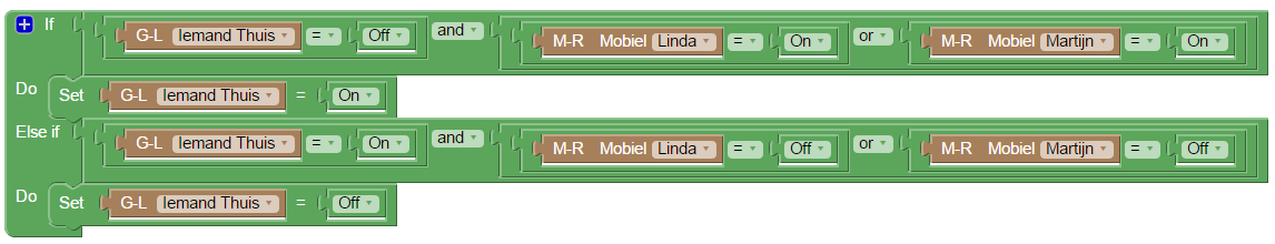

I have no idea how you set up your blocky... it looks like you start with and, but shouldn't there be something on the left of the and?StanHD wrote:This one works for sure:-

It works as it reads line by line:-
If any 1 of the conditions is true ("or" block) and another condition is true ("and" block) then do something.
Else if all of the conditions is true ("and" block) then do something else.
I hope that doesn't confuse things, but as above, just read across line by line.

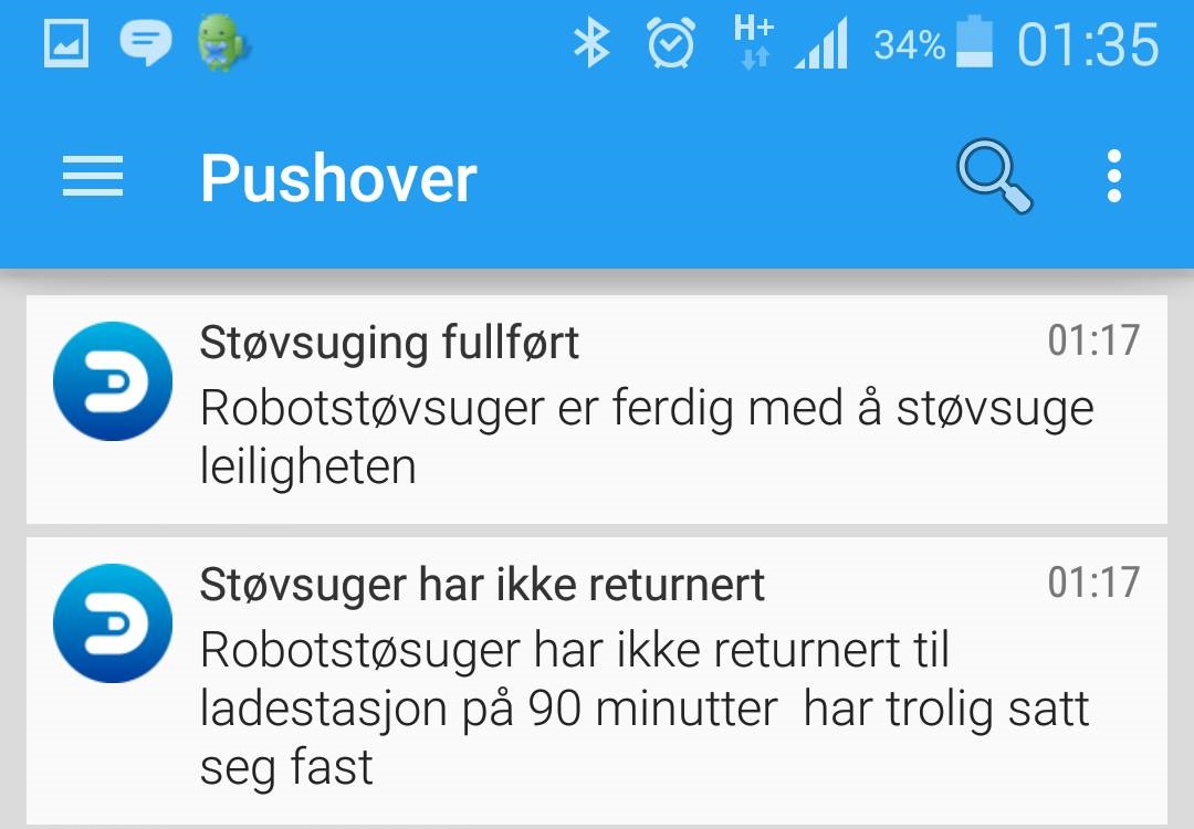

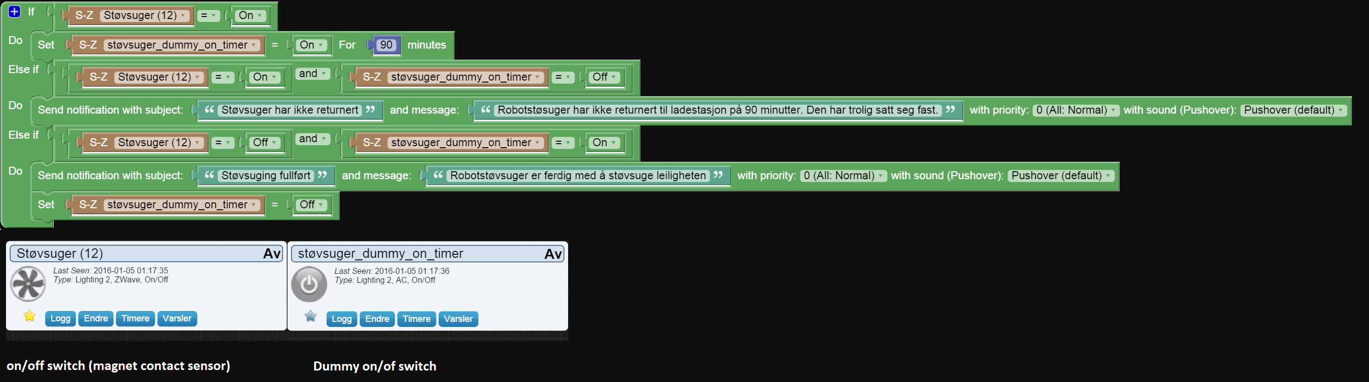

This blockly send me a notification when robot vacuum cleaner is finished.
If the vacuum cleaner is not back on docking in 90 min it sed a notification because it probably jammed EDIT: Still som bugs in this, trying to fix

Hello everybody,
Maybe someone can help me out with this small issue. These are my blocks:
This works but when one phone is off and one phone is on the switch Iemand Thuis (Someone Home) is switching every second from on to off. When the second phone is coming online the switch keeps on like ik should. Why, when one phone is off, the switch is switching from on to off?
