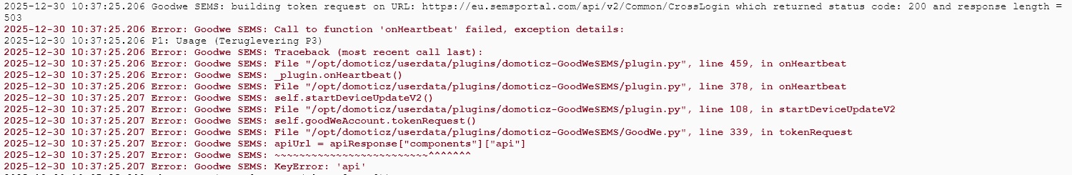

hello folks
I'm trying to setup the plugin to monitor my newly installed GoodWe inverter, but I'm getting the same error message right after posting data into the plugin's configuration:
2024-04-05 14:57:47,288 - INFO - plugin.py - starting plugin version 4.0.1
2024-04-05 14:57:47,288 - INFO - plugin.py - Starting version: 4.0.1
2024-04-05 14:57:47,288 - DEBUG - plugin.py - checking versions: current '4.0.1', config '4.0.1'
2024-04-05 14:57:47,289 - DEBUG - plugin.py - startDeviceUpdate, token availability: 'False'
2024-04-05 14:57:47,289 - DEBUG - GoodWe.py - build tokenRequest with UN: '[email protected]', pwd: 'xxx'
2024-04-05 14:57:47,289 - DEBUG - GoodWe.py - build apiRequestHeaders with token: '{"client": "web", "version": "v3.1", "language": "en-GB"}'
2024-04-05 14:57:47,290 - ERROR - GoodWe.py - TokenRequestException: Failed to parse: https://www.semsportal.com/api/v2/Common/CrossLogin
The activated debug option doesn't help here since no extra data is available.
Can you please help and push me in the right direction when troubleshooting?

Do you have strange characters in your email or password? As that sometimes get parsed wrongly... (not knowing if this really is the case).

This could be the case indeed with special characters in the password. Can you give it a try with only alphanumeric characters in your password?

yep, I've just changed the password to letters-and-numbers only (it was the case before, but it's more simplified now) and the error message is the same

Hey,
When looking at the first error you will see that changing the loglevel did indeed create additional loglines marked DEBUG which do help to find out where the exception is created (as this error is created in more than 1 place).
Now I did a couple of tests with entering an incorrect password which contained some special characters like !@%& and this was no issue: it correctly reported that I entered a wrong pwd.
Now I did see some (old.....) remarks on stackoverflow about requests lib and its base urllib3 being incompatible, so need some more info:
- what OS + version are you on?
- which python version? is shown in Domoticz log at startup or in the 'about' screen
- which version of requests?
- which version of urllib3?
I'm running python 3.9.2, requests 2.31.0 and urllib3 1.26.5

Hey, this is my setupJanJaap wrote: Monday 08 April 2024 22:42 Hey,
Debian 11.9
python3.9/oldstable,now 3.9.2-1 amd64 [installed,automatic]
python3-requests/oldstable,now 2.25.1+dfsg-2 all [installed,automatic]
python3-urllib3/oldstable,now 1.26.5-1~exp1 all [installed,automatic]
I see that the difference is only in the requests version (2.25.1 vs 2.31.0).
So after upgrading to Debian 12 - the issue has been resolved and the plugin works now.
Thanks for the hint!

Any body else connection errors with the plugin?
I get errors from Goodwe.py in TokenRequest with incorrect API call. It seems not to be able to login anymore. It worked fine earlier this week.
The SEMS app is working normally so from my network I can access SEMS.
If nobody has this issue I have to look at my own domoticz plugin installation.....

Yes, see above link. I have the same problem.waltervl wrote: Thursday 11 December 2025 10:52 Any body else connection errors with the plugin?

Ah, thanks, I missed that one when I looked yesterday evening. Solutions seems to be on its way.hbennis wrote: Thursday 11 December 2025 12:29 https://github.com/JanJaapKo/domoticz-G ... /issues/30

Problem solved
