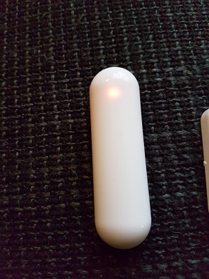

Hi, my sensor came in today. Tried to learn it AUTOMATIC, but no succes. (clone of a Kerui D026, but also a KR-D026)
Sensor lights when door is closed, opens or the switch on the back goes to 'unmounted' (protection if someone removes the switch)

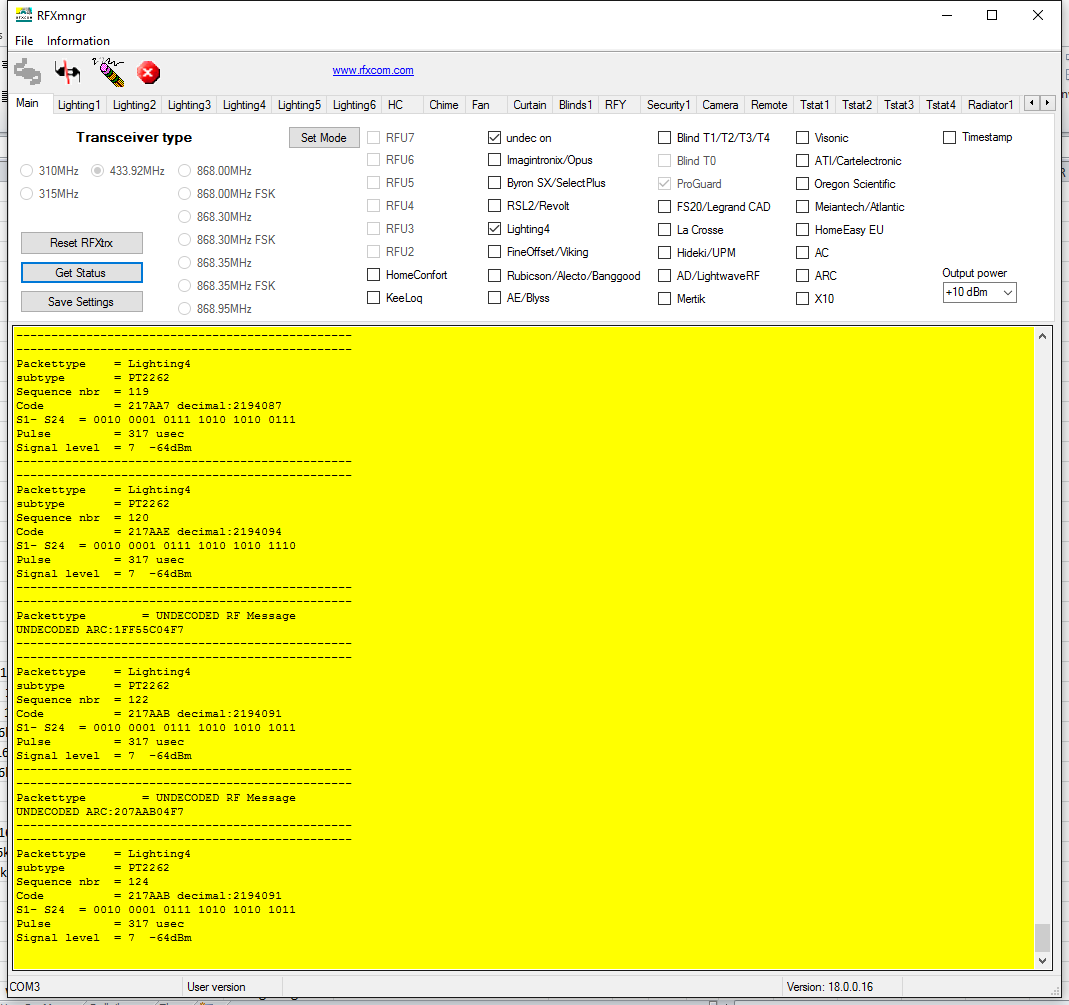

In RFXmngr with Undec ON and only Lighting 4 ON, I get these messages:
How should I install this sensor? I already installed version 1012 on my RFXcom433E.

Already got it to work in Domoticz. Was maybe a problem with too may protocols on. Turned almost every protocol off and now it works...
Now finding out what the statusses are for programming the switch in LUA

Problem with the Kerui sensors is: the look the same, but they have different protocols.
Also if you have Rubicson enabled, the most sensors won't respond.
They are working on a fix (new firmware), but it's not perfect yet.
