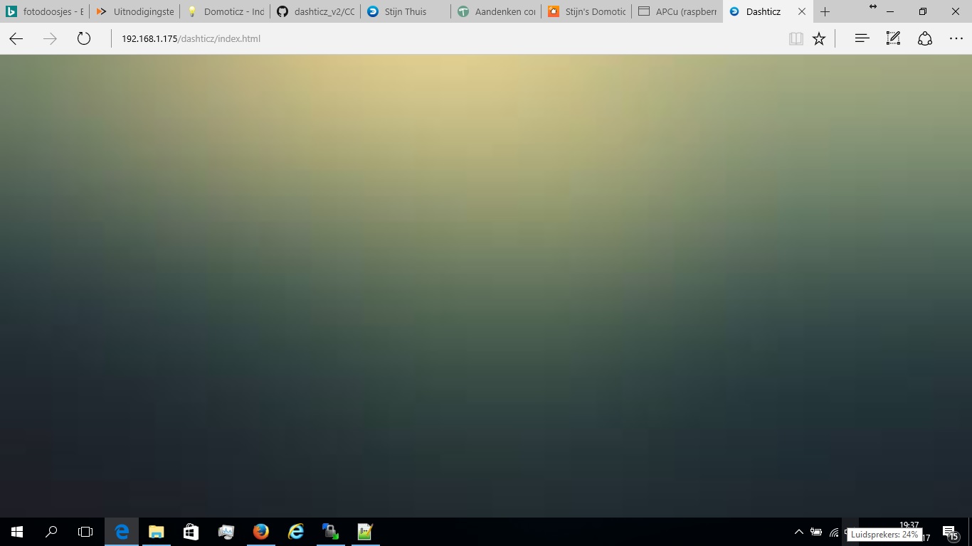

On my dashboard I am not able to get the 'traffic map' to work. So far, I only get a grey rectangle on the dashboard
I have entered the necessary Maps variables:
var _APIKEY_MAPS                        = 'AIzaxxxxGAHRNxxxxmEOOxxxxxxxxacH-8rxxxxx;
var _MAPS_LATITUDE                      = '51.xxxxxx';
var _MAPS_LONGITUDE                     = '4.xxxx0';
var _MAPS_ZOOMLEVEL                     = '10';
xxx
columns[4] = {}
columns[4]['blocks'] = ['trafficmap','traffic','train',publictransport.ovinfo]
columns[4]['width'] = 5;
screens[2] = {}
screens[2]['background'] = 'bg4.jpg';
screens[2]['columns'] = [4,5]
Is this error caused by an incorrect API code? On the Dev page of Google I found multiple 'Maps' API-keys. The Wiki is not clear which one to take. An example, also the format for the lattitude and longitude would be helpful in the Wiki.

i downloaded this nice looking Dashticz and configured this to my ip: var _HOST_DOMOTICZ = 'http://192.168.1.175:8080';
and when i want to go the the dashticz site, it is just blank, no button or something shows up
What am i doing wrong lol? :D

htilburgs
Posts: 464
Post by htilburgs »
Can you post your config.js without the personal keys / information?
