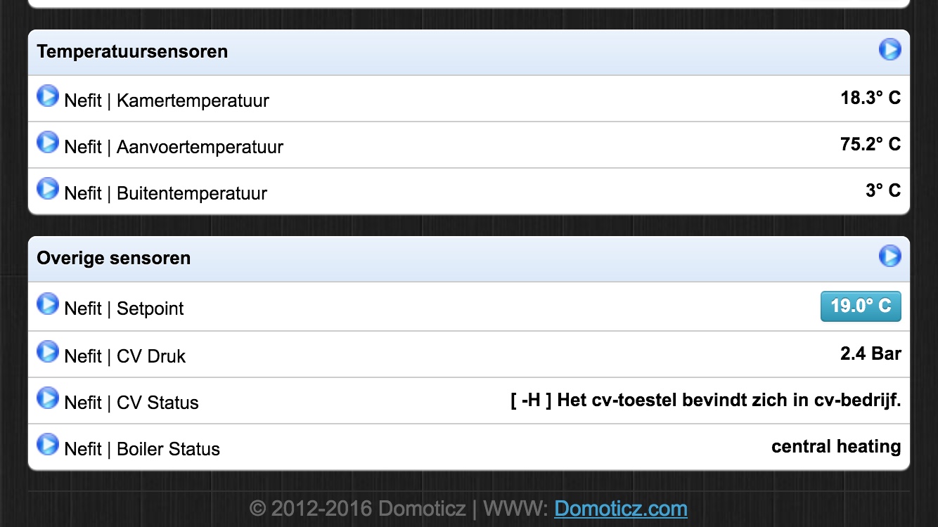

Found it, and it's working! Thnx!
Small question;
The status of the boiler is in English and the central heating status is Dutch.
Can we change both to the same language?

Small question;
Right now i use the output from the Nefit Easy library (https://github.com/robertklep/nefit-easy-commands) so it cannot be changed easily.
I will put it on the wishlist :)
