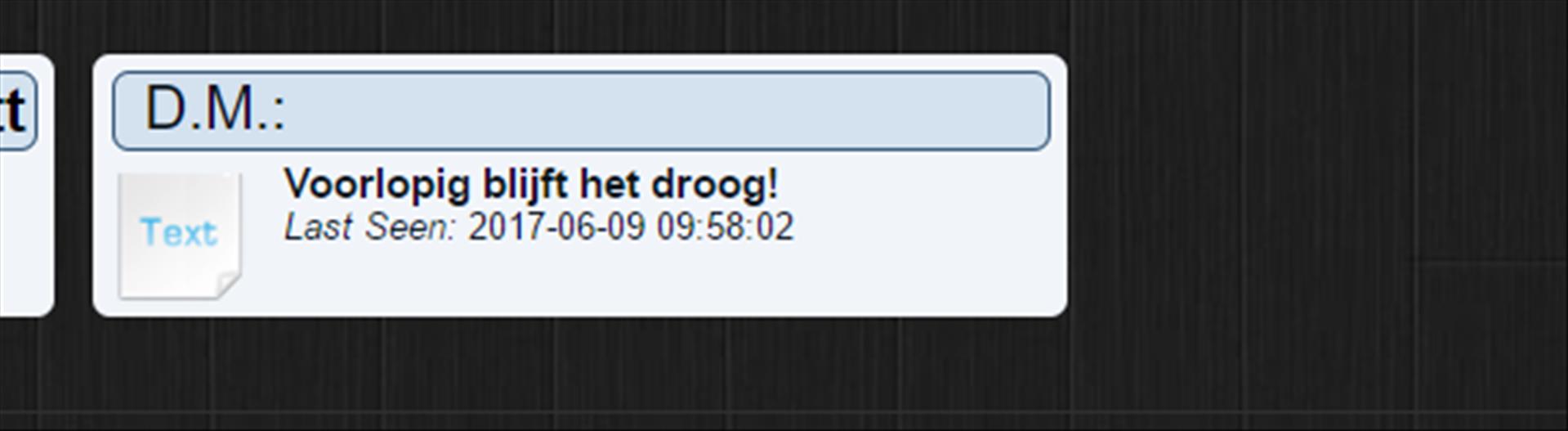

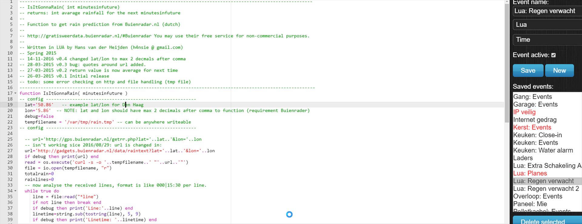

Dear all. I use the sript from the wiki. [ is this the latest version ? ]
Use the build in Lua script in blockley..
Works fine.
Only 1 thing the script is running every second:
2017-06-07 18:48:10	Voorlopig blijft het droog!
2017-06-07 18:48:09	Voorlopig blijft het droog!
2017-06-07 18:48:08	Voorlopig blijft het droog!
2017-06-07 18:48:07	Voorlopig blijft het droog!
2017-06-07 18:48:06	Voorlopig blijft het droog!
2017-06-07 18:48:05	Voorlopig blijft het droog!
2017-06-07 18:48:03	Voorlopig blijft het droog!
2017-06-07 18:48:02	Voorlopig blijft het droog!
2017-06-07 18:48:01	Voorlopig blijft het droog!
2017-06-07 18:47:58	Voorlopig blijft het droog!
2017-06-07 18:47:57	Voorlopig blijft het droog!
2017-06-07 18:47:56	Voorlopig blijft het droog!
Or more..
Is there a solution for..
Looks not the best option for my Domoticz system..
Is there perhaps a sleep @ the end possible?

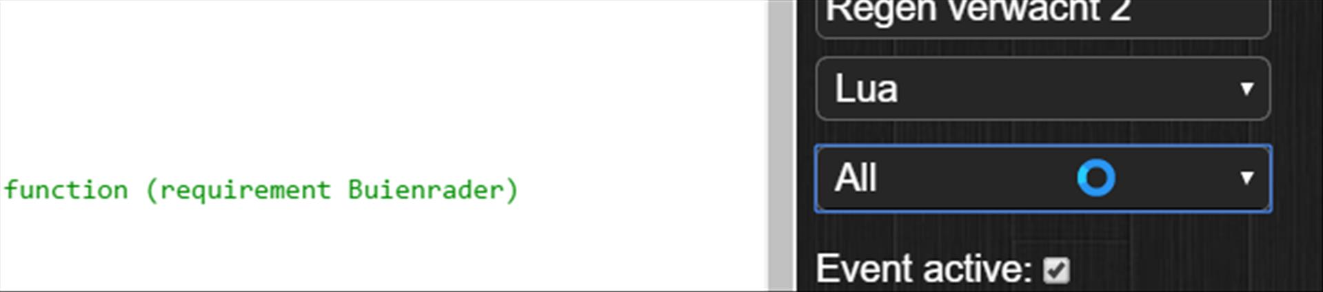

So you used the build in editor and probably have selected to act on each event instead of just time events ( every minute)?
It is the dropdown box underneath the Lua selection box.
Jos

Did u use lua as time or device?
Derik
Posts: 1605
Re: Is it gonna rain within the next X minutes?
Post by Derik »
i use all:
I do not understand the different s between all this option...
Perhaps someone can ex plane the dombo here :-)
Only the inline lua option looks great because Domoticz save this in the Db, easy for my daily backup
edit:
And what settings do i need for the other script?
jvdz
Posts: 2486
Domoticz version: 4.107
Post by jvdz »
Pretty strait forward:
All simply means the script will run on each event.( all below)
Device will be triggered when an Device is updated
Time events will run each minute on the minute
Variable event is triggered when a variable is change.
So, did you change it to Time?
Jos
Derik
Posts: 1605
Post by Derik »
Sorry for my not smart question only scripts is not my thing i believe..
changed to time
Works every minute..
Thanks guys!!!

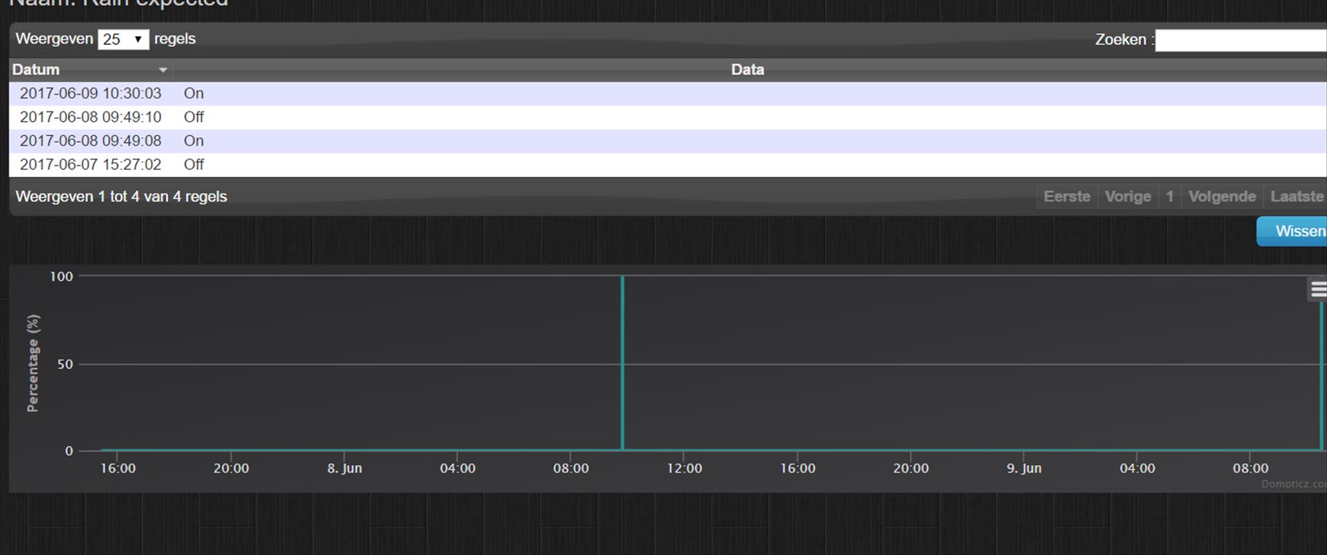

mmmm 1 script working ok.The text is changing...
Only the other script the dummy switch is not changing..
Did change the decimals...
set it to time
Raining here: als bakken uit de lucht
Only no switch that says Rain expacted
Then i hope the data is correct:
Now it is raining like ...
Ho do i read the data.
What are the time's where the script is talking about?
It is gonna rain for how long is this warning?

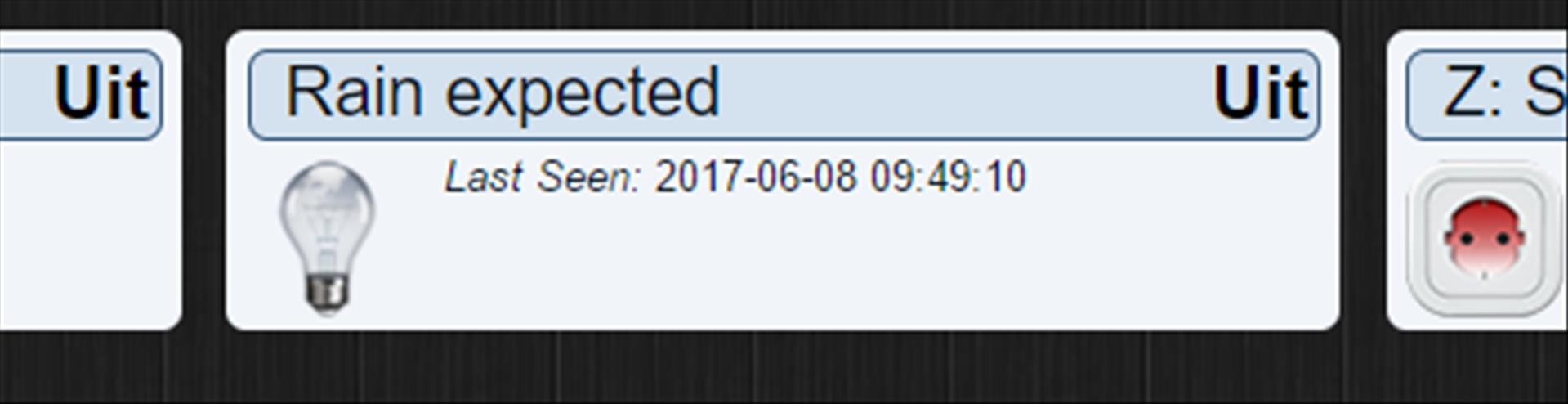

mmm
Now there is a switch:
Very late...
But there he switched on...
Is there some setting that he can switch faster?

lat='5?.??'
lon='4.??'
-- use information for the next xx minutes
minutesinfuture=15
-- Domoticz server url
domoticzurl="http://192.168.0.??:8080"
-- rain device
DEVIDX=???
-- General Percentage device
PDEVIDX=???
-- set to true or false
debug=true
-- set to the appropriate tmp path
tempfilename = '/var/tmp/rain.tmp' -- can be anywhere writeable
-- config ---------------------------------------------------------
-- http://gadgets.buienradar.nl/data/raintext?lat=5?.??&lon=4.??
-- url='http://gps.buienradar.nl/getrr.php?lat='..lat..'&lon='..lon  -- old link
url='http://gadgets.buienradar.nl/data/raintext?lat='..lat..'&lon='..lon
if debug then print(url) end
read = os.execute('curl -Lo '..tempfilename..' "'..url..'"')
file = io.open(tempfilename, "r")
totalrain=0
rainlines=0
-- now analyse the received lines, format is like 000|15:30 per line.
while true do
	line = file:read("*line")
	if not line then break end
	linetime=string.sub(tostring(line), 5, 9)
	-- Linetime2 holds the full date calculated from the time on a line
	linetime2 = os.time{year=os.date('%Y'), month=os.date('%m'), day=os.date('%d'), hour=string.sub(linetime,1,2), min=string.sub(linetime,4,5), sec=os.date('%S')}
	difference = os.difftime (linetime2,os.time())
	-- When a line entry has a time in the future AND is in the given range, then totalize the rainfall
	if ((difference >= 20) and (difference<=minutesinfuture*60)) then
		rain=tonumber(string.sub(tostring(line), 0, 3))
		totalrain = totalrain+rain
		rainlines=rainlines+1
		if debug then print('Rain in timerange: '..rain .. '   Total rain now: '..totalrain .. '   difference:' .. difference .. '    Line:' ..line ) end
file:close()
-- Returned value is average rain fall for next time
-- 0 is no rain, 255 is very heavy rain
-- When needed, mm/h is calculated by 10^((value -109)/32) (example: 77 = 0.1 mm/hour)
if rainlines == 0 then
	averagerain=0
	averagerain=math.ceil(totalrain/rainlines)
function round(num, idp)
  return tonumber(string.format("%." .. (idp or 0) .. "f", num))
-- Calculate the mm/h
calcmmh = round(10^((averagerain -109)/32),2)
if debug then print(os.date() .. "  averagerain:" .. averagerain .. "  calcmmh:" .. calcmmh) end
-- Update Domotics Devices
url=domoticzurl..'/json.htm?type=command&param=udevice&idx=' .. DEVIDX .. '&nvalue=0&svalue=' .. calcmmh .. ';' .. calcmmh
read = os.execute('curl -s "'..url..'"')
if debug then print(read) end
-- Update percentage regenkans Domotics Device ---------------
result = round(averagerain*0.392156862745098,2)
url=domoticzurl..'/json.htm?type=command&param=udevice&idx=' .. PDEVIDX .. '&nvalue=0&svalue=' .. result
if debug then print('==> Rain chance: '..result .. '%') end
-- end update percentage device -------------------------------------
if debug then print('------------------------------------------------------------------------------------------------------------------------------------------') end
