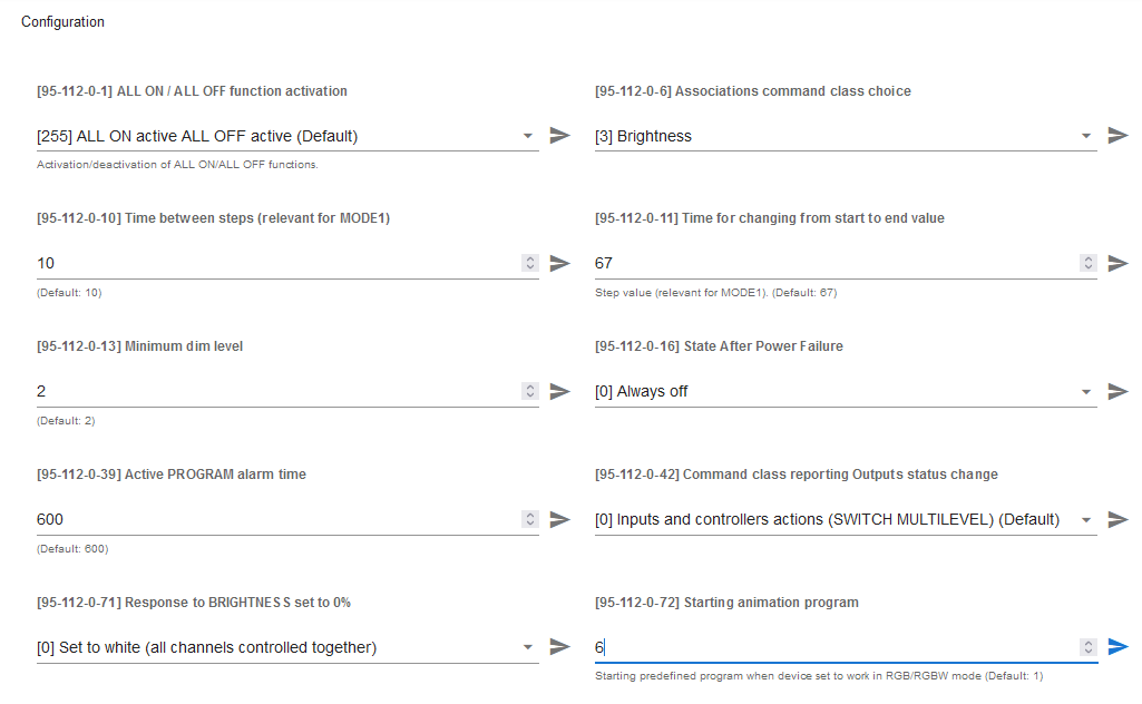

As the mqtt autodiscovery is ongoing, I think that a point is still not working for my devices: Animation for RGBW Controller (Fibaro).
To get these animation you could set 6,7,8,9 or 10 in the 72 configuration field [95-112-0-72]
Screenshot 2021-11-08 204442.png (22.42 KiB) Viewed 3257 times
Screenshot 2021-11-08 204517.png (36.23 KiB) Viewed 3257 times

hestia wrote: Monday 08 November 2021 20:52 As the mqtt autodiscovery is ongoing, I think that a point is still not working for my devices: Animation for RGBW Controller (Fibaro).
I've found how to do it with the help of the zwavejs2mqtt git discussions
Here is a script with the mqtt message

    local LOG_LEVEL = dz.LOG_DEBUG
    dz.log("LED_SELECTOR " .. device.state .. " " .. tostring(device.level) .. " nValue: " .. device.nValue, LOG_LEVEL)
-----< BEG FUNCTIONS > ----------------------------------------------------------------------------------------
    local function logWrite(str, level)  -- Support function for shorthand debug log statements
        if level == nil then
            level = LOG_LEVEL
        dz.log(tostring(str), level)
	local function setZwavejs(p_NODE_commandClass, p_NODE_endpoint, p_NODE_property, p_NODE_value)
        local suffix = "set"
        local mqttTopic = mqtt_prefix .. '/' .. NODE_nodeId .. '/' .. p_NODE_commandClass .. '/' .. p_NODE_endpoint .. '/' .. p_NODE_property .. '/' .. suffix
        local mosquitto_cmd = 'mosquitto_pub' ..' -t '.. mqttTopic .. ' -m '.. p_NODE_value
        os.execute (mosquitto_cmd)
        logWrite("mosquitto_cmd=" .. mosquitto_cmd)
	local function RGBWAnimation(p_rgbAnimation)
	    dz.log("RGBWAnimation " .. p_rgbAnimation, LOG_LEVEL)
        local NODE_commandClass = 112
        local NODE_endpoint = 0
        local NODE_property = 72
        local NODE_value = p_rgbAnimation
        setZwavejs(NODE_commandClass, NODE_endpoint, NODE_property, NODE_value)
	local function RGBWColor (p_red, p_green, p_blue, p_warmWhite)
	    dz.log("RGBWColor " .. p_red .. '  '.. p_green .. '  '.. p_blue .. ' ' .. p_warmWhite, LOG_LEVEL)
        local NODE_commandClass = 51
        local NODE_property = 'targetColor'
        local NODE_value = '{\\"value\\":{\\"warmWhite\\":' .. p_warmWhite .. ',\\"red\\":' .. p_red .. ',\\"green\\":' .. p_green .. ',\\"blue\\":' .. p_blue .. '}}'
-----< END FUNCTIONS > ----------------------------------------------------------------------------------------
	logWrite(device.id .. ' ' .. device.level)
    local devLevel = device.level
    if  device.level == 0 or device.nValue == 0 then
        device.switchSelector(0).silent()
	    device.switchOff().silent()
	    devLevel = 0
	if  devLevel ~= 170 then
	    NODE_nodeId = NODES_nodeId[device.id]
	    logWrite('NODE_nodeId: ' .. NODE_nodeId)
     	local paramArray = RGBW_ORDER[devLevel]
    	if paramArray[1] == nil then
    	    logWrite('Level: ' .. devLevel .. ' bad parameters', dz.LOG_ERROR)
    	elseif paramArray[2] == nil then -- animation
    	    RGBWAnimation(paramArray[1])
    	    RGBWColor (paramArray[1], paramArray[2], paramArray[3], paramArray[4])
hestia
