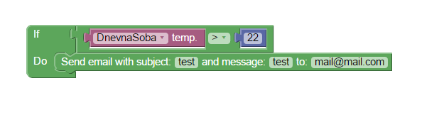

Hi to all,
I try to create simple rule to send notification with blocky, I hope that someone can help me to pint right direction.
Rule will be something like this, if temperature is larger than some value send notification each 5 minutes. I use dummmy/virtual sensor so notification don't work on sensor notification settings. Right now I have this rule but it will send mail each minute. Domoticz is installed on synology.

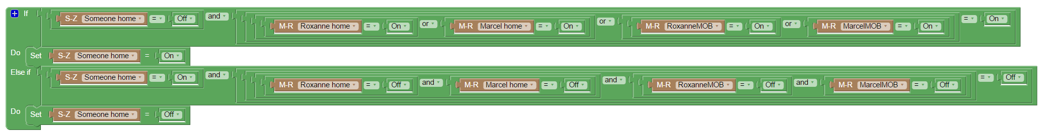

I'm trying to create a Blocky to toggle the dummy switch 'Someone home'.
If one of the 4 switches (2x Geo 2x ping) is on then 'Someone home' must me set on.
If none of the 4 switches is on then 'Someone home' must be set to off.
It's not working :(

by alfred_j_kwak
If none of the switches are one then your AND part is ON not OFF.

by MarcelMAH
alfred_j_kwak wrote:If none of the switches are one then your AND part is ON not OFF.
You mean this one?
Changed it, still no go... it won't turn it on even when everything else is on.
