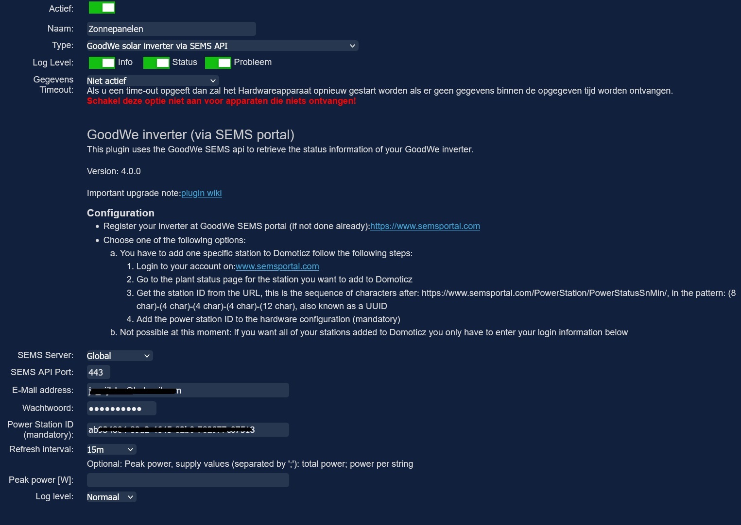

Hallo,
I'am a new user to Domoticz and the whole Pi scene. I managed to put up a pi with Domoticz and Zigbee2MQTT.
Now i'm trying to add my Goodwe 2500-ns to Domoticz. I've installed your plugin and get the following errors;
Domoticz screen.jpg (249.21 KiB) Viewed 2738 times

Thanks for putting time and energy in my problem. (Noob mode activated) Can you tell me how i switch debug mode on? And do the rest you mentioned!
Posts: 6676
Domoticz version: 2025.1
Re: Python Plugin: GoodWe solar inverter via SEMS API
See in your screenshot a few posts back the bottom parameter:
Log Level: Normaal
This can be switched to Debug.
Zeil

Did a git pull., and now under devices i see 18 hardware entries from my Goodwe inverter. At the moment it's dark outside, so no numbers to be seen. Will check again if the sun shows up.
I can find my "Goodwe zonnepanelen.log in my Domoticz directory on my Raspi. Tried to copy the file to my windows pc with SSH/Putty. No success yet.
Is there a way to see the log file through SSH? what's the command for that? And is there a way to give the user on a pi "admin" control?
