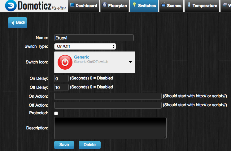

You need to set off delay. I've set it to 10 seconds but you can use what ever suits you.SteGe wrote:I also ordered the Oudi door sensor. But when I add it as a switch it only turn on, and never gets off (also won't turn off when I click it by hand). Should I change it to another type of switch?

- Screen Shot 2016-09-08 at 6.30.45 PM.png (168.12 KiB) Viewed 6278 times

Thx, that's works! Now I'm getting a notification when somebody opens my postbox. Will get a camera in the near future so that I can get a picture when somebody is at the door or opens the letterbox.

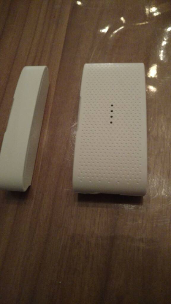

just bought this sensor and can report it's working ok with RFLink and Domoticz. Battery (23A) was included altough not clearly specified. Just ordered another two of these. mounted it in my snail mail box by soldering a wired reed contact so it fitted better and the main unit could be mounted on the inside of the door. Don;t know yet about battery life, but we'll see. Noticed some other sensors in Domotics device list that are probably the same (ev1527 and eurodomest) with some similar codes...

Just received another 433 door contact with ev1527. really Nice casing compared to some other uggly Chinese door sensors. Don't know yet about battery Life ofcourse but we will see. Only reporting on signal as usual with these sensors.
Re: Low cost window/door sensor
I bought several Kerui D026, they are cheap and are looking very nice! Works fine with domoticz + RFX
